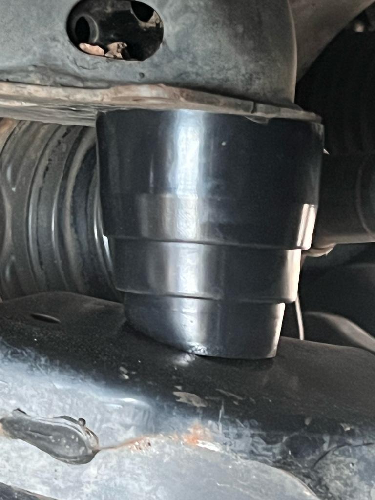

I just put the energy suspension 8.9104g units on my front end. They feel great so far. With my 6112s at 2” in the front and these bumps, I can blast through dips and over speed bumps and it truly soaks it all up. My rear end on the other hand… does not keep up. With stock shocks and bumps.

Update: Just noticed the bump stop is a bit long and folds over itself at initial contact. I may cut the first section off so it makes contact square with the arms.
