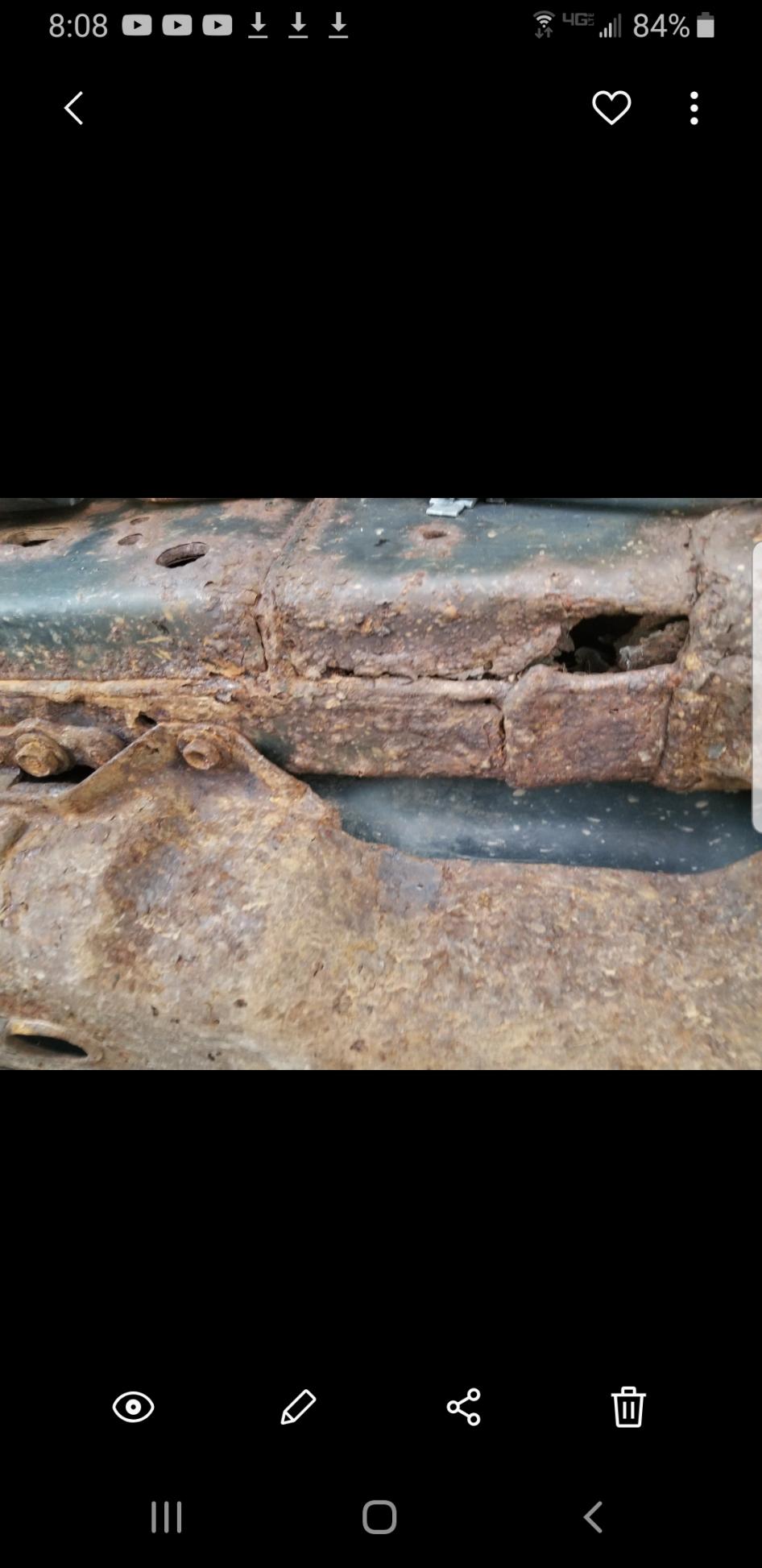

What can I do about this RUST?
I just filed a safety complaint with the NHTSA. My rust is bad in parts.

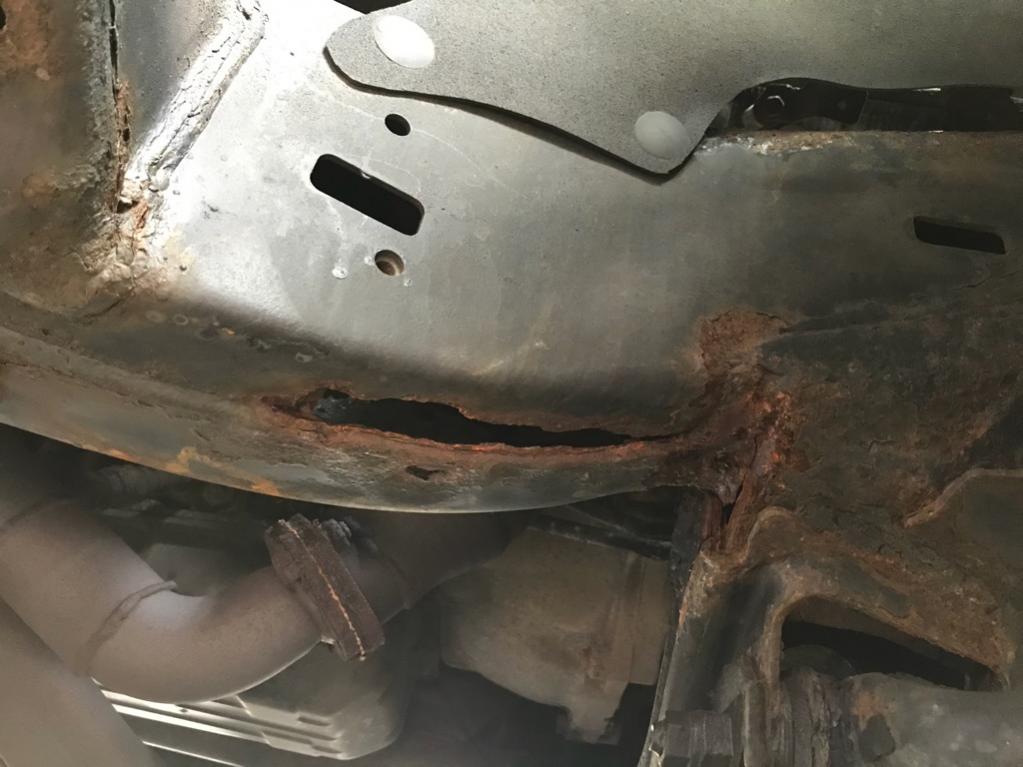

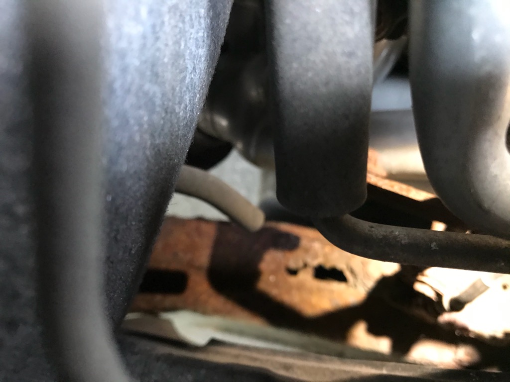

I agree, and once all my welding is done, I will be using an undercoat gun to shoot some heavy oil inside the frame! After seeing a thread about the AC drain dripping on the frame, I checked that today, and found that it rusted a hole through the top where it drips, and rotted out the bottom directly below that! WTF Toyota?!
Here is a a couple pics to show what that stupid drain location caused!

Dang, I moved that AC drain hose a month ago and didn't see any corrosion from it. Odd how these things seem to rust differently car to car. That one looks like a pain to repair.
Yes, for sure! I suspect that drain did all of the same age to the passenger side based off what it did there. Once water and salt gets inside, as you know, there really is nowhere to go other than the lowest points to work their way out.:frusty:
Mine's an 03 and that spot is fine. My front cross piece is also intact but scaly. My rust holes were elsewhere. Hopefully I can stop the madness with oil treatments.
Interesting. Well, at the very least be sure to lengthen and relocate where that hose exits to get it off the frame either way.

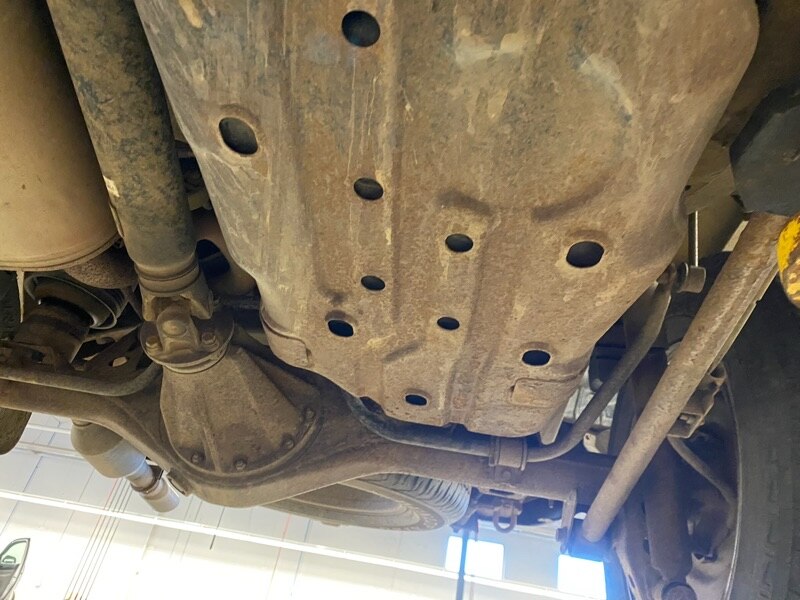

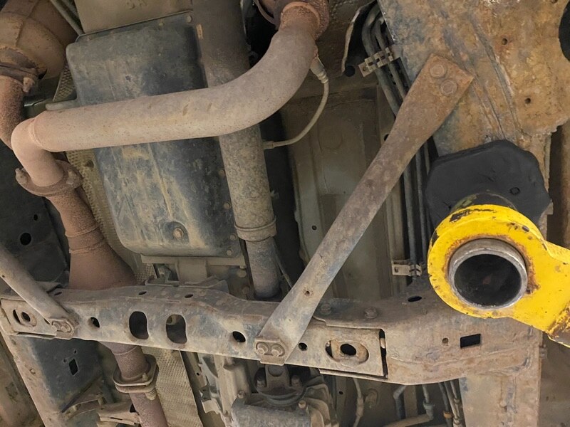

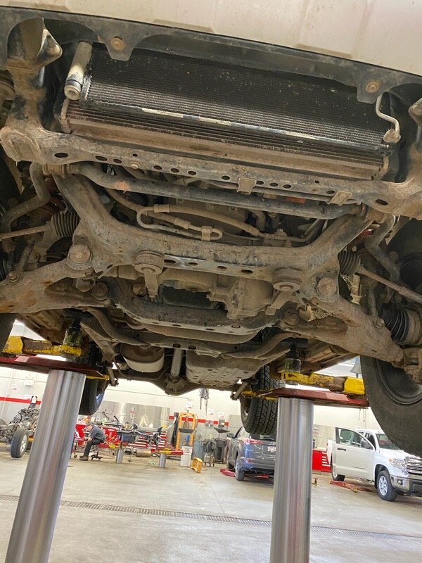

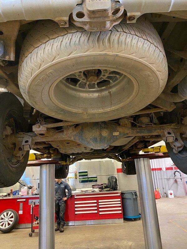

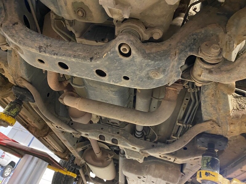

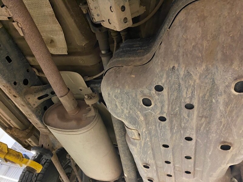

Frame rust - should I buy this 4Runner? 03 Ltd V8
Hi there!
First post...apologies for breaking any rules!
Hoping for some help/advice. Looking at this 03 Limited V8 with 180,000 km, but worried about frame rust. It looks to be surface rust to me, but I haven't seen the vehicle yet so can't say for sure.
Dealer is asking 15k CAD, which is pretty steep but think I can get them down.
What do you guys think? Should I go for it or walk?
Thanks in advance!

I hate to lose my 2005 4runner, but a buddy of mine who welds and rebuilds trucks from top to bottom said it would be very expensive to get my rust taken care of. I needed to replace the rear brake lines and the gas tank strap anyway, which I was going to do, but I don't weld, so I'd have to find someone. This is on the rear drivers side frame near the gas tank and rear wheel.
