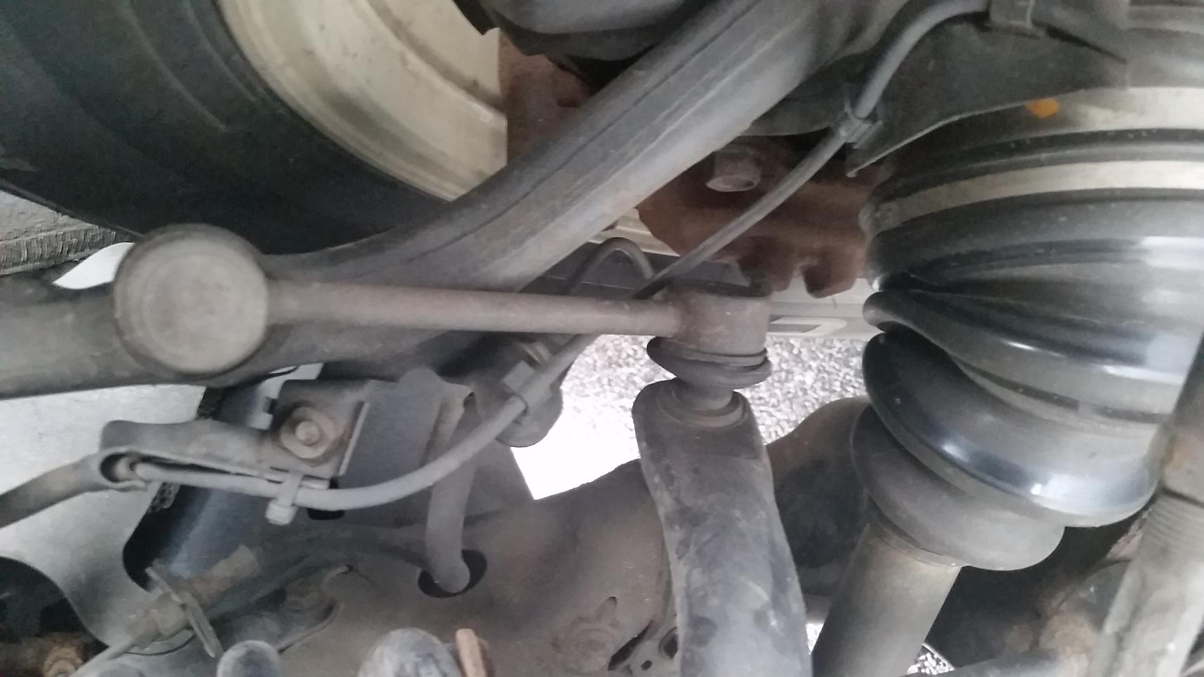

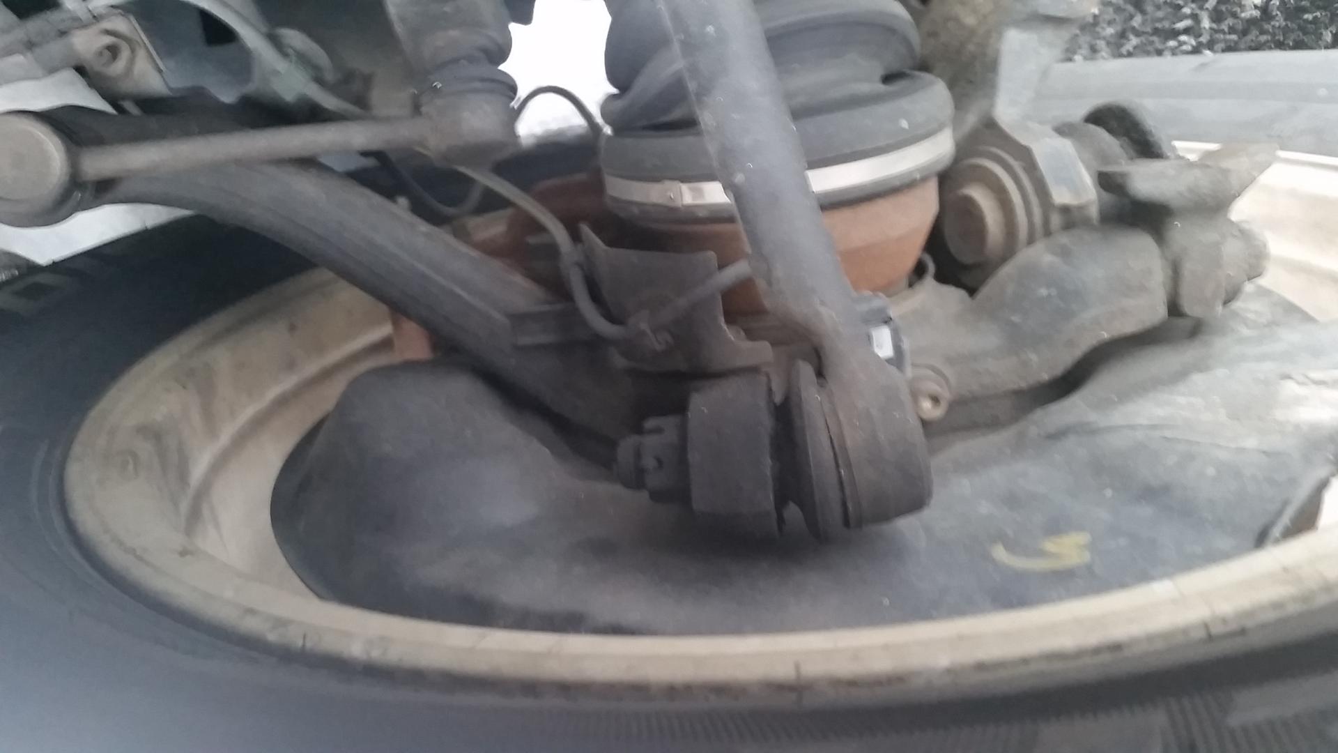

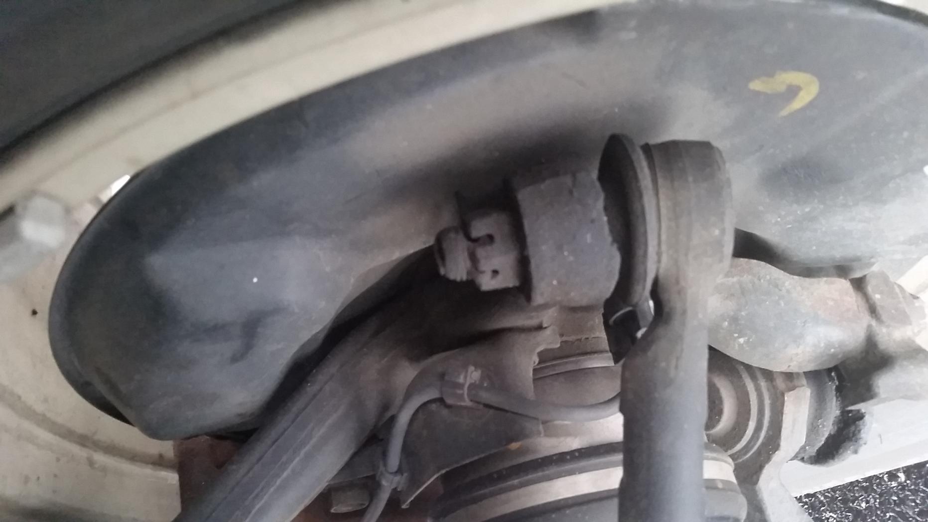

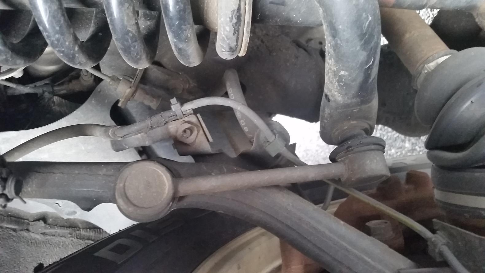

Here are close ups of my end links and tie rod end. Anything concerning?

First off, those pictures are huge, maybe trim them a bit next time. :)
Everything looks good in those pictures to me, a hell of a lot cleaner than my 4Runner's balljoints are. Can you grab the sway bar links and move them up and down, or do they feel pretty solid (they will roll a bit, side to side but I am looking for up & down freeplay)

Ha, sorry about pic size, best I could do posting from my phone. I'll see if I can move them by hand.
I should also add that I do hear a clinking sound coming from front pass side when coming to a stop. And also a clink from rear when going over bumps at low speed. Neither sounds drive shaft related.
