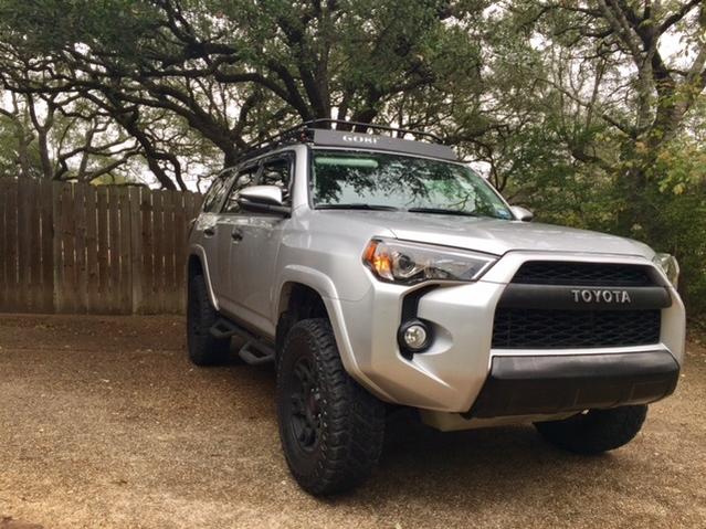

Gobi installed Thursday, ARB 2500 Saturday!

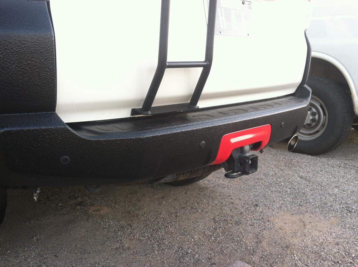

My bump, my bump
Thanks to [MENTION=46106]YOLO[/MENTION] for the masking and Monstaliner* tips around the "body lines" everything lined up and fit perfect.
Thanks to [MENTION=65614]Antman[/MENTION] for the sensor placement and oreintation, I got the sensor holes super tight and used a jewelers file to make the no spin knotch and then siliconed(aluminum flavor) around the back side so they would stay put.
Monstaliner* seems to be a great product, but I could have done 2 or 3 bumpers with the gallon I bought, and if your lookin to party..... Apply this stuff indoors with some friends, it's odor is VERY STRONG!!
I like the new body lines and look(14' bumper on a 10') now I can turn the exhaust out the side with more clearance than the early gen kaboose!
*pronounced in Aussie accent for S&G

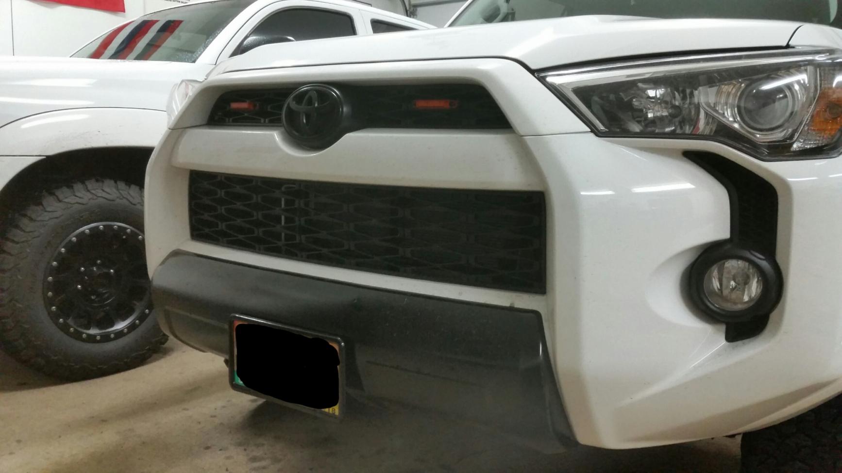

Didn't want to put screws in my new lower valence for the license plate so I made some brackets to mount my plate a little lower.

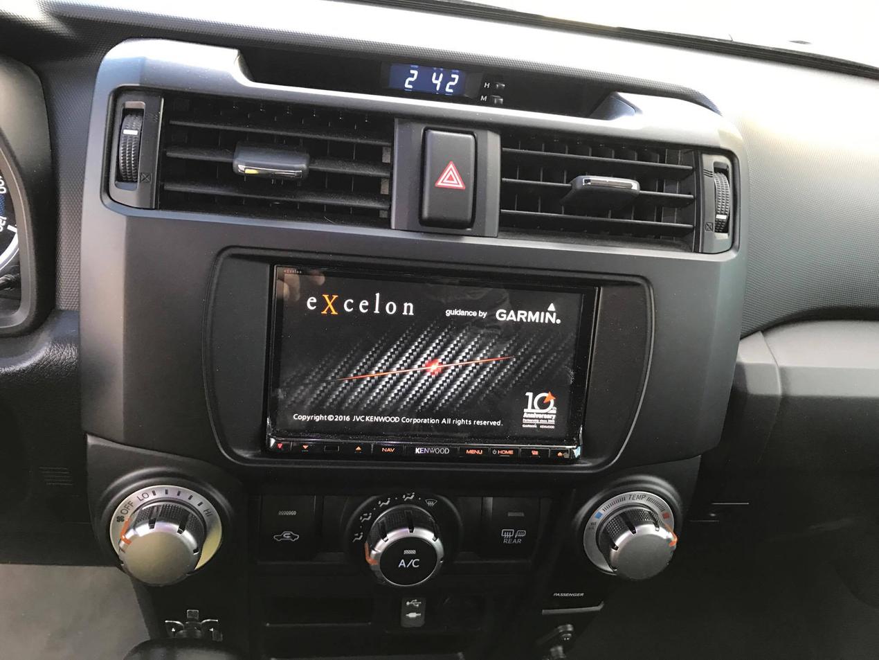

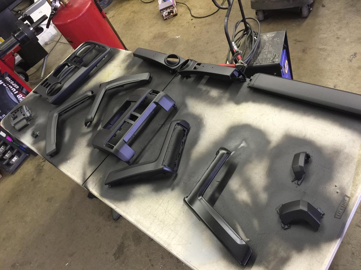

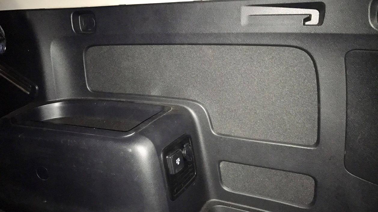

upgraded the audio system

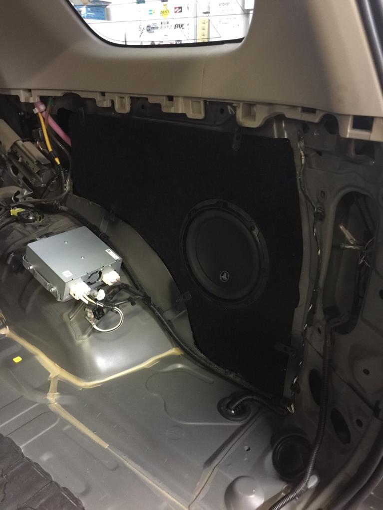

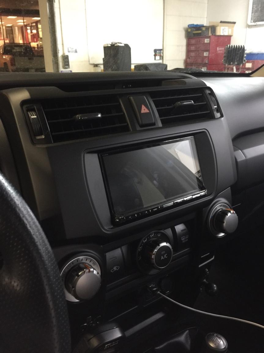

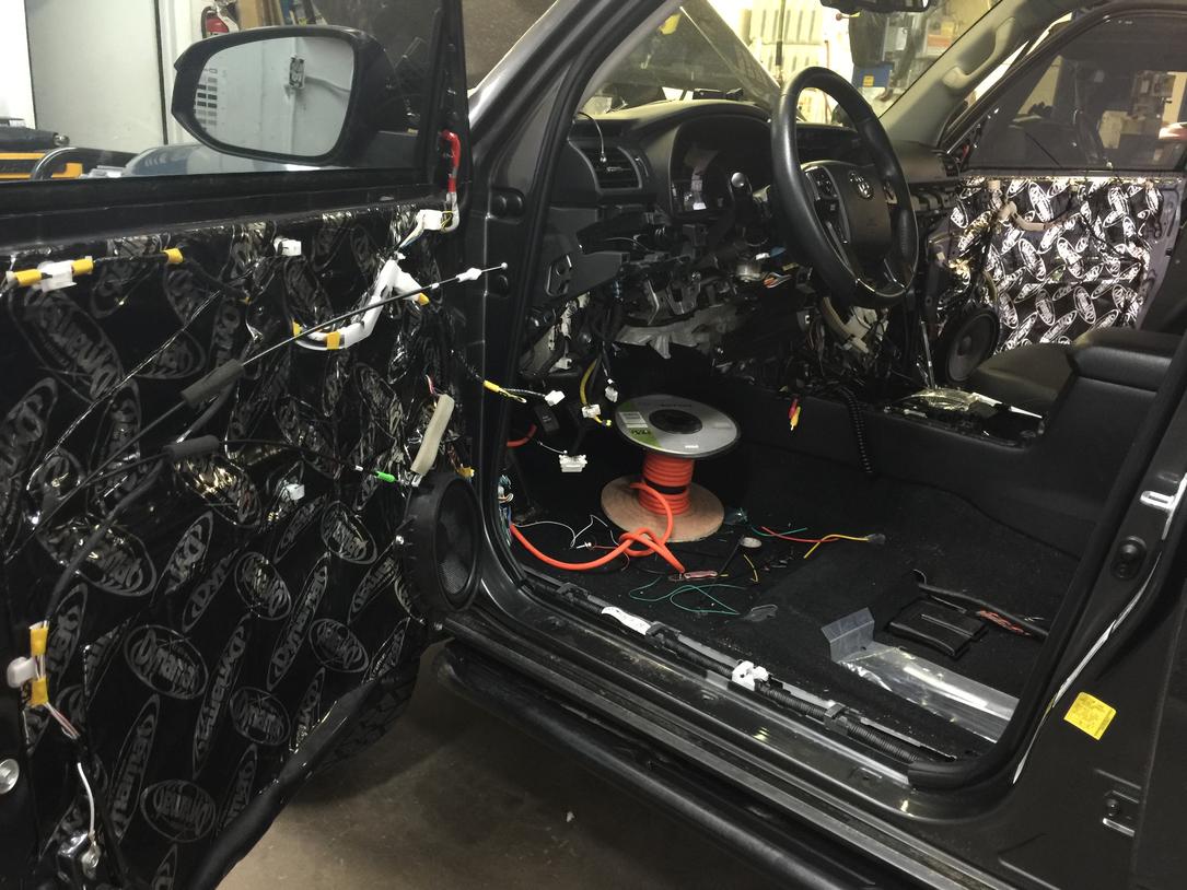

Finished up a new audio system with custom sub box and painted trim pieces. Details in my build thread.
Nice! I've got the same Scosche install kit and have been figuring out what to do to make it fit the TEP metal flake black. I was going to take it to a body shop to see if they could match it but the matte black looks good.
