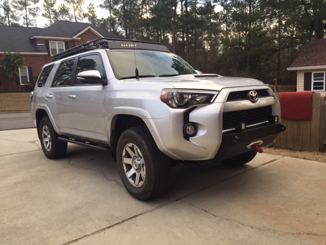

Bilstein 5100 Installed. 1.75" with 1" corn fed spacer in the rear.
Also completed the h11 to h9 mod and levelled the headlights.

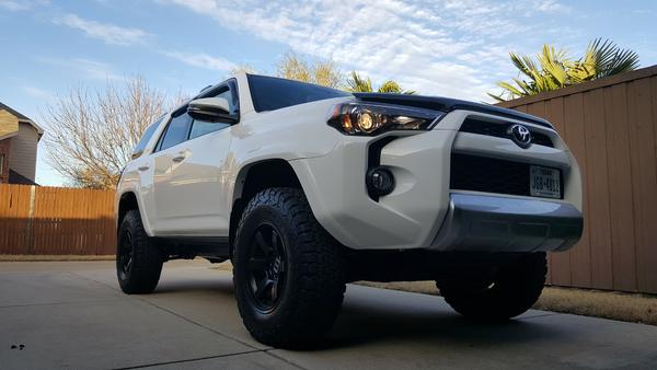

Bilstein Install
Had Bilstein 6112's installed up front (1.85") and Bilstein 5100's in the rear with 1" cornfed spacers.
Pic looks like it has negative rake, but it doesn't -- my driveway slants up :)
I know a lot of people don't like measuring ground to fender, but it's what most people go by : rear sits at 38.5", front at 37.25"
alignment: all within specs

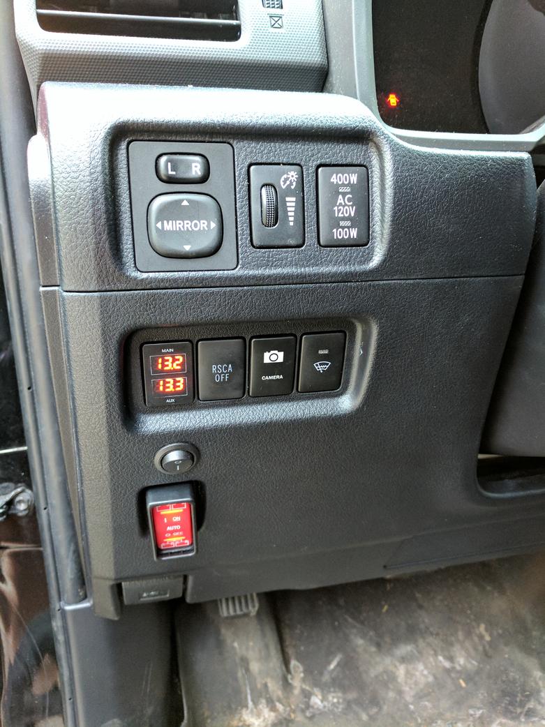

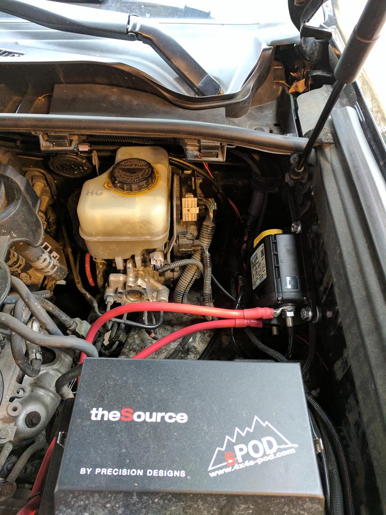

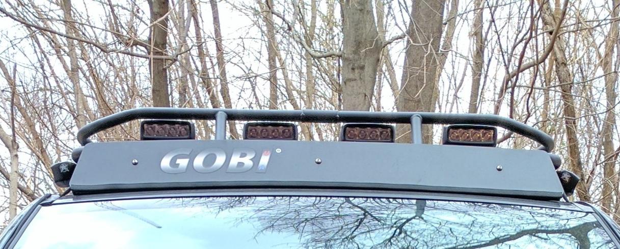

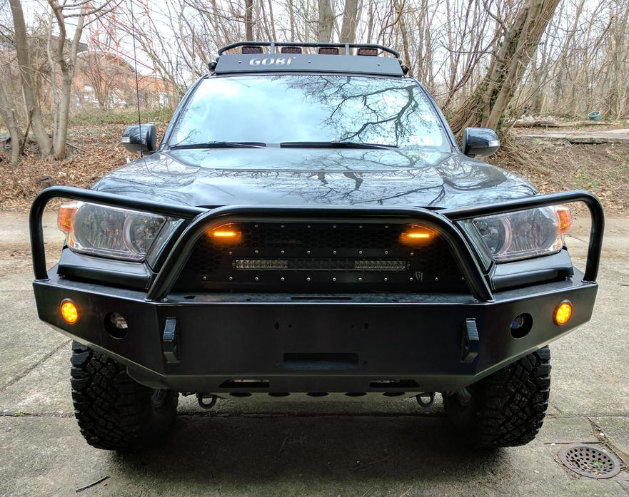

Installed the Grand General amber grille lights today. Very easy. Used 9006 splitters and connectors to branch off from the bumper turn signals and resistor to minimize messy wiring and time spent outside (just above freezing today).
Also showing off the location of my Blue Sea ML-ACR on the driver side and Optima YellowTop D34/78 as it sits on the Shrockworks dual battery tray on the passenger side.
On the front sides of the roof rack, I now have SR-Q2 diffused lights, and inside the truck is the switch for the Blue Sea ML-ACR as well as an awesome Dual Battery Voltmeter I imported from Australia (by SolidKit).
Awesome voltmeter- I've been looking for something like that for years!
