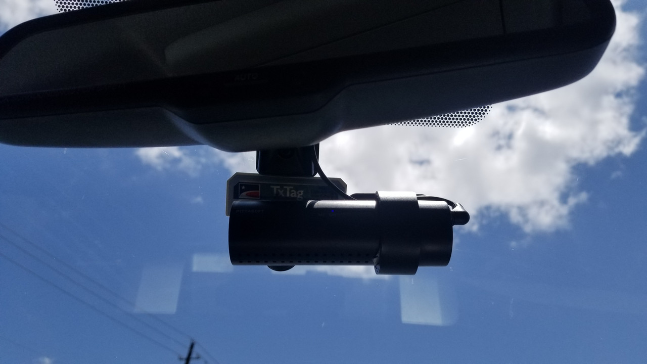

Well after many close calls, last week was the deal sealer and I invested in a dash cam. Black Vue front and rear. The deal sealer was a lady who cut me off and when I honked at her she brake checked me 2-3 times. I went around her and admite I hit mine e brakes on her as well(not using good judgment). She flow and took pictures of me and I did of her as well. When i got home I called 311 to make a report they transferred me to 911 told them what had happened. Next thing I know cops are at my house they asked "you know why where here?" I said I called you, they told me no. The lady that had cut me off called 911 and said I pulled a GUN on her!! No I know dash cam won't show me inside the car but she said she didn't know why I had honked at her to begin with.

Do you like all the features of the Black Vue? I'm considering a 2-channel cam as well. How difficult was the install?
