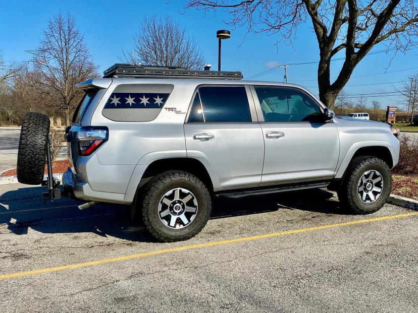

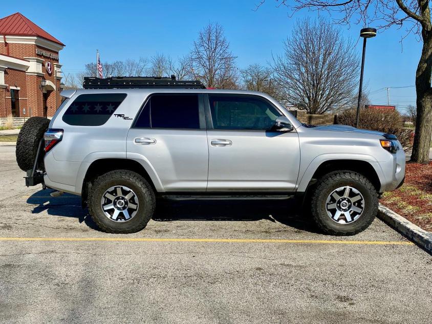

Upgraded my K02s from 275/70s to 285/70s.

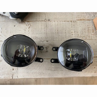

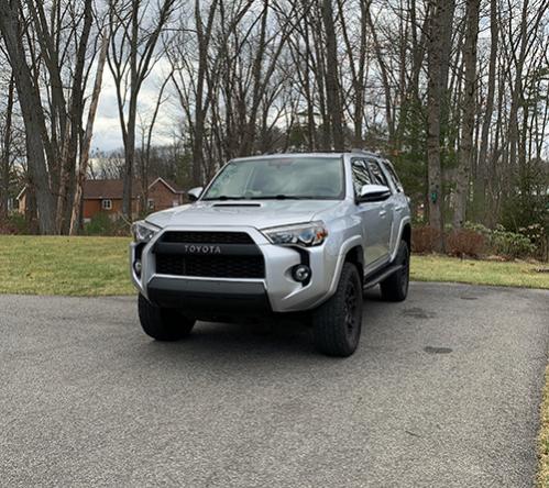

Installed my new fogs last night and immediately started looking for headlight upgrades.

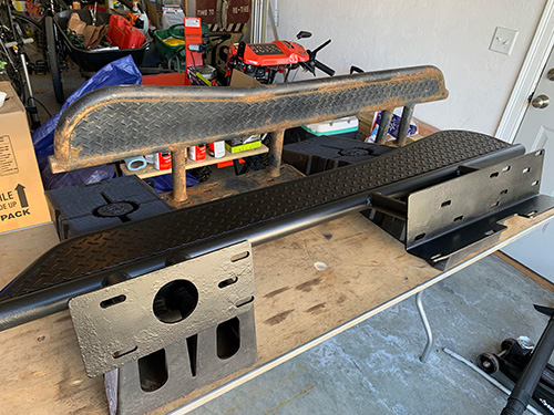

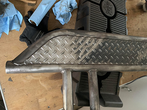

Finally took the time to remove my rusted rock sliders and clean them up. I only finished one after four 4-hour days to wire brush (both cup and wheel), prime (Rust-Oleum Rust Reformer) and Paint (Rust-Oleum Truck Bed Liner).
Did three to four coats of the rust reformer and 5+ coats for the truck bed liner. I made sure to put even more layers of the top coat on heavy-trafficked areas.
I also made sure to clean up the frame a bit where it had surface rust and primed and painted them as well.
Next I'm planning on removing the stock gas tank skid and doing the same thing.
*Can somebody help me upload photos? I tried saving as PDF's and JPEG's within the KB size limit, and I shows an error uploading*:help:
Finally took the time to remove my rusted running boards and clean them up. I only finished one after four 4-hour days to wire brush (both cup and wheel), prime (Rust-Oleum Rust Reformer) and Paint (Rust-Oleum Truck Bed Liner).
Feel free to send me the pics, [email protected], I'll resize and upload for ya
