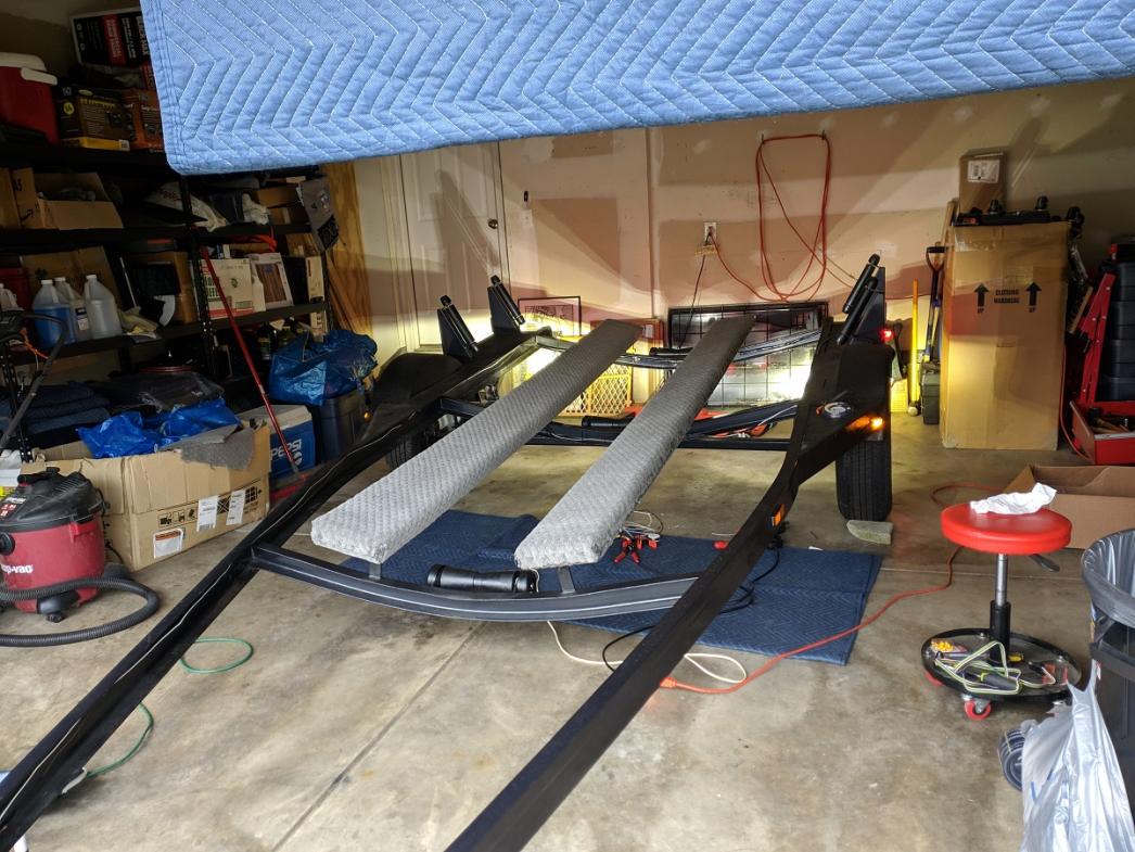

Over the past year I've been refurbishing my boat trailer. I bought a used trailer that would fit my hull, and put the boat in storage on that trailer. It's not a perfect fit, but she's supported properly. April last year my dad, JROTC teacher, dropped it into the high school's welding and auto paint classes. They removed all the bunks, what was left of the lights and wiring, and all of the rollers. It got new leaf springs, suspension hardware, fenders, and a custom fender liner. Then off to paint where it was blasted and painted, with bedliner texture for the rear fenders & step. They apparently didn't use the rust converter as I had intended, and ruined the winch with it instead of applying it to the whole trailer.
I didn't get to finishing it last year before it got too cold, so started back in March working on projects. New bunks are cypress, double wrapped in a berber pontoon boat remnant mounted on all new hardware. I mounted a new winch up front (Fulton F2), and replaced all hardware on the front post. All new rollers for the keel and sides too.

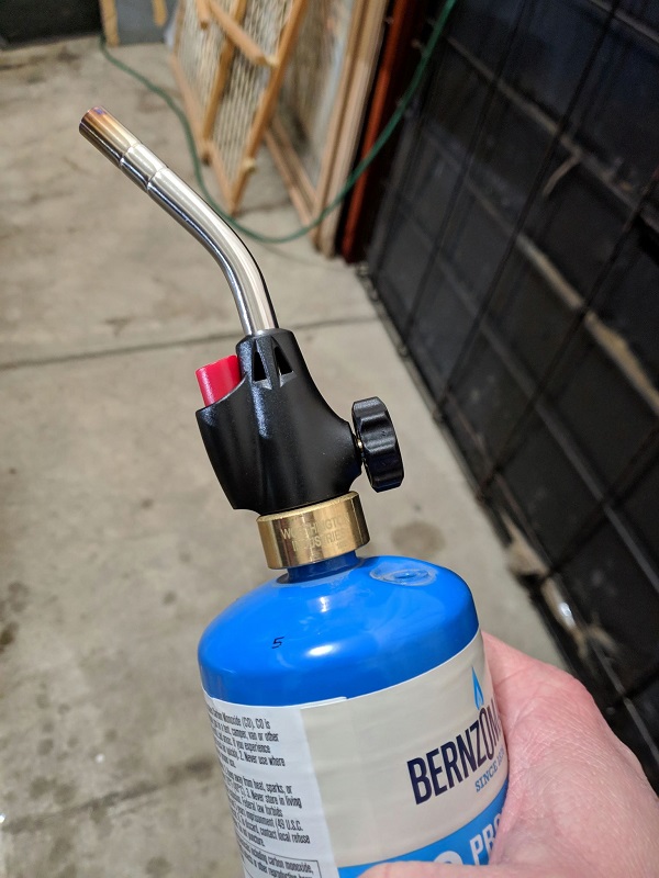

This last week was the not fun part, all the wiring and lights starting from scratch. I've learned a few new things along the way too. Like how a soldering iron just won't cut it when trying to heat up a joint which has 25ft of wire on one side. A propane torch might not be the best soldering device but it's a whole lot quicker than a soldering iron. Use it on too high of a heat and you won't need solder because the wires will have melted together!

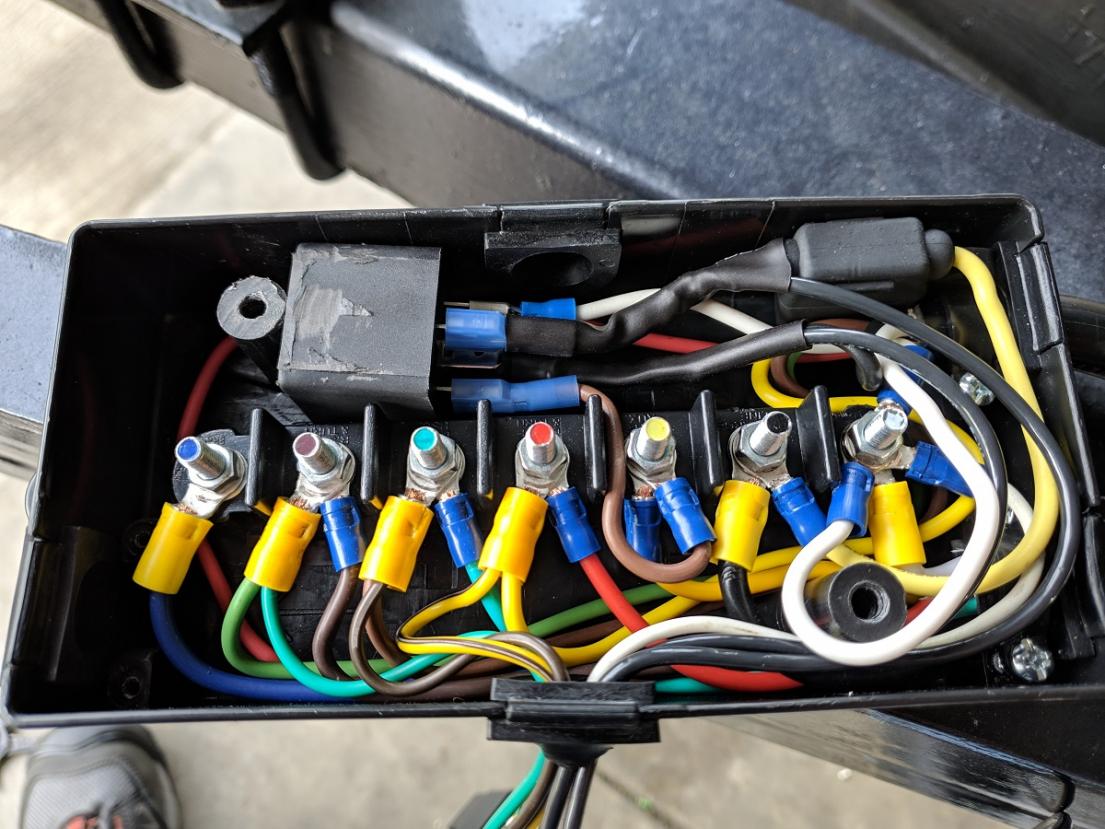

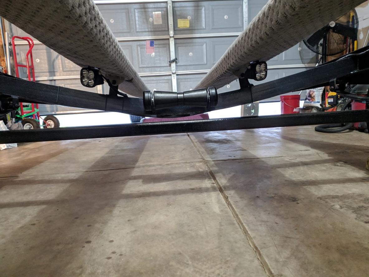

So I put in all new wiring, with both 7-blade & flat-4 connectors through a distribution box. All splices and connections are soldered, coated with di-electric grease, then covered with heat shrink. Lights are all LED, sealed, submersible, and attached to a ground wire. I added a pair of BajaDesign Squadron Sports as work & reverse lights. The Squadrons operate on a switch on the winch post, or automatically via relay any time the tow vehicle goes into reverse (7-blade only). After several tries over the past couple days, I finally got everything working right this afternoon attached to the 4Runner.
