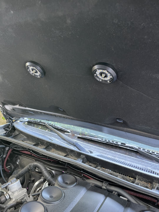

Updated my under hood KC Cyclones with these Desolate Motorsports aluminum bezels, they hide my imperfections in cutting the hood liner.

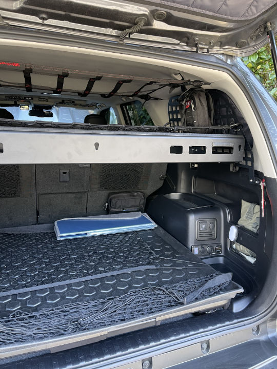

Installed my Victory 4x4 Molle Panels and Shelf.

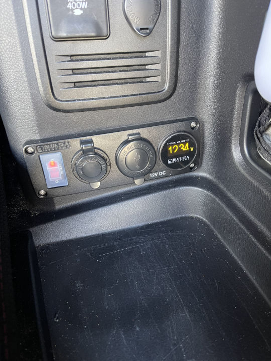

Ran constant power to the rear and installed a Blue Sea unit...

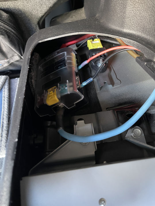

it's attached to a Blue Sea fuse block in the wheel well...

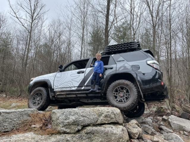

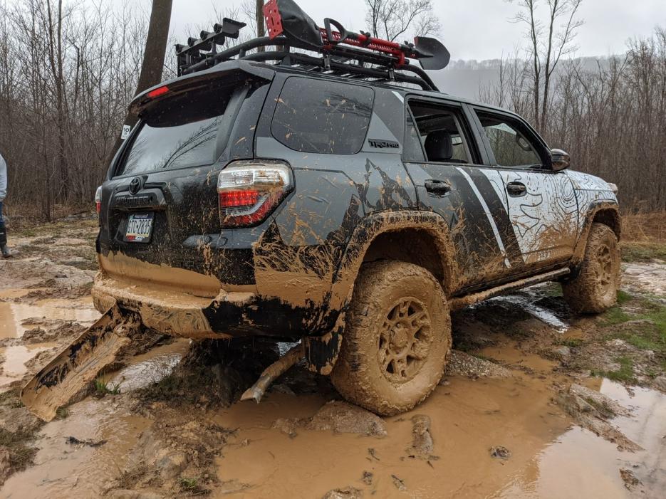

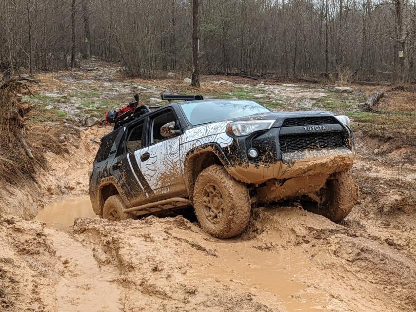

Got muddy and broke some stuff last weekend....

Curious, what did you break? Edit: just noticed your tailpipe and ripped rear valance. It’s camouflaged in the mud. Looking on my cell phone. You crushed the end and broke a hanger. In the mud or the rocks? Time to reroute the exhaust out the side? Your son looks like he’s having a good time and you have him equipped with the right boots. I like your setup and the GOAT. What suspension and tires, AT3W’s in 285/70?, are you running? My sliders are similar to yours and my son is probably similar in age and loves going 4wheeling.

My oldest is 5 and goes every trip. He loves it.
There was a rock under the mud pit that took out my tail pipe when reversing. I never made it out of that pit. Got high centered and winched over by a buddy. Tried like 10 times to make it but kept digging deeper.
I May be cutting the exhaust near the axle for now. It’s bent down pretty bad. I have stock Fox shocks with eibach springs and a 1/4” spacer on top of the mount. Rear is lifted almost 2” with Dobinsons springs. Running KO2s in 285/70. Aired down to 18psi, the thing crawls up rocks pretty good.

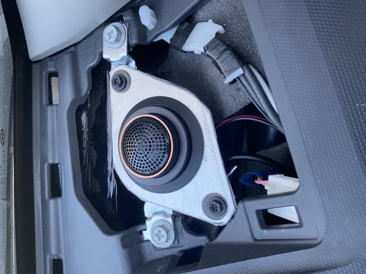

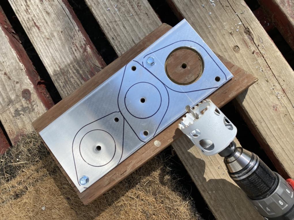

I couldn’t get my passenger side dash speaker grill to close after adding a tweeter and 1/4” thick tweeter adapter I got from Amazon. I already tried to fix the problem by trimming the speaker grill plastic on the underside and the driver’s side worked just fine. So, I picked up some 1/16th inch thick aluminum plate from Ace Hardware and used the Amazon tweeter adaptor as a stencil. I laminated the aluminum adaptor to prevent direct contact with the steel (not sure how necessary that actually was). The extra 3/16” of clearance allowed the speaker grill to close again!
