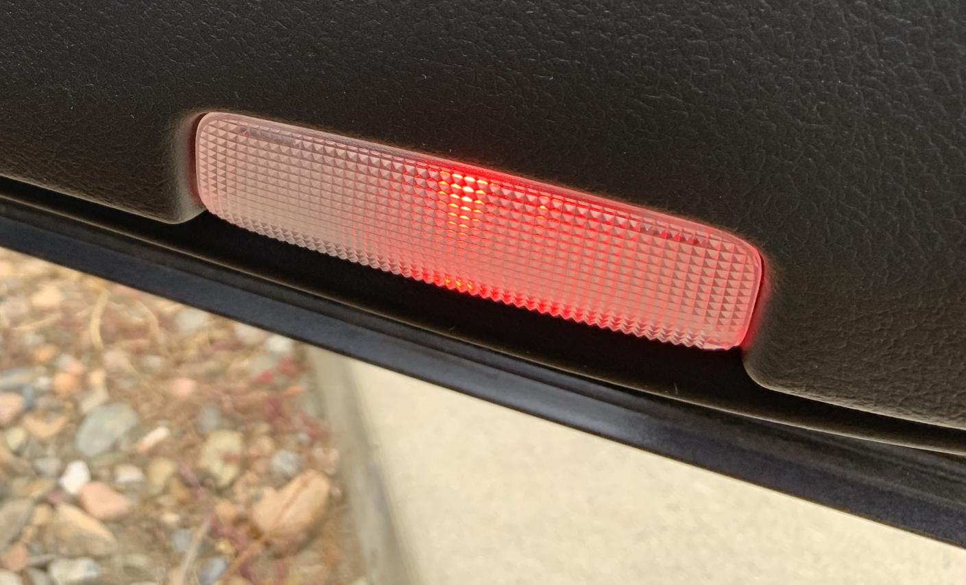

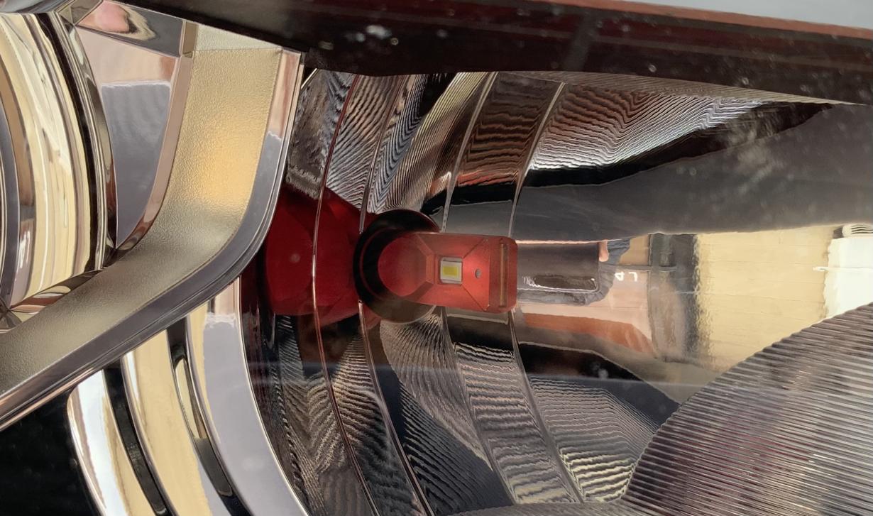

Added 6000k LED's throughout cabin. FireHawk High-Beam LEDS, Puddle Lights, Smoked lens sequential turn signals for SV mirrors, finished with red courtesy door Leds. Can't believe the difference!

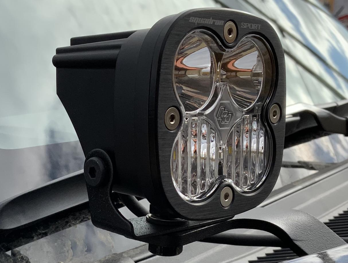

Blacked-out chrome brackets on my BD ditch light pods with bed liner. Stealth Mode almost complete.

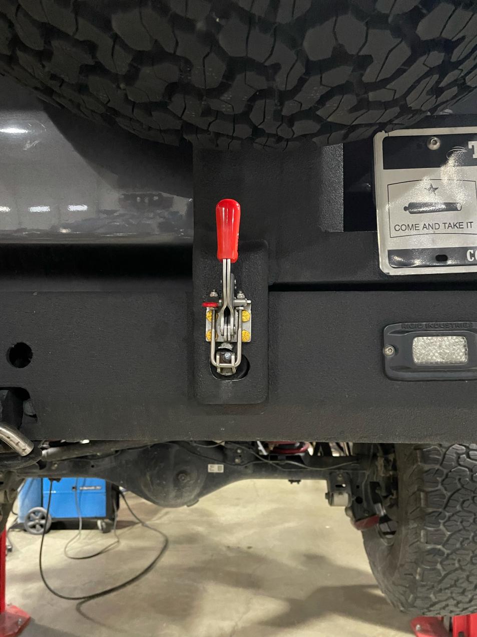

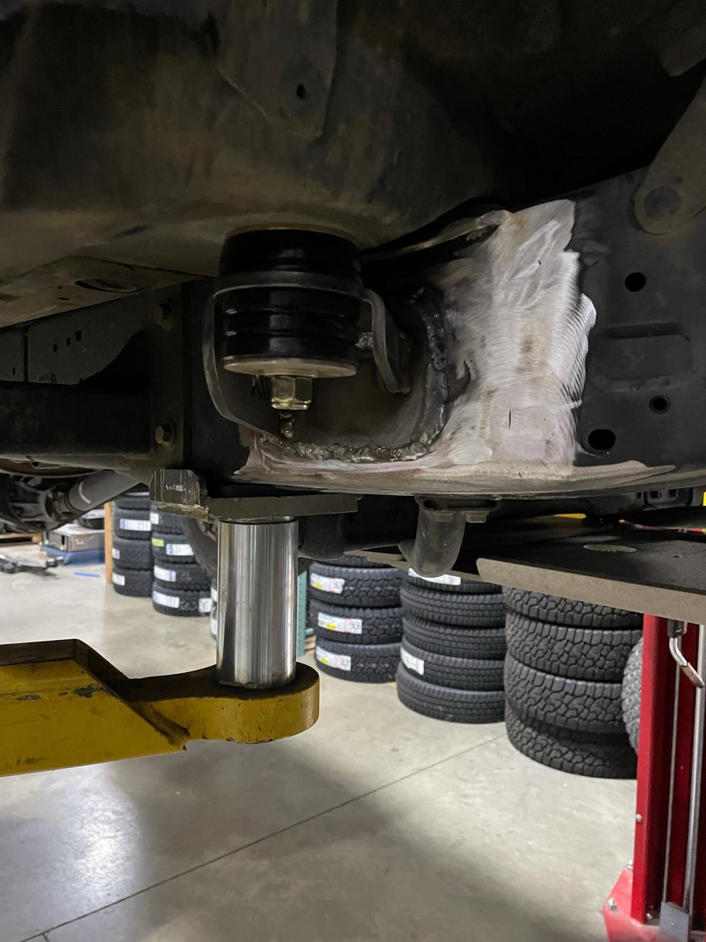

long overdue tune ups
- body mount relocate / pinch weld cut n smash
- LCA cam tab gussets
- panhard correction kit
- busted SPOD replacement
- swing arm rebuild kit
- custom clamp latch for the swing arm, couldn't stand the old hefty fab style pin any longer

What wheel/tire combo led you to do the body mount relo vs simple chop?

Ray10 17x8.5 -10 with 285/75 KO2. had a mild chop before, most rubbing was the pinch weld, but occasionally the body mount as well. eventually this rig will have 35s and a re-gear so it's fully ready now.
