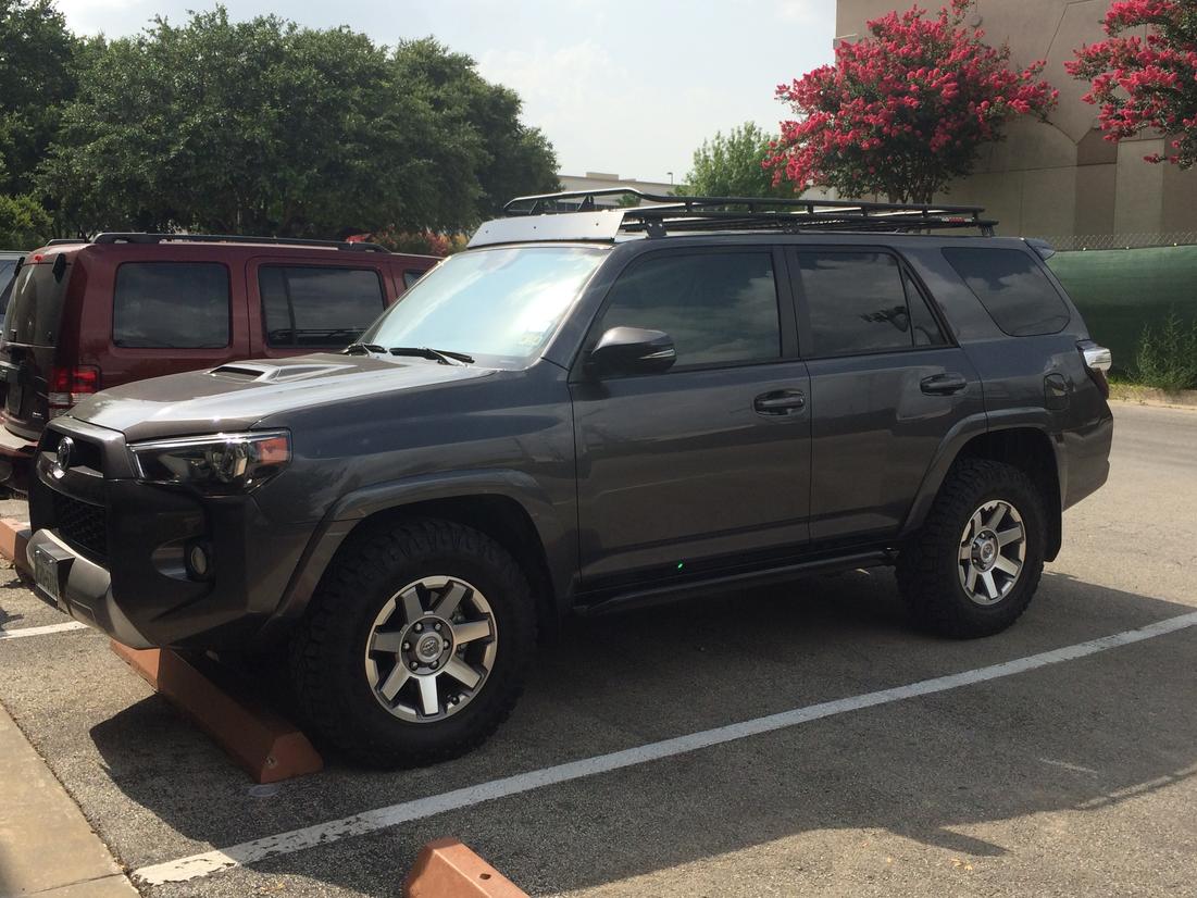

Installed RadFlo 2.5" extend travel coil overs and Camburg Ball Joint UCA in the front and RadFlo (Eibach) 2" rear spings w/ 2.5" extended travel Shocks in the rear. 285/70R17 KM2's.
Have some trimming/relocating of the front fender flare to do this weekend along with adjusting the fronts to be closer to rear. I am looking for a slight rake but not much.
Initial impressions: Solid products all around, installation is easy although the KDSS is somewhat of a pain (an extra set of hands and floor jacks makes it very doable). Nose dive as expected is greatly reduced and the ride is firmer then stock but not harsh. Took it down a pot hole filled gravel road the ride was much improved (read smoother and controled) over the stock set up.
Worth the cost, absolutely, was it needed - absolutely not. My only concern is how the shock bodies hold up to MI winters.

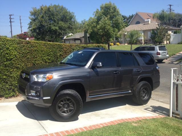

Finally got my Gobi on. Lights and Lift next, then I am going to take a 6 month hiatus from this site. I can't afford to keep going on like this.

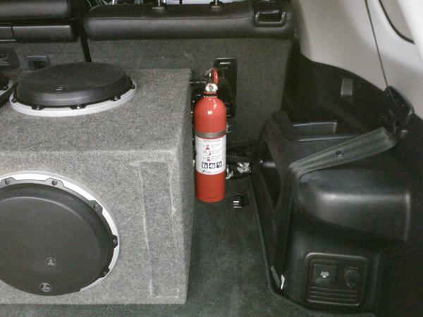

Been meaning to do this. I finally got around to mounting that A/B/C/ "fire extinguisher" in the cargo area. Where I live in the greater NY/NJ area, you see a lot of stuff happen on the road so I'll try to help out if someone needs assistance. I actually carry with me 100ft' heavy gage nylon rope w/large latching steel hook, extra long, 1/0 AWG jumper cables, self locking canvas cargo straps, yada, yada, yada! Check out the new extinguisher:
