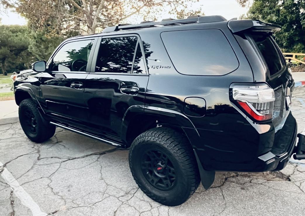

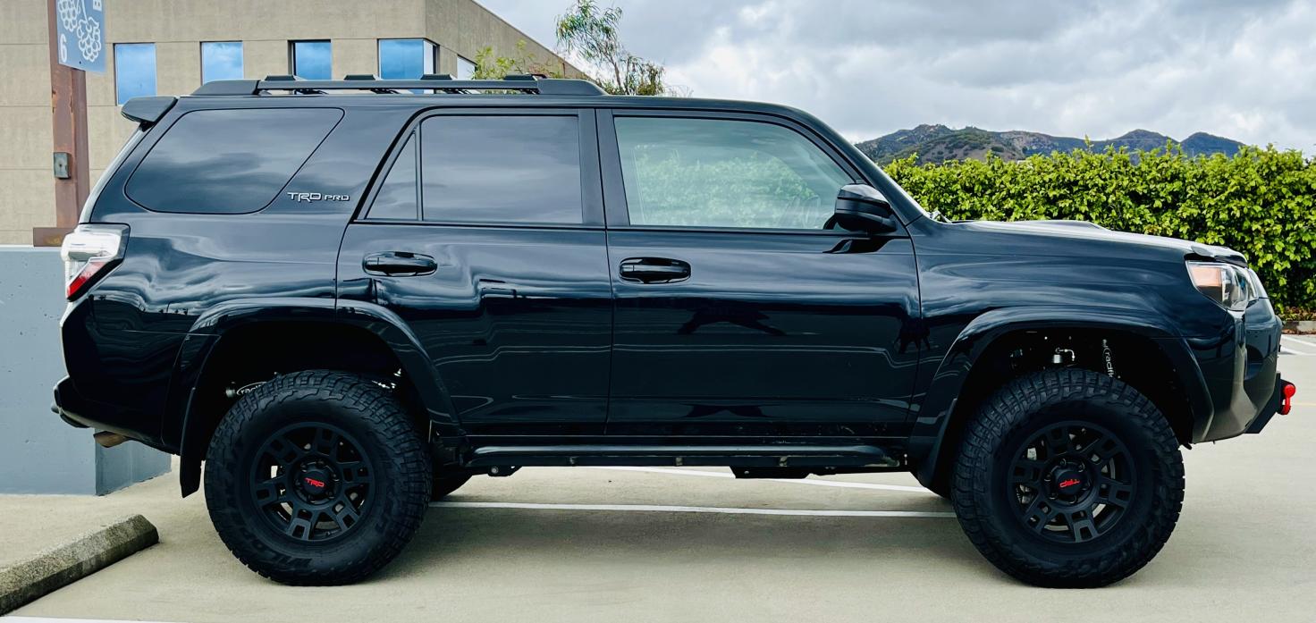

Yesterday I had all my 4Runner windows, including the sunroof, tinted with 3M Ceramic IR.
I went with 5% sunroof, 15% five rear windows, 50% front passenger and driver windows and 70% windshield.

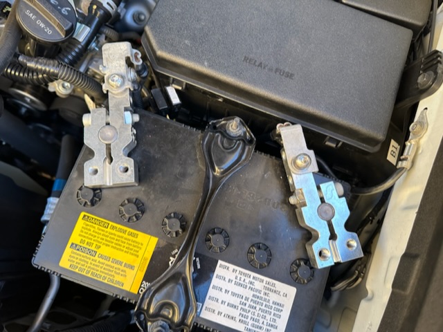

Swapped from Slee to SDHQ billet terminals. Since both are taller, you have to turn them slightly so the cables aren't stretched out. The Slee are good but they are just too long for the standard battery.
Slee:
400911d1667846516-what-did-you-do-your-5th-gen-today-3201f495-04a5-4713-a84a-f078fd5aa417-jpeg

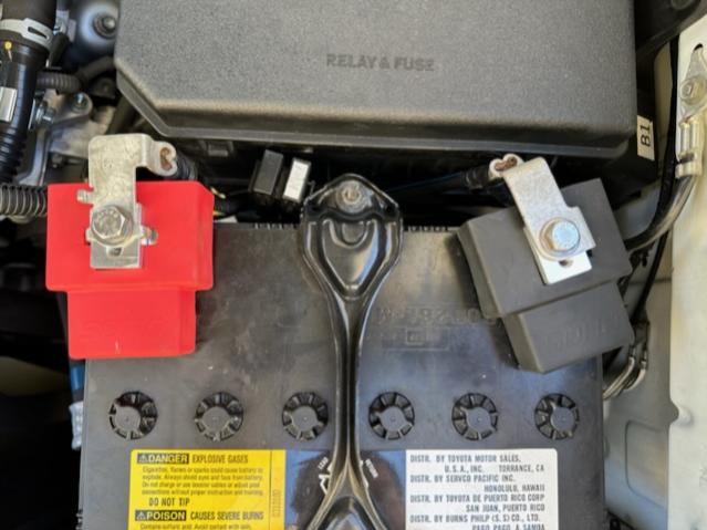

SDHQ:
400912d1667846516-what-did-you-do-your-5th-gen-today-5c73aaea-1802-4c96-85be-12a6e7919ea9-jpg

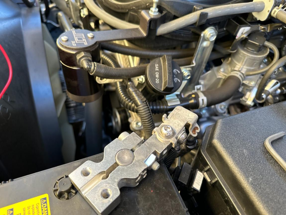

Bonus content: I got a no start condition after I did the work so I swapped back to the Slee terminals only to still have a no start condition. I checked voltage, ground, cables for damage, jumped it from my battery pack and from my other car but nothing. I saw my mistake and took a picture. If you find it, I'll give you an internet high five.
400913d1667846516-what-did-you-do-your-5th-gen-today-4bf2124d-e156-4e93-866f-c3dfc47aed10-jpg
