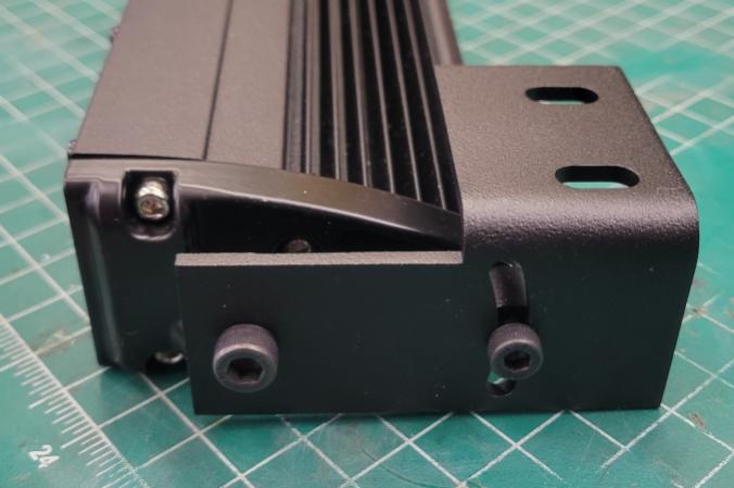

Installed Diode Dynamics Stage Series Flush Mount Reverse Lights in pods I designed and 3-D printed. Due to the shape of the 4R rear bumper, flush-mounting these lights puts them at an angle that didn't result in the intensity directly behind the vehicle I was looking for. (Yeah, they're pretty floody, and flush-mounted in the bumper is probably sufficient for any sane person, but I wondered if I could get them to point straight back.) They look a little silly--I may downsize the "loft" off the bumper so they're not so prominent--but they now send light straight back. (Fun project, but dang hard to match all the curves in the stupid bumper!)

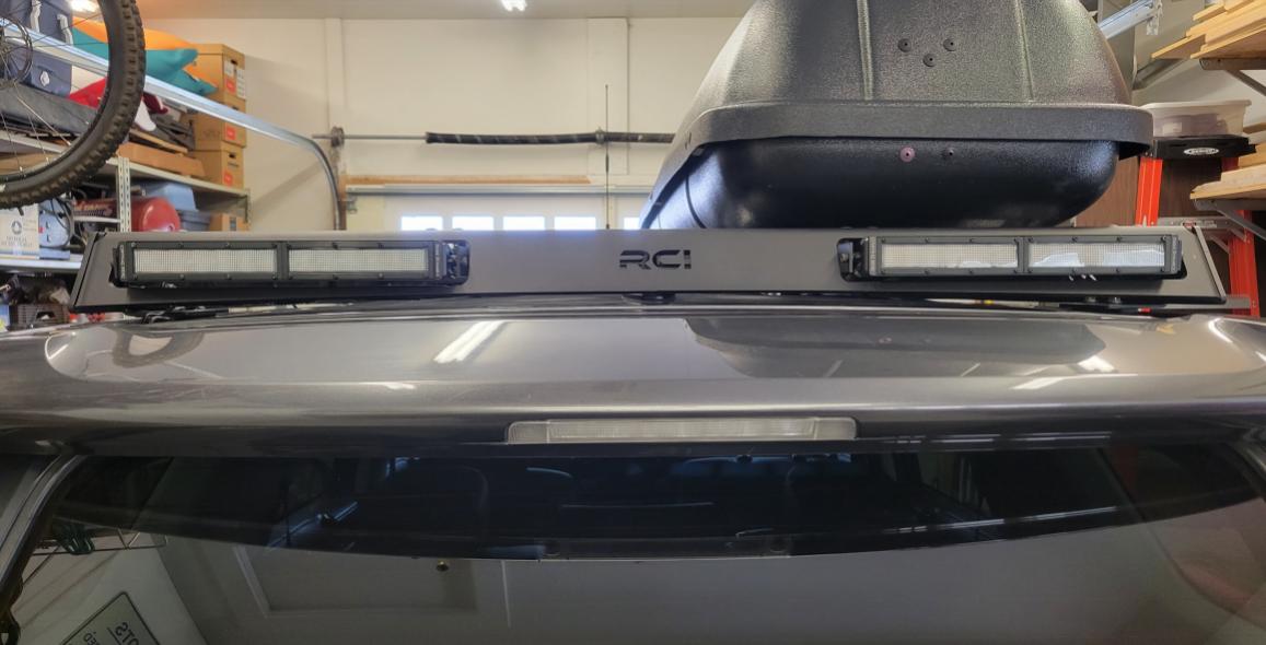

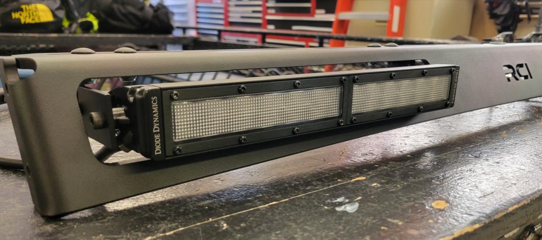

Here are the other reverse lights. As you can see, I can't have any lights sticking up on the rack (they hit the long roof box), so I milled out the existing holes in the RCI rear fairing, designed and fabricated some brackets, and sorta frenched the lights into the fairing. Works good, but it creates a giant spoiler-shaped shadow out to about 15' behind the 4R! (Hence the motivation for the bumper-mounted SSC2 lights--they fill in that void nicely. :D)

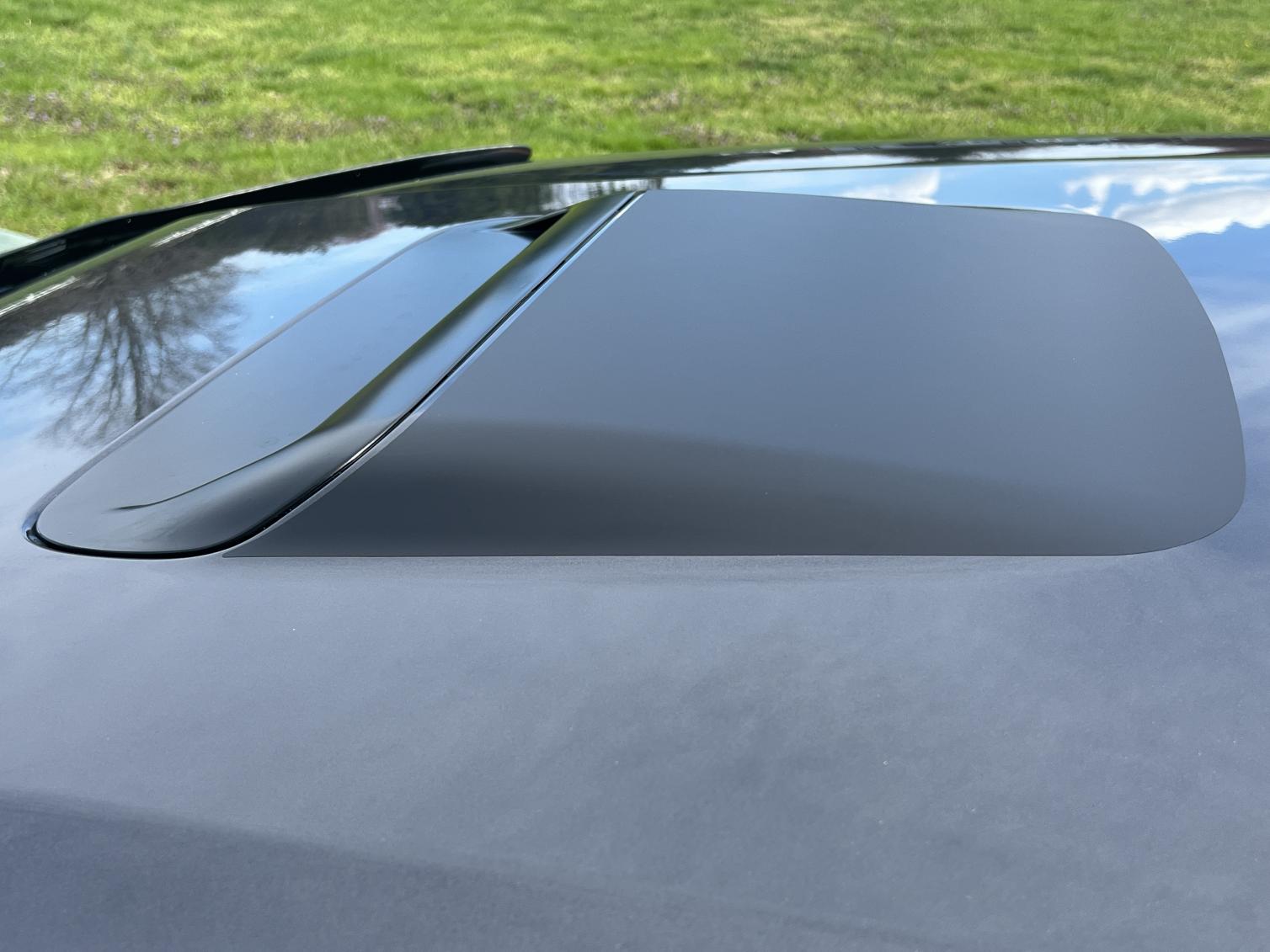

I applied the YodaVinyl anti-glare hood scoop decal, using the wet on wet technique. Some of the best $33.15 (shipped) I've ever spent.

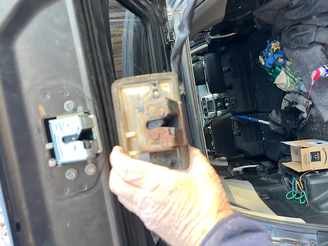

Replaced the lift gate latch and actuator assembly on the 2014 SR5 which has 350K miles. Latch assembly was rusted and getting stiff, then the actuator itself finally went out. Replaced it with a Chinese Knock Off by Himiki for $52 off Amazon. Guys are asking $120 for used, rusted OEM units on eBay, but why buy someone else’s problem? Once installed, the Himiki unit works just fine. Pretty straightforward job.
