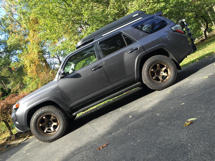

Magnetic4R the volk racing choice was all your fault..lol

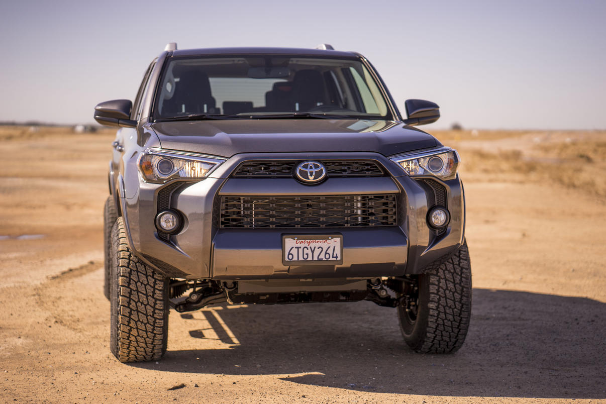

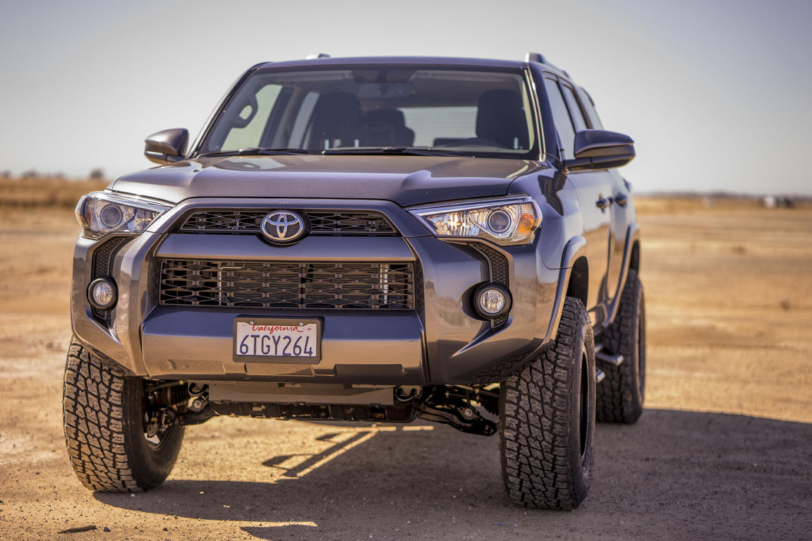

I added some 1.5" wheel spacers today. I managed to trim enough in the front to eliminate rubbing but the back of the front wheels rub against the frame so I can't fix that without taking it back into the tire shop and having them adjust the alignment. I will get it in next week for that. I am sure I will need to do more trimming in the front once the alignment is done to fix the back rubbing.

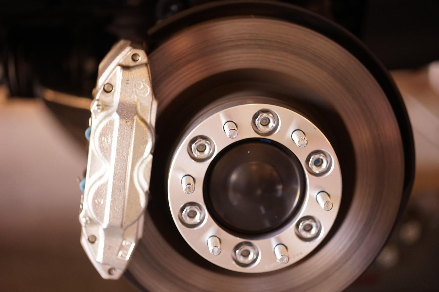

Nice stance there brothere.you should've ordered a hub centric wheel spacer.
Got a set of those and my steering started shaking after 55mph so i ordered new hub centric ones
I just looked up what a hub centric wheel spacer is. Looks like a great option. I hit 80mph on the freeway today and seemed smooth so far. But if they start to vibrate I will most likely remove them. My local tire shop uses these all the time for off road vehicles and stand by their quality. Hopefully they are right.
If I can't remove all the rubbing I will be removing them anyways. I prefer function over form and don't want to deal with rubbing.
I will let the forum know if these work out.

if you're switching over to a hub centric spacers, maybe consider the 1.25" to help minimize the rubbing.
