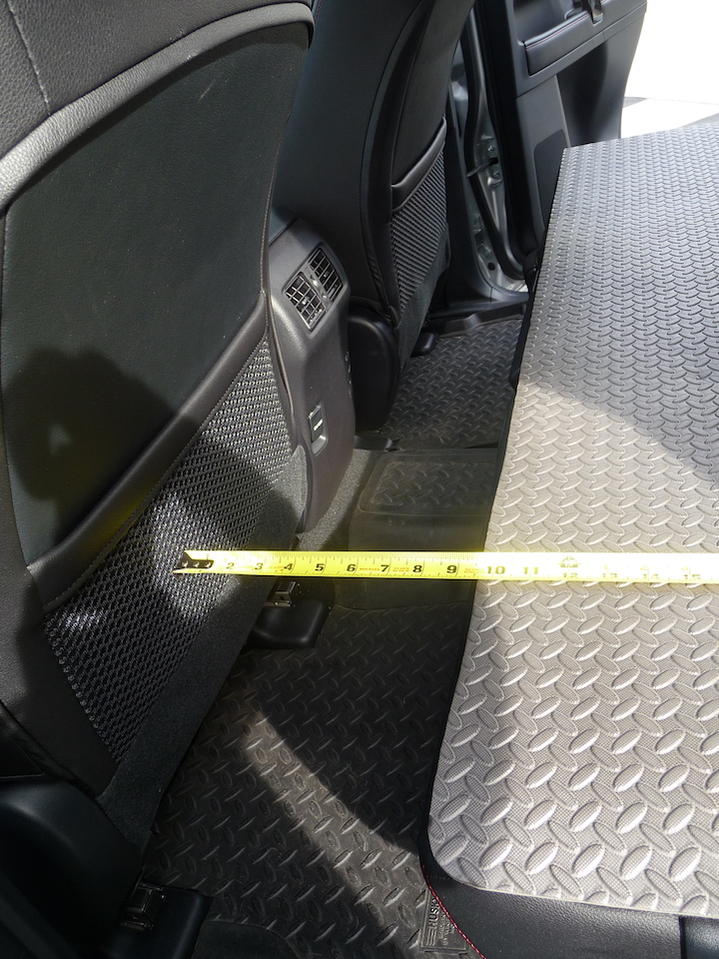

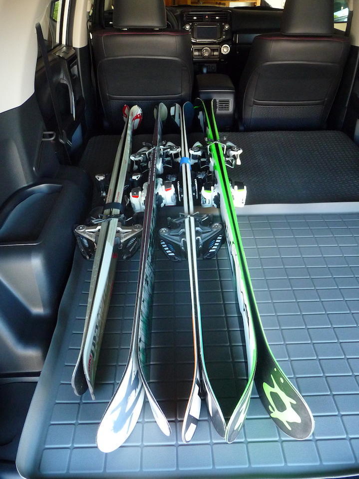

Removed Lower Back Seats
Gain 9" to 10" of bed length by removing the lower back seats.
Also adds a bunch of storage space.

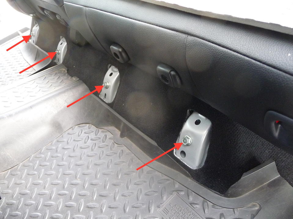

Removes easily with 2 bolts per seat (I put the bolts back in to prevent loss).
Skis fit straight instead of diagonally with seats installed. (200cm or longer fits depending on front seat position).

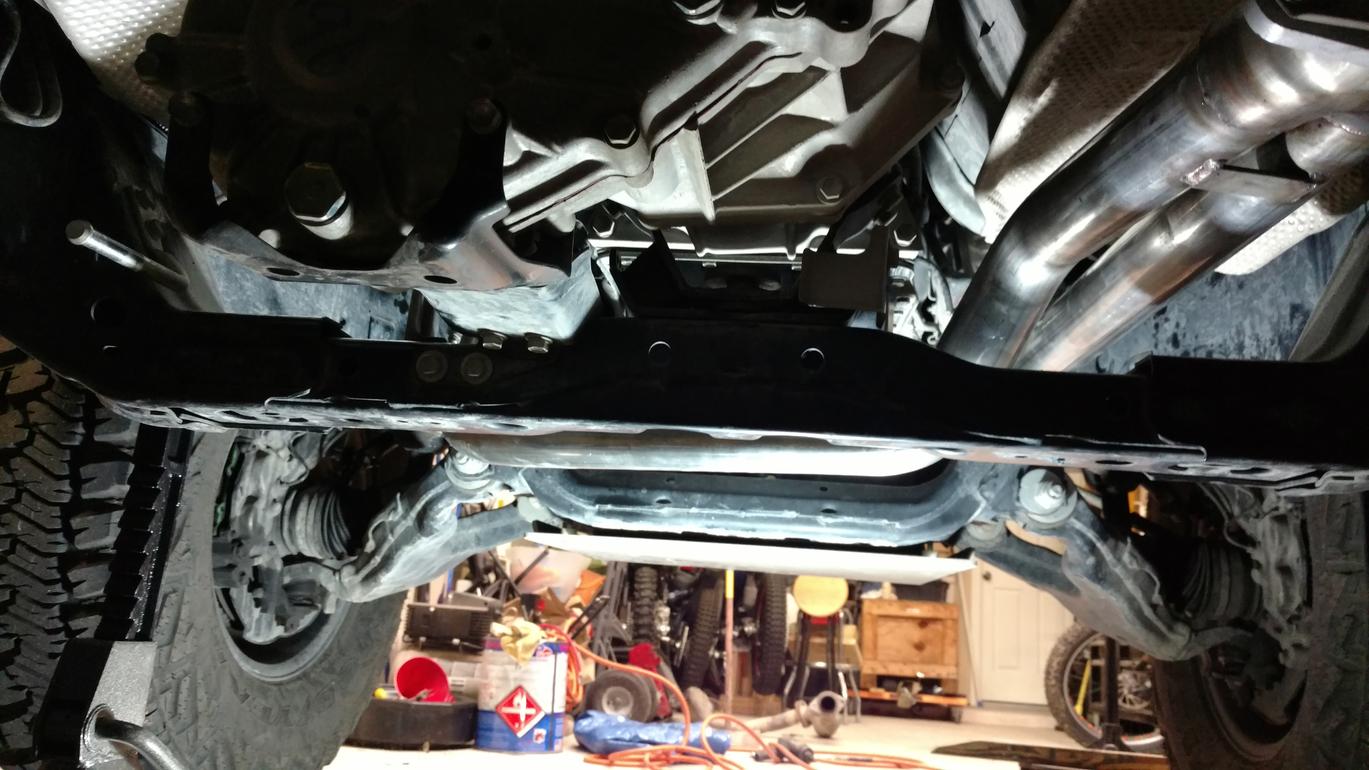

Finally got rid of that ridiculous Y pipe. So much better. More clearance and power... No more crush section after the cross member. I can now raise up my transfer case skid brace an inch or so.
Gotta agree I give URD a big thumbs up for building these!
