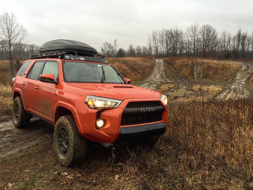

Looks good! So it wasn't too difficult? I am about to get a roof rack/ladder (leaning toward Gobi) and have been curious how big a job it is to wire a light bar. Any trouble getting the weatherstripping back down? Anything other surprises? TIA
It was not too difficult. The front runner rack worked perfect with the light bar and the mounts it came with and simply bolted on.
I searched wiring led light bar on this forum and found everything I needed to do the work. The weather stripping went back down fine. The front part is held down by double sticky tape so I used a fresh piece of tape when I put it back on. I also had to trim a little in front and back for the wire to enter and exit the strip.
There is a link in one of the threads to a Tacoma Forum light bar wiring that is really good and pretty much walks you right through it. I also followed [MENTION=65614]Antman[/MENTION] and used liquid tape to cover the ground wire attachment to the rack.
For me it was easier to follow the threads on the forum once I had the wiring harness in my possession and then I bought other items as needed per what I read on the threads and how I wanted to install mine.
The most challenging was getting wires from the engine bay to inside the cabin, through the firewall. But I figured it out by following info in this forum. I have never done any auto wiring before besides the heated seats I just installed. So if I can do it anyone else can.

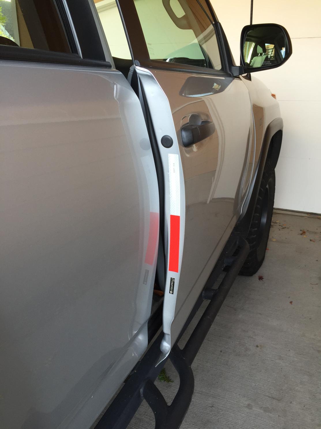

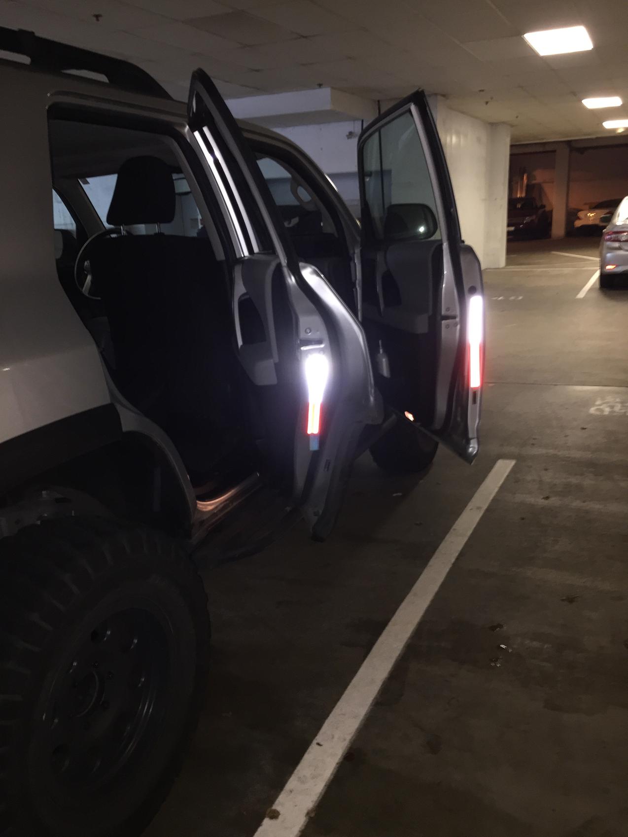

Installed some more DOT-C2 2" x 12" Vehicle Reflective Conspicuity Tape inside the doors. If you cut it in half vertically they fit well as strips.
