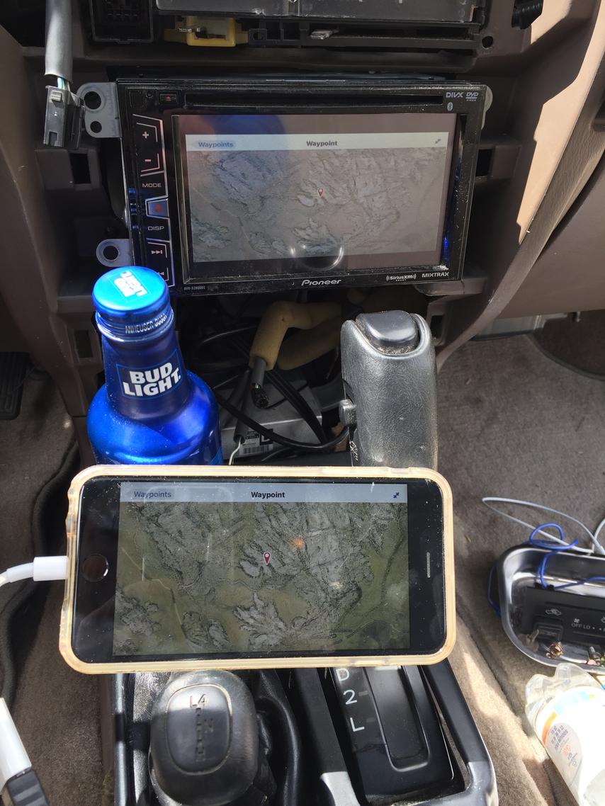

Built in GPS!
Bypassed pesky parking brake requirement on pioneer; now I can track waypoints off iPhone app on radio screen real time. One beer job
