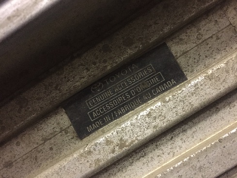

I gave her a bath, swapped out my winter wheels for the crummy Kellys that are on my summer wheels, and pulled the running boards! I found a neat tag on the running boards though, CDM Spec!
Also time to get the other, other set of wheels going too...
