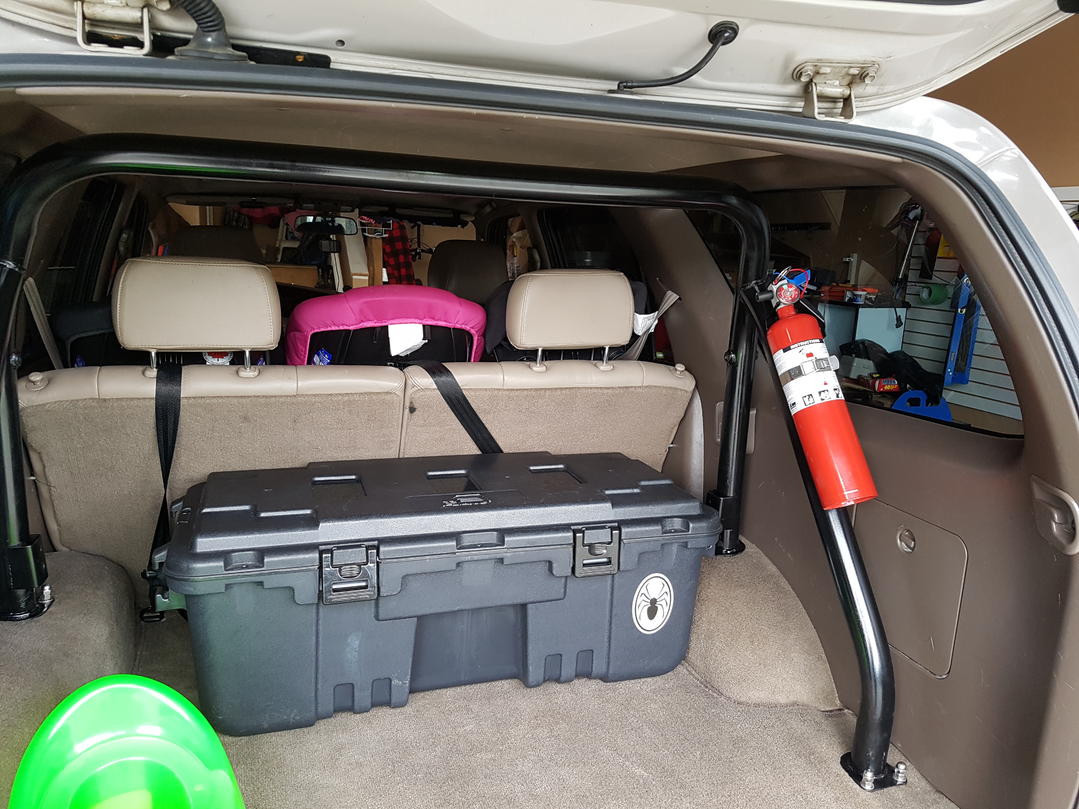

Safety first!
Finally bought and mounted a fire extinguisher.
This addition was long overdue. Cheap insurance to protect my investment.

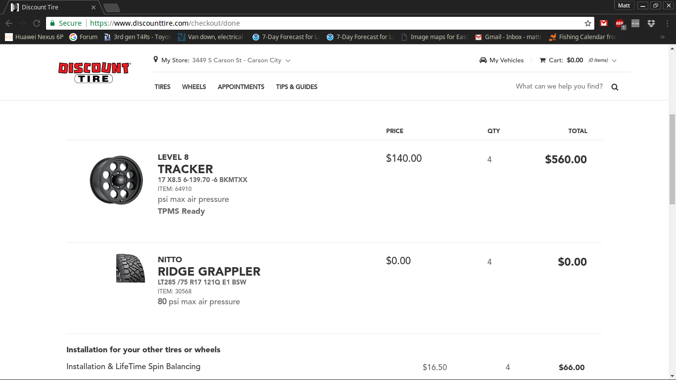

As some of you guys have probably read from previous posts I'm in the market for new tires and wheels. I have done my research and settled on Level 8 Trackers 17's and Nitto Ridge Grapplers in 285/75r17. So I've been looking for the best deal I could find. I just had this happen on Discount Tires site. I have was emailed an order confirmation that has the same info. What are the chances the actually stand by this? I'm betting very little but it's worth a try. I mean who doesn't like free tires?

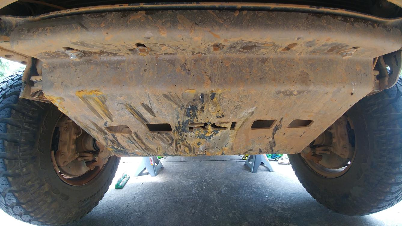

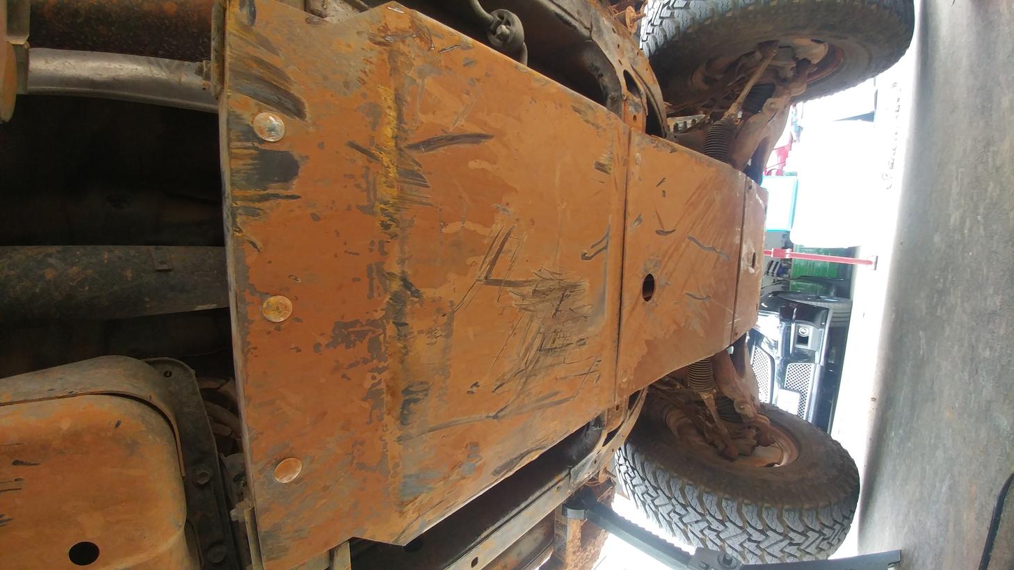

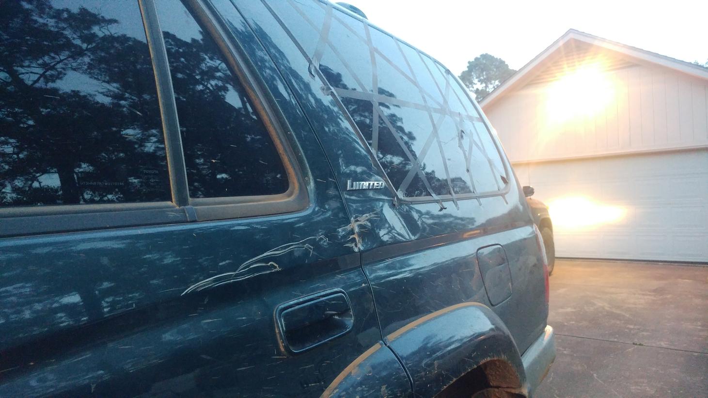

Post Jambo check out. Beat skids back out, installed new passenger side mirror, pulled out front bumper, survey other damages

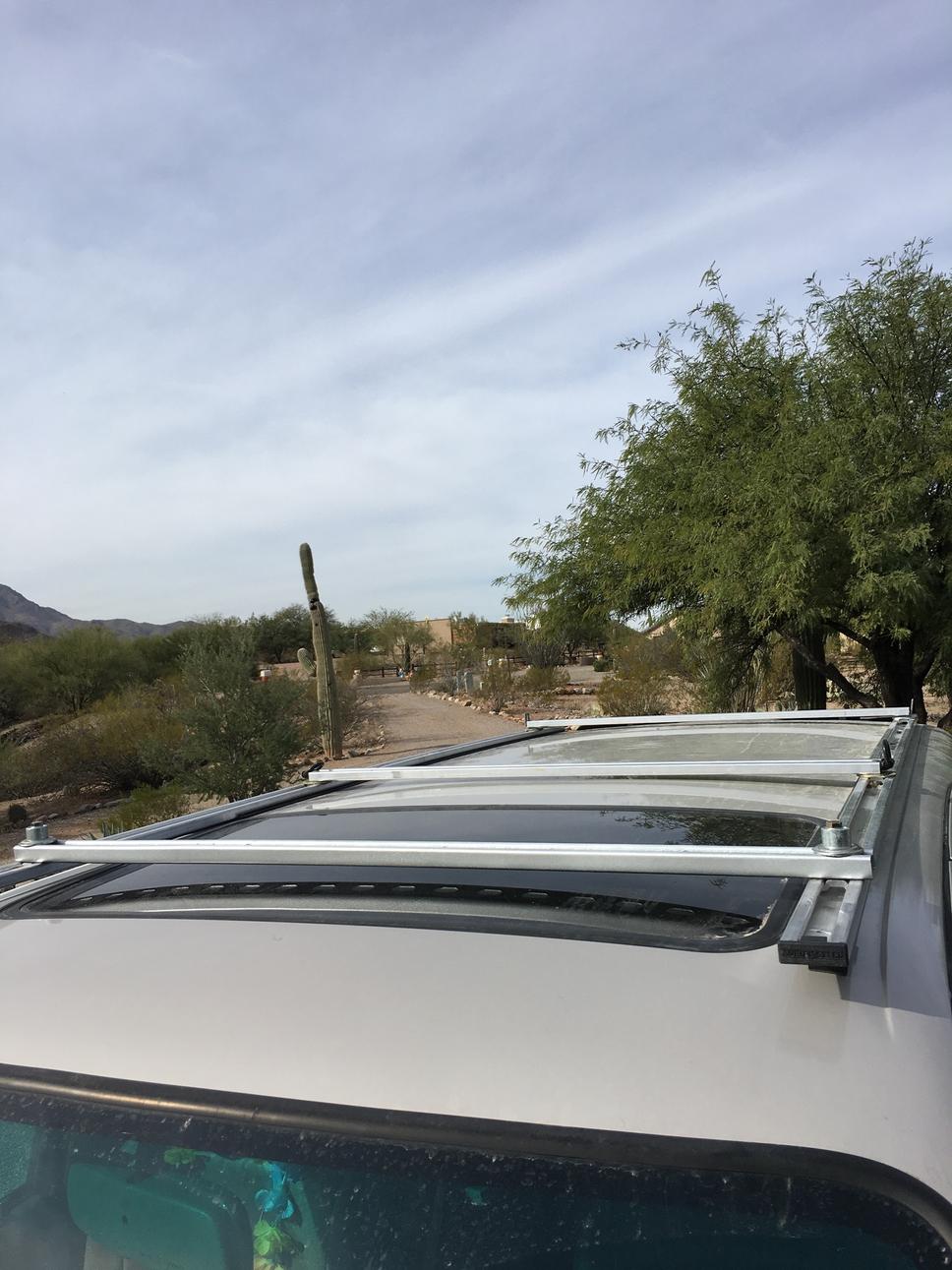

I'm going to make up my own DIY full length roof rack too. I am wondering if there is any advantage to making it flat, or can it just follow the curved contour of the roof, which I would prefer. Does an awning or RTT need a flat rack to mount to? Or could I use some different brackets to mount to a curved rack?
I used the alum channel that's used to bolt work van interiors to the van structure. Got mine free, but alum uni strut type stuff is available. I put hundreds of pounds on it, it flexes but holds fine. I've put full plywood sheets and long boards/metal.

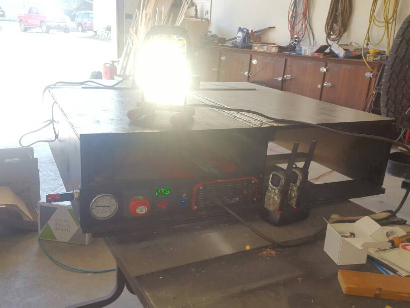

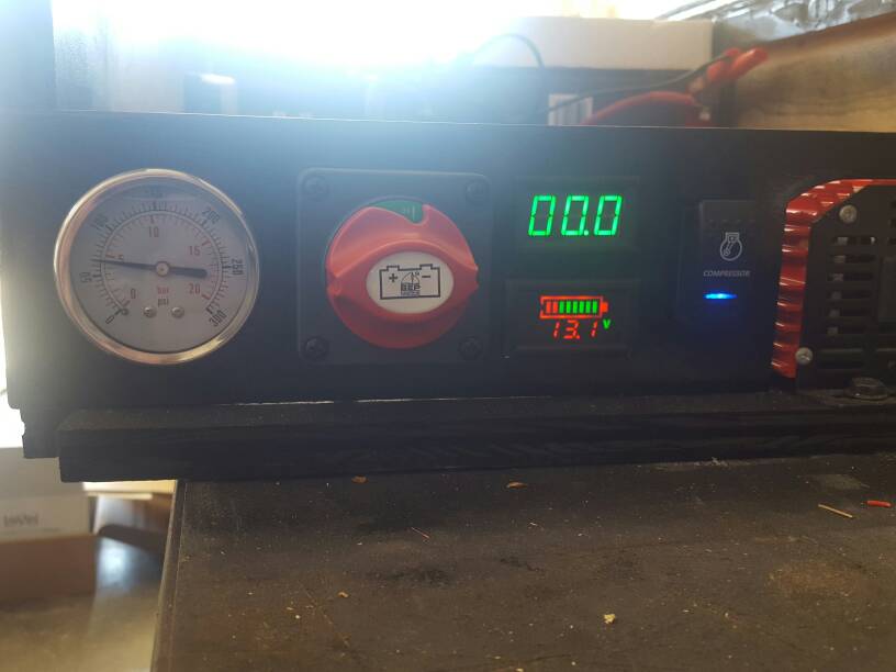

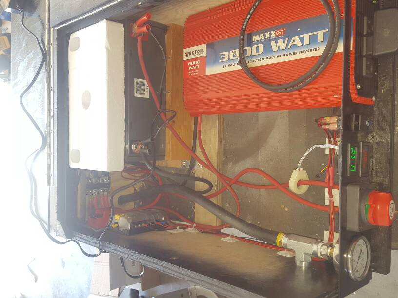

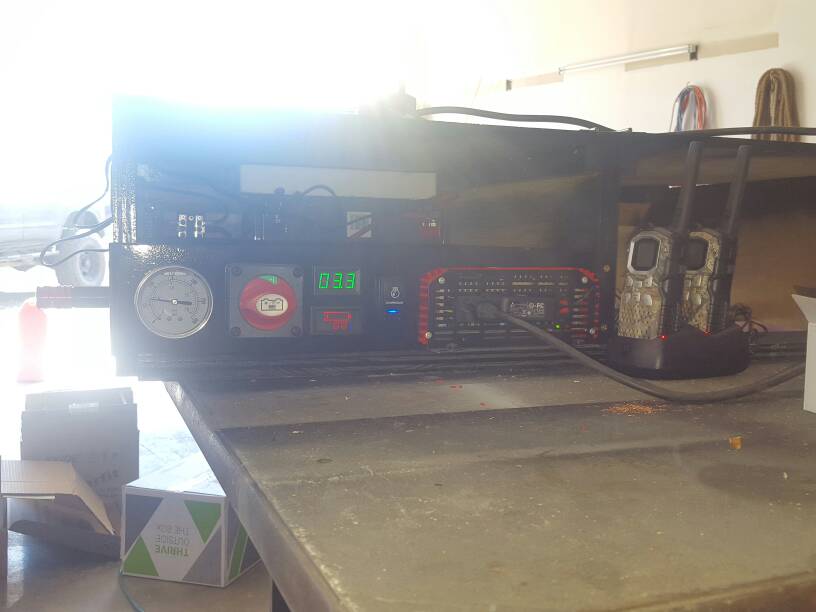

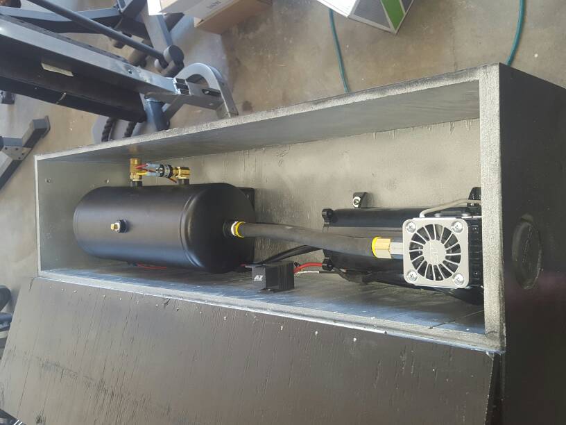

Made progress on my cargo box today. Wiring is still a bit messy. I had them all measured out and the shop messed up the lengths. But they all reached where they needed too so that's what matters (don't have crimpers for 6awg cable). I'm still missing my 12V seloniod valve and that's why I left my hose a bit long. Next will be the drawers and the wiring and hose to the front of the truck. Think I'll add a check valve once I run a line from the tank to the front of the truck. That way if I ever loose pressure at the tank, I should have enough air to keep my locker (once I get one on the front).
Amp gauge works great. Once I configured my other gauge it was looking good also. Inverter works as expected. Excited that I can have work lights close by now.
So when I worked sales for 6 years when this type of situation happened we would meet the customer at cost for the item. Now each case is different of course, but adding my 2 cents.

Thanks for the feedback on what I might possibly expect. I'm gonna call the store tomorrow and ask them to mount and balance them and give me an out the door price. Then the haggling begins. lol
