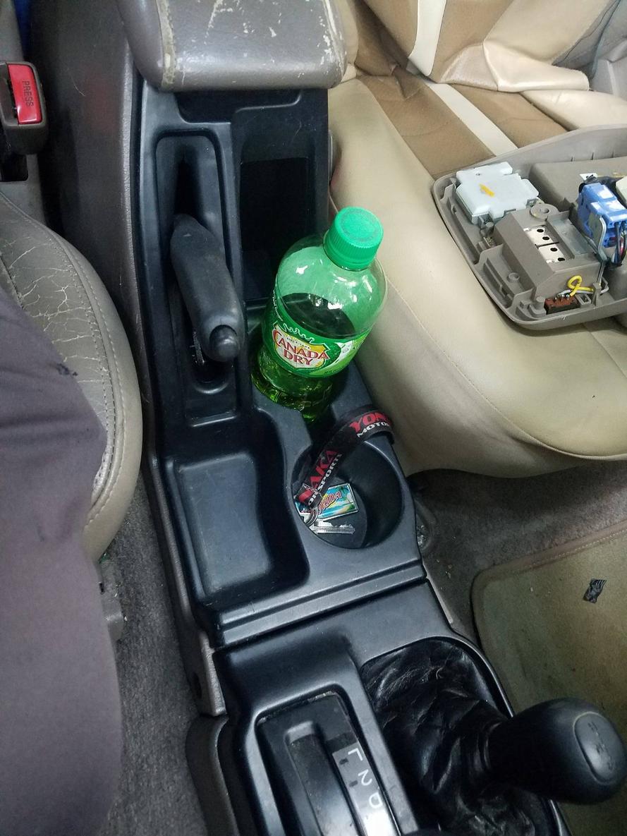

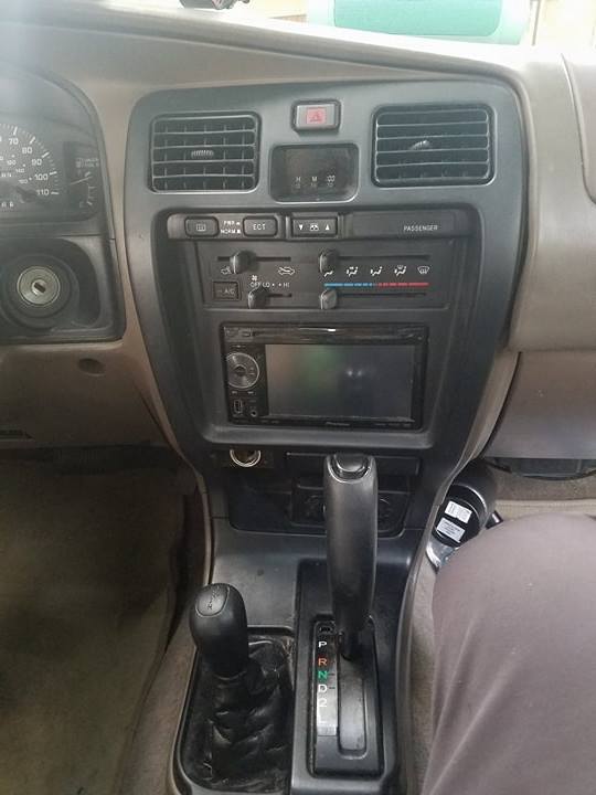

installed my 99 center console

We're the "ECT, Rear defrost and rear window" buttons straight plug and play.been wanting to do this to my 98 T4R
Sent from my iPhone using Tapatalk Pro
no only the clock is plug and play
hazard button need to get repined
rear window and ect need to get rewired to the newer plug since its all in one
and as far as the rear defrost i dont think any one has figured out how to make it work.
so i just took mine rand the wires down to the driver side by the pedals and left the original button hooked up
What did you do to your 3rd gen today?
False! I found a write-up and got mine to work perfectly [emoji1360] You have to use the original button, as it has the actual locking relay/timer within the housing. The new button actuated the old button. Orange light on the new button worked as it should and everything. Old button gets tucked behind the dash face- to never be seen again [emoji12][emoji1598]

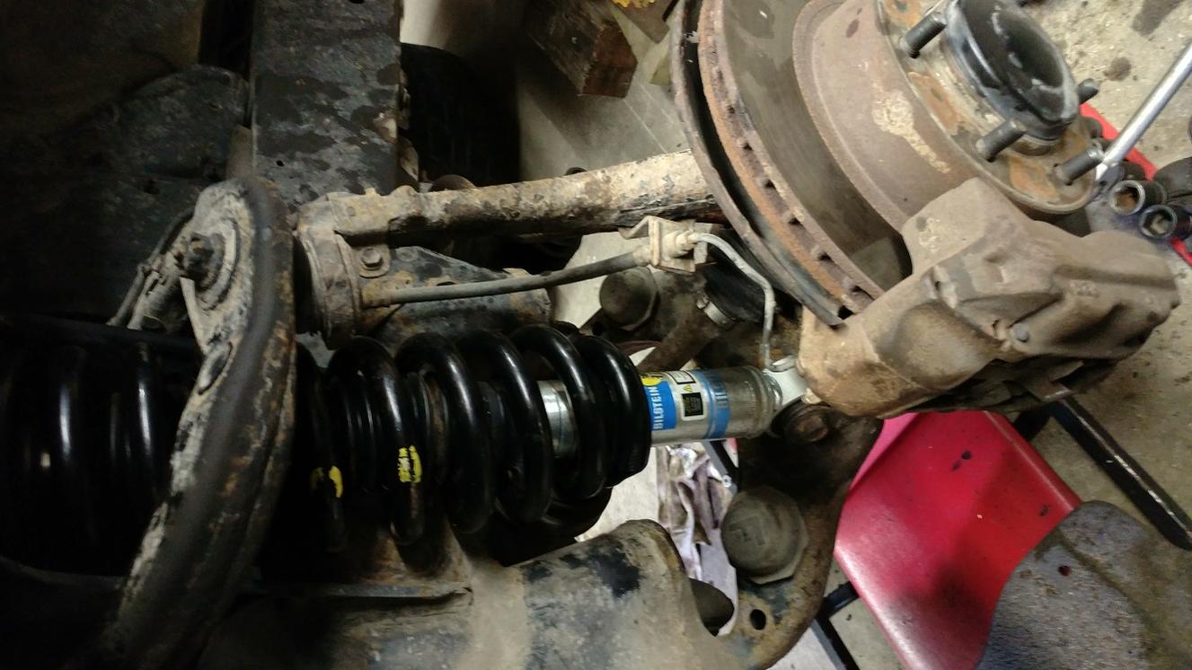

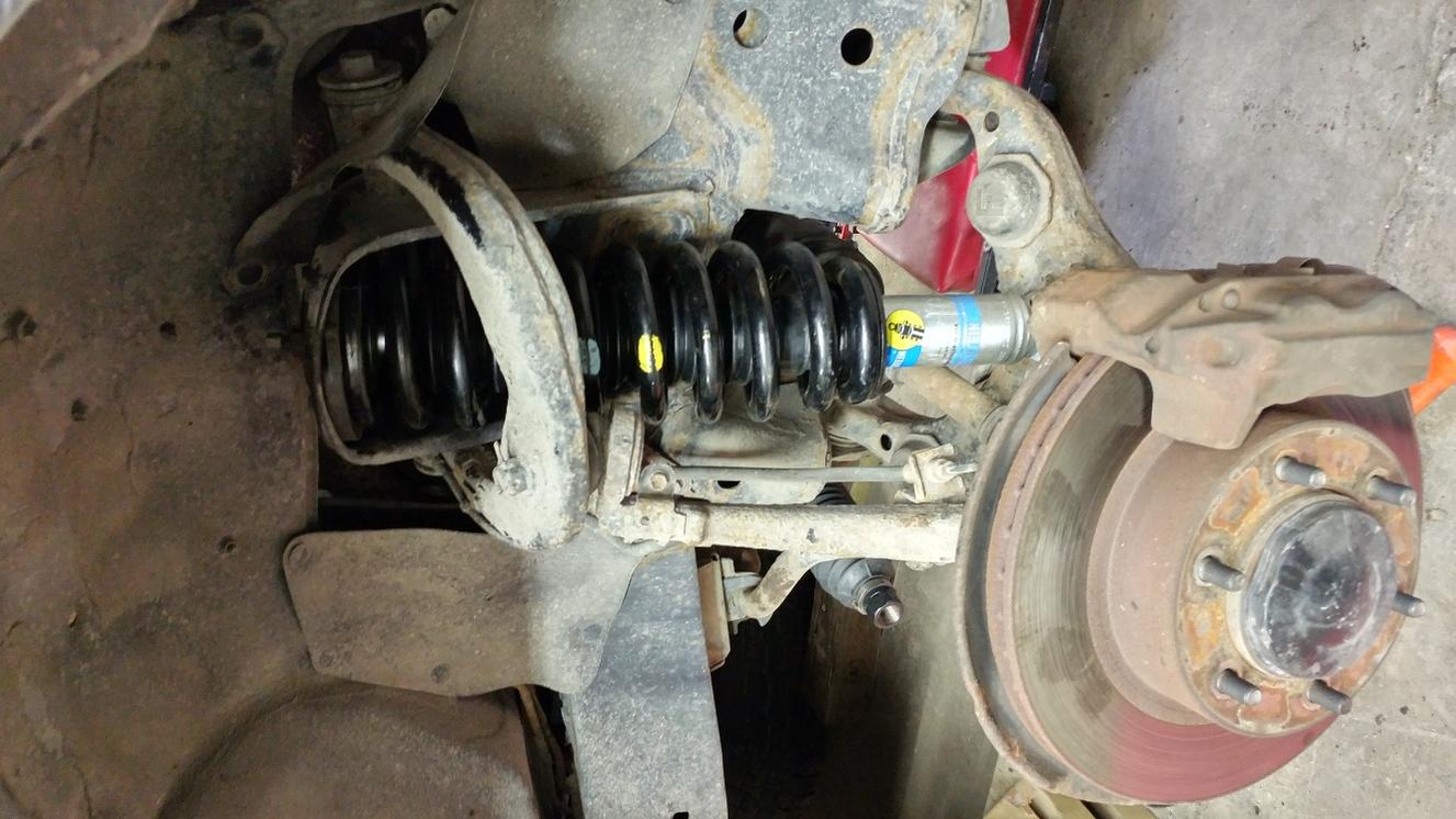

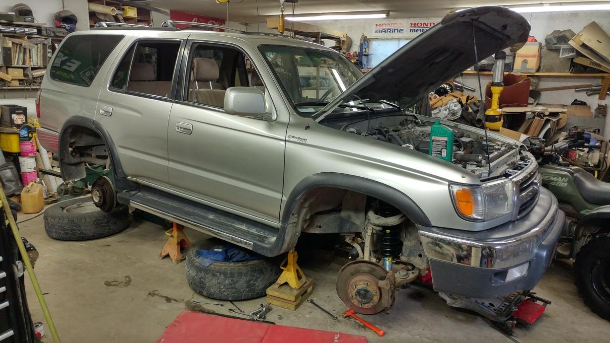

Didn't do much... today.
Recently replaced steering rack, all tie rods, and re-sprung the whole rig.
Drives much better!! Had huge cabin gear haul yesterday, and truck is solid, for once.
