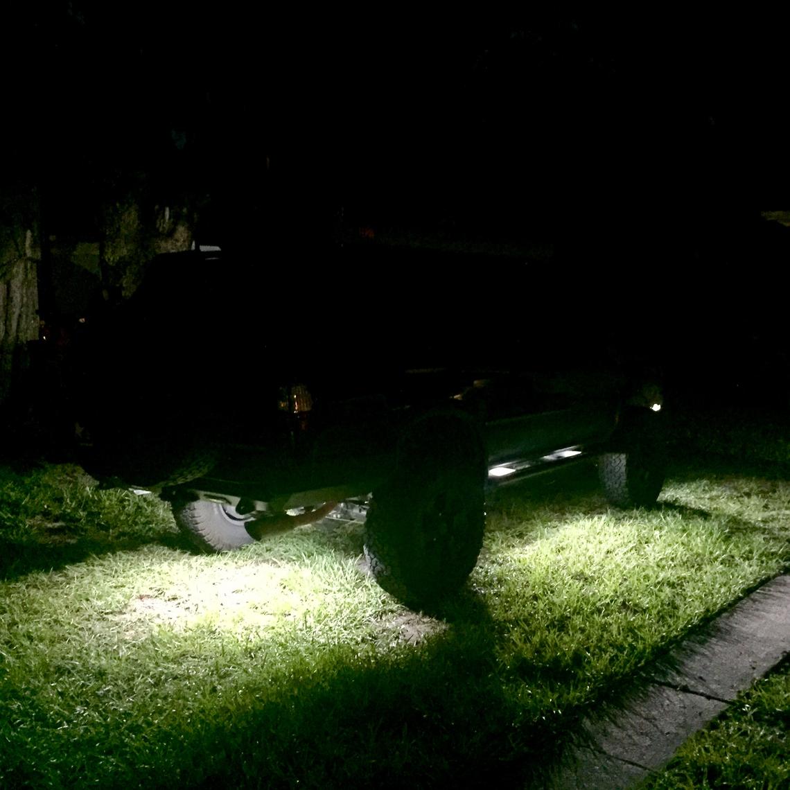

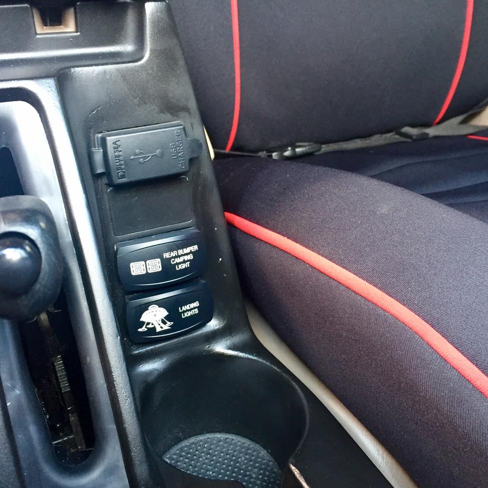

Lux Lighting System rock/courtesy lights are AWESOME...wired to OTRATTW DPDT switch selectable for door trigger or "on." Installed in Brilliant style modded console. Really is a nice upgrade in terms of creature comforts. Kinda seems like these and the courtesy floor lights I previously installed always should have been there.
FWIW, anyone else adding switches to this location might consider lower profile and/or push button style switches as I do occasionally bump a switch with a water bottle. Rare now as I know to be careful but a slight annoyance.

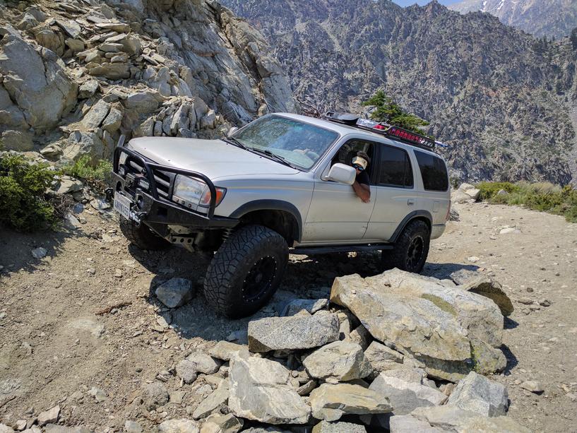

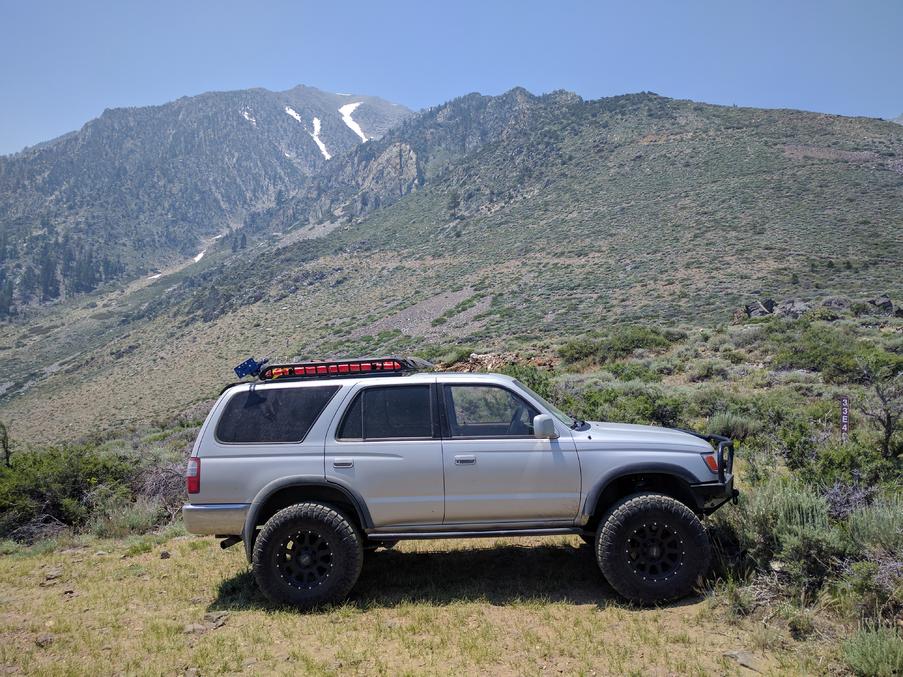

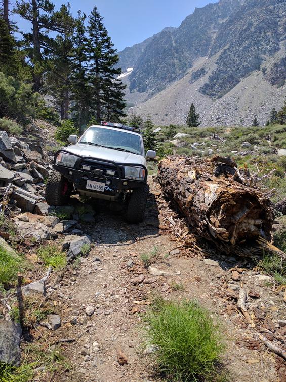

Just got back from a quick run up Armstrong Canyon. It's one of the lesser traveled trails around here and true to form I saw no one else on trail. Pretty cool for 4th of July weekend.
It's about nine miles of dirt from where you start to where you end. The journey begins at 4000' and ends at about 8600' according to my GPS. It's a fun trail with no major hurdles until the very end. The last 1/4 mile or so has just enough technical wheeling to make the trail something I'd do again. It's also got one of the coolest campsites I've seen in the Sierra. You are in a large pine stand that is perfectly flat and it overlooks the Owens Valley.
I went up to check out a few "small" crags that you can see from 395. They ended up being about 700' tall. I'll be back towards the fall once it cools off to get some climbing done on the largest one.

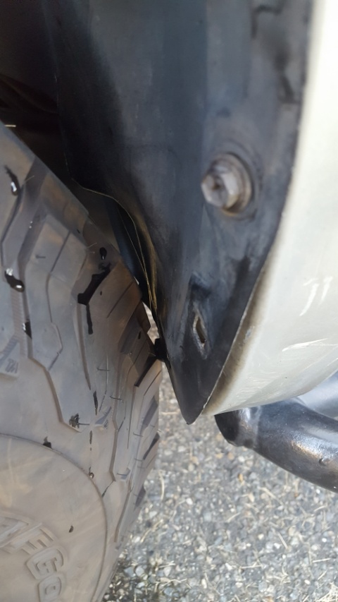

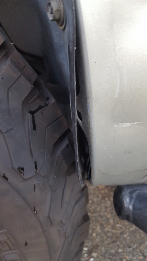

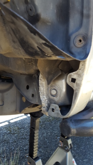

Pinch weld delete = no joy.
Well I tried. I thought that I did a good job pounding the weld back after bending it towards engine like [MENTION=116387]Unner[/MENTION], but even after using a heat gun to remold plastic wheel well liner, my 285s are still making contact. I did have to break a couple of those evil plastic retaining clips.but even still, when wheel is fully turned, it is making contact.
I have SPC Light Racing UCAs, so there is a chance to try to correct by finding a setting to push the wheels away from the firewall. I have not messed with those too much because I need to throw my winch (steel cable) on up front and see if I need to raise the coilovers up a bit, and I don't want to keep getting alignments to sort it out.
What am I missing

I still had contact with SPC arms and 881's upfront, with Tundra 5100's on the 4th perch. Finally got down to measuring for drivers lean, my rig is also a 3rz so 150 lbs lighter then stock 3.4 trucks. I had a 3/4-7/8" bias to the passenger side lean. Added a drivers spacer on the front strut and 10mm puck on the rear and my clearance is beautiful now.
Point being, how much are you lifted? I am probably 3.25" front and 3.5" rear now. Truck has a very slight rake and SPC arms set to neutral (0* setting) with plenty of clearance on BOTH sides now.
