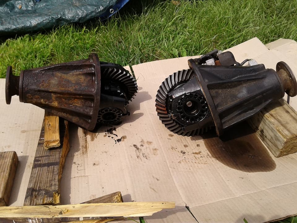

Working on this. Both diffs removed! :rockon:

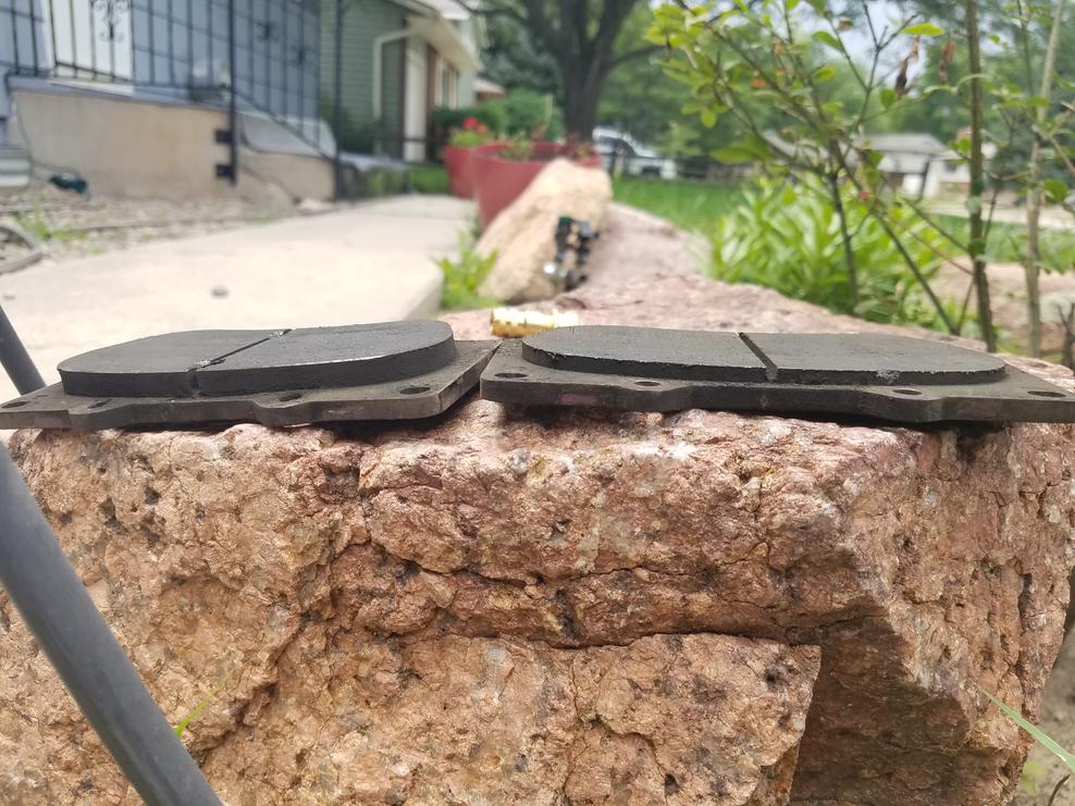

Installed some new OEM brake pads to finally get her completely ready for Moab. Found I have either sticking caliper or matter cylinder issue. Pads but wearing evenly driver to passenger.

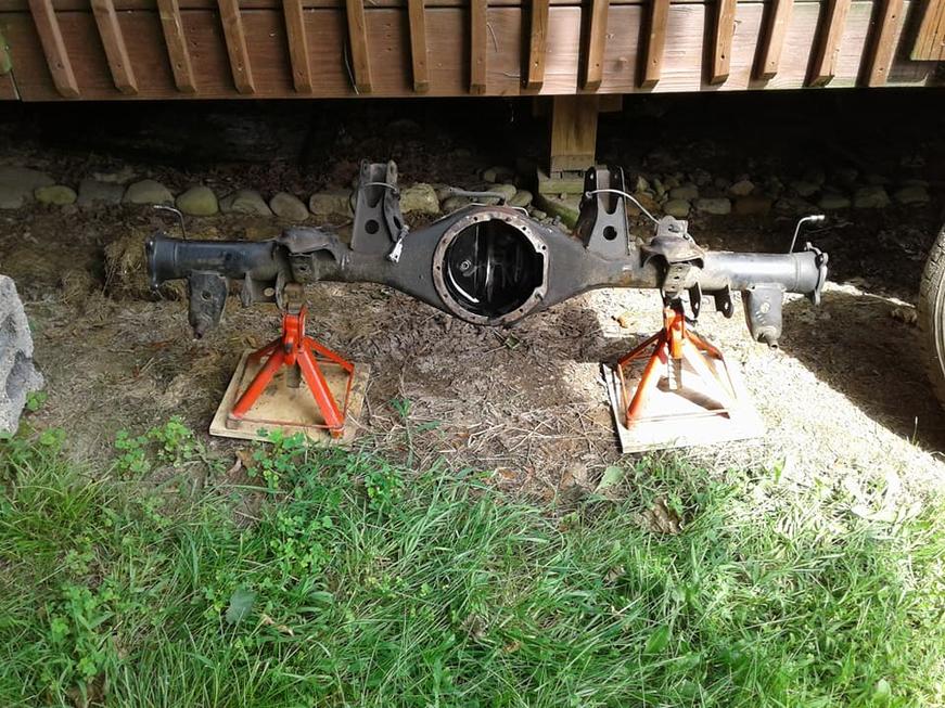

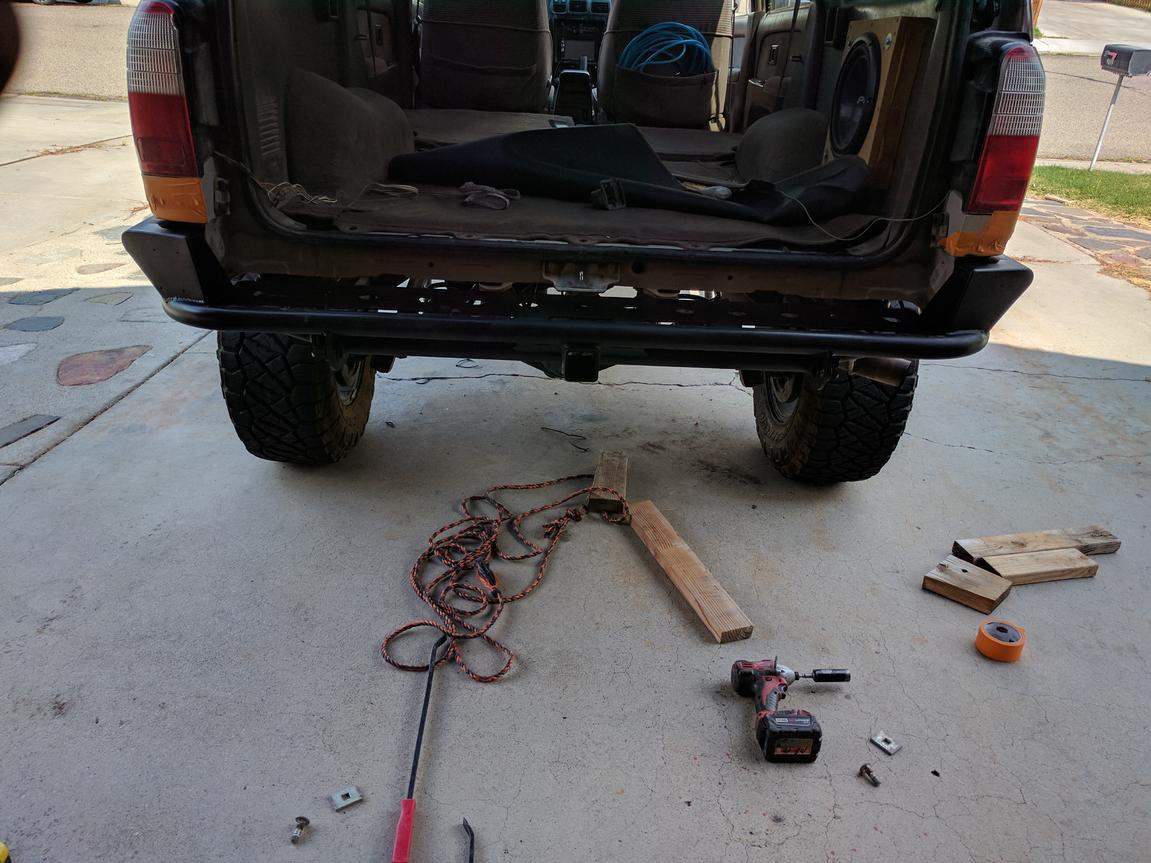

Also finished up installing brothers rear end that got bent from hit and run on his 4th gen. That was a PITA.

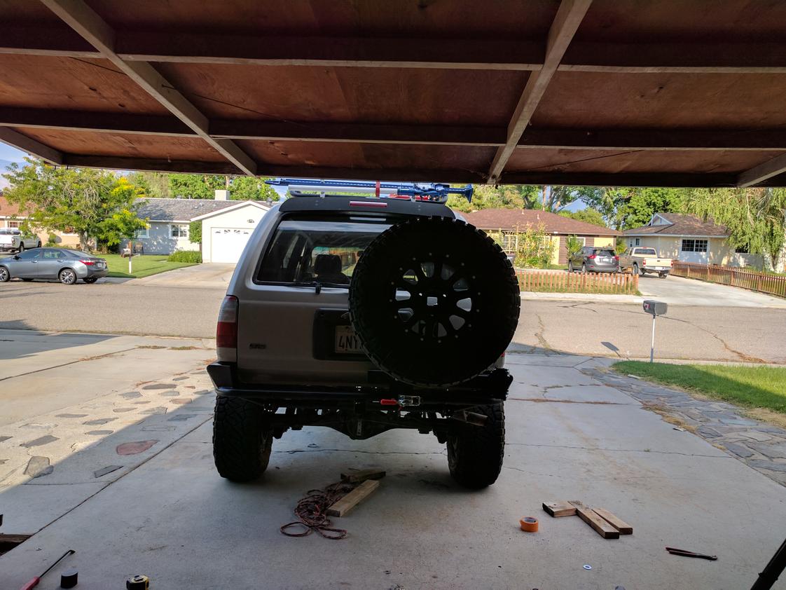

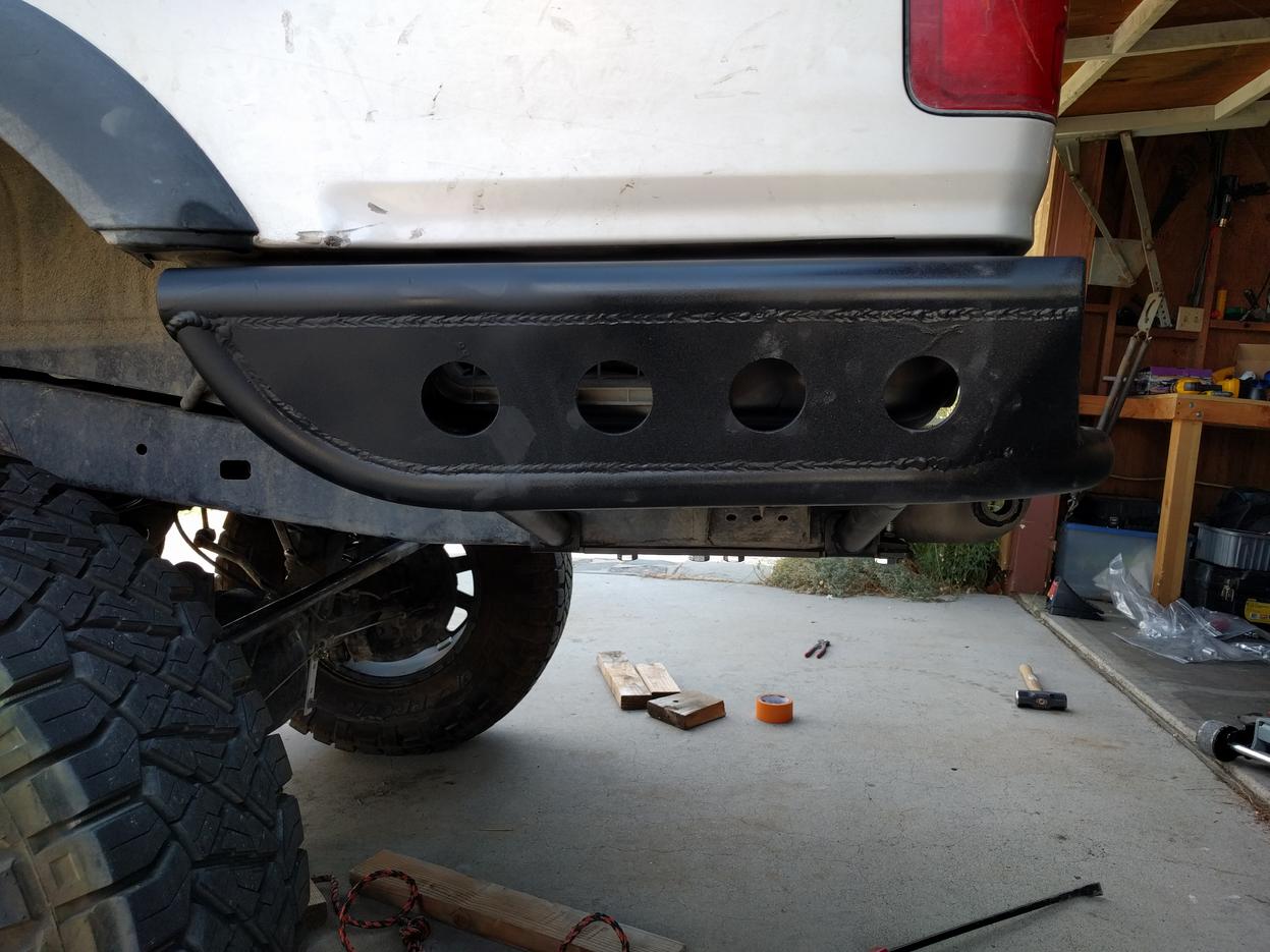

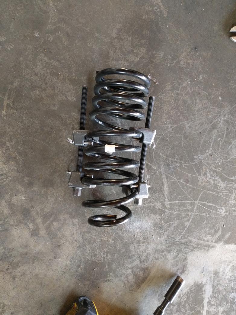

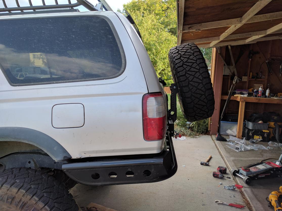

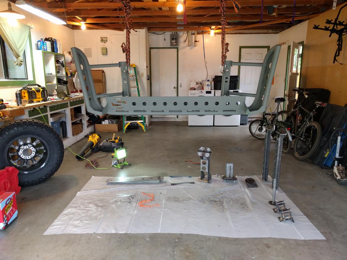

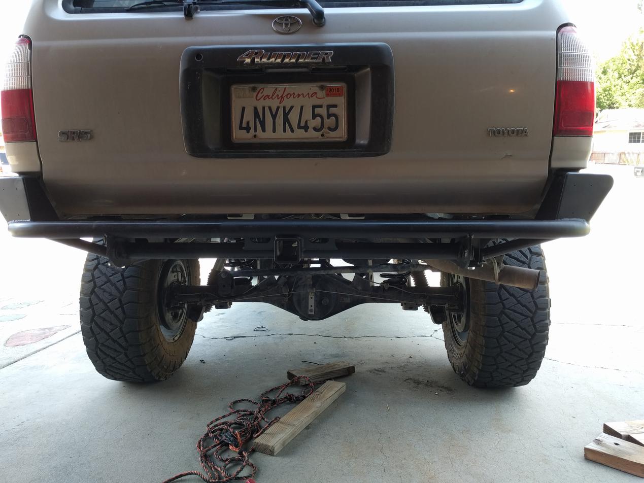

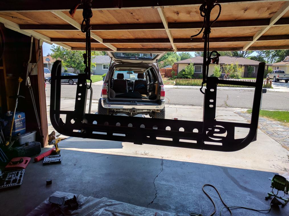

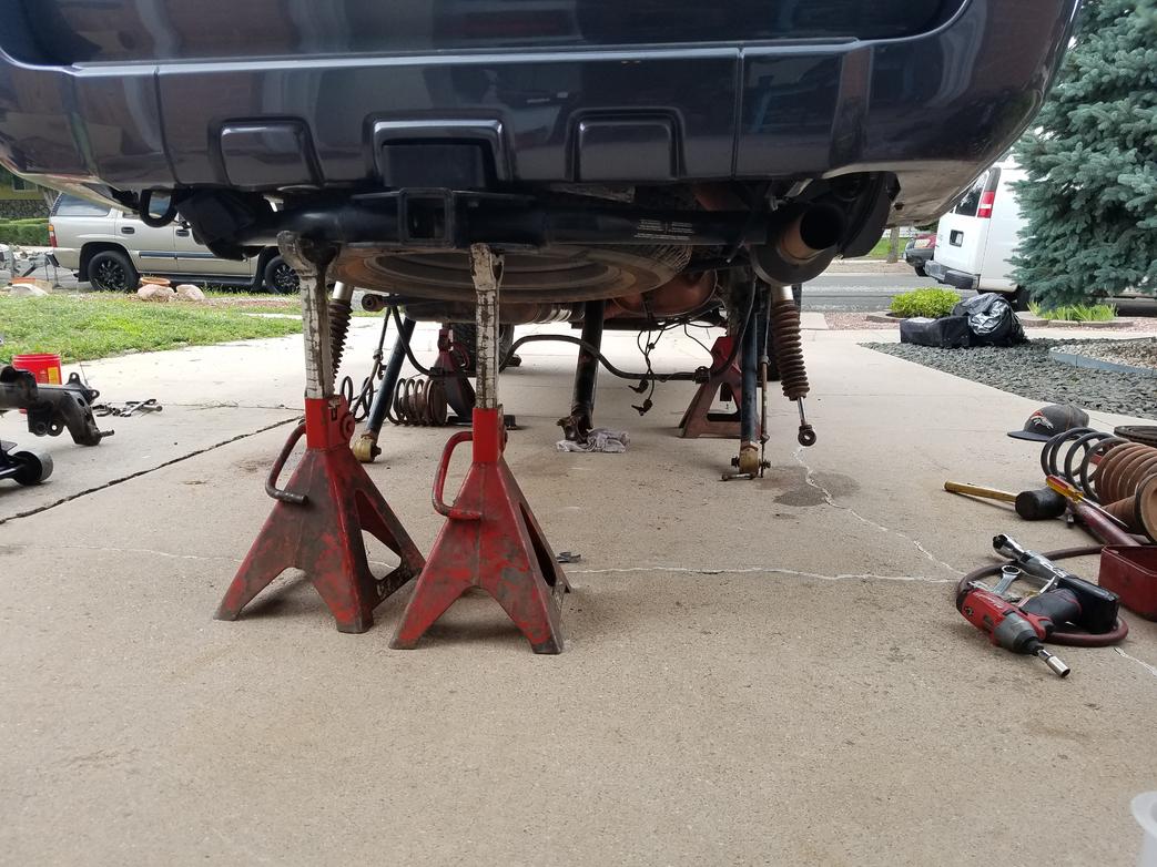

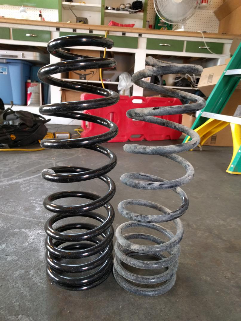

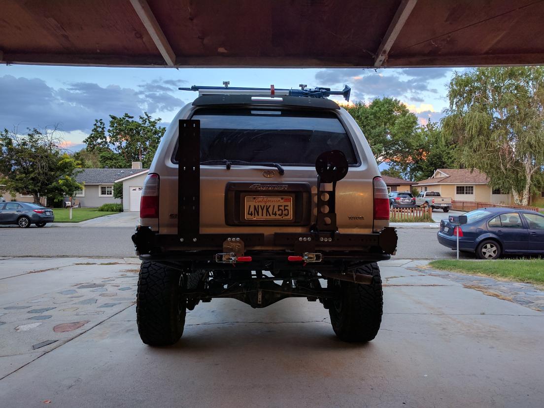

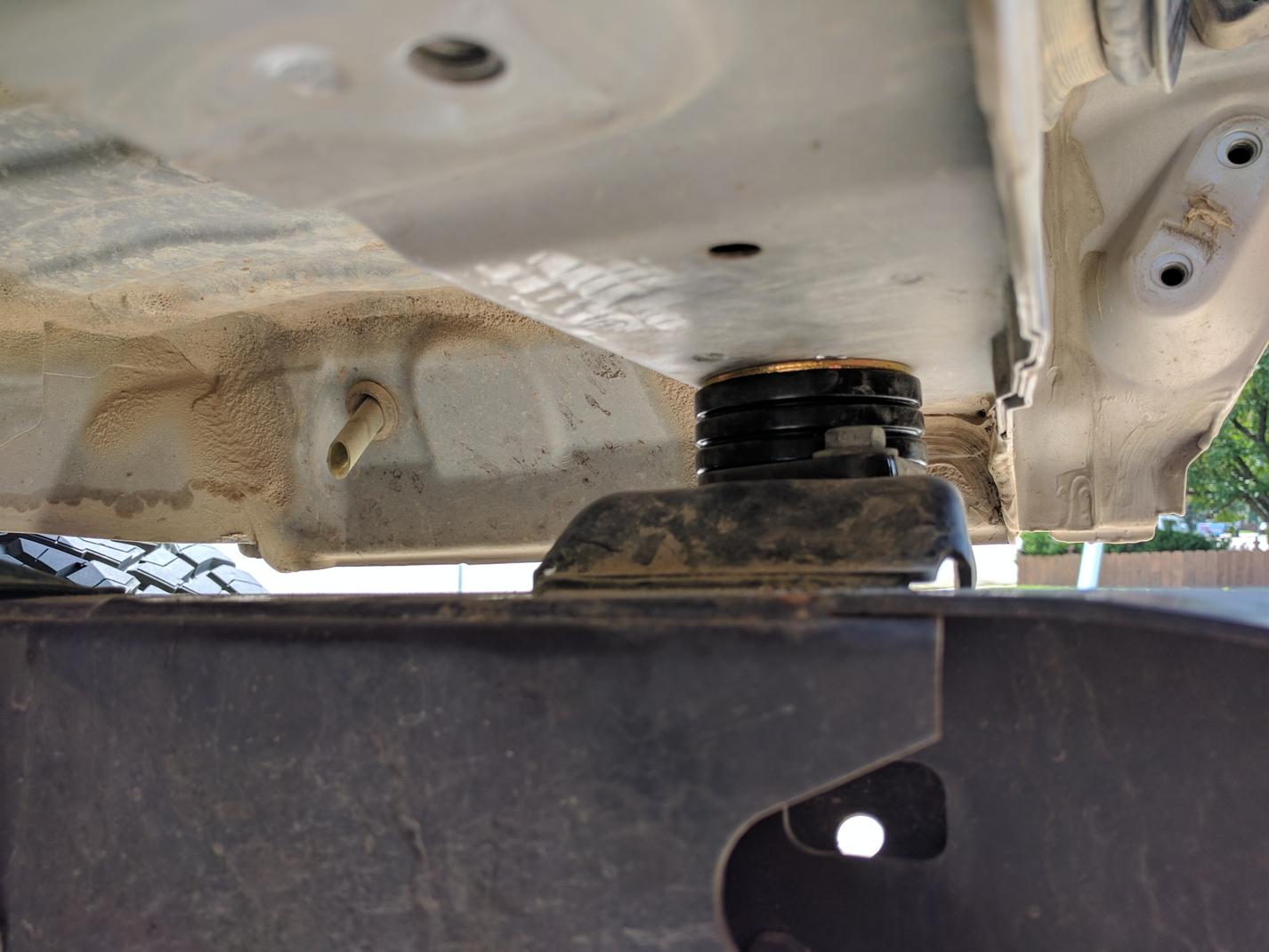

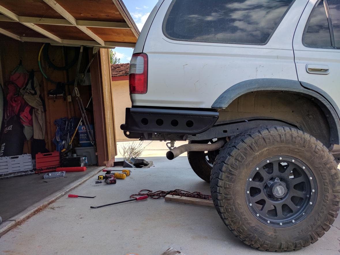

Today was a good day. Painted the Savage bumper and swingouts. Knocked out the SS rear body mounts. Removed my old Toytec 3" springs and installed the ARB 861's. Mounted the Savage bumper. Mounted both swing arms.
What can I say about painting? It sucks. The whole time I'm thinking of things that are worse just to keep my mind occupied. I couldn't come up with much. lol
[MENTION=119532]Road Bull[/MENTION] With the rear bumper off those top bolts for the body mounts where super easy. Don't know why I even bothered to try with the bumper still on a few weeks ago.
[MENTION=116387]Unner[/MENTION] I tried your way for the springs on the drivers side. Then I used the traditional way on the passenger side. I timed both from start to finish and tried to be as non-bias as possible. Getting the compressors to fit is a huge PIA. It's like a jinga puzzle. I managed. Got them out and wriggled the 861's in. BTW, your way with compressors 58 minutes. The old way of removing tire, removing shock bolt, removing upper rear control arm bolt was way faster at 36 minutes. I'll stick with my way but thanks for the tip.
Savages bumper installed with zero issues. It was kind of a PIA to do solo but I can be stubborn like that. I hate to ask for help. All bolts where there in the correct count, everything lined up with zero hammering, and it looks bad ass. One of the easiest after market installs I've done, so thanks Savage.
I need to order the rotopax mounts and a few other lugs so I can actually mount the wheel. I also need to finish putting the plate holder on and mounting the struts. Then fine tune the swingout helms but that's an hour at most.
Overall I'm stoked to have this completed. Especially that damn painting, lol
