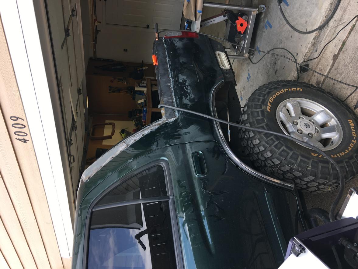

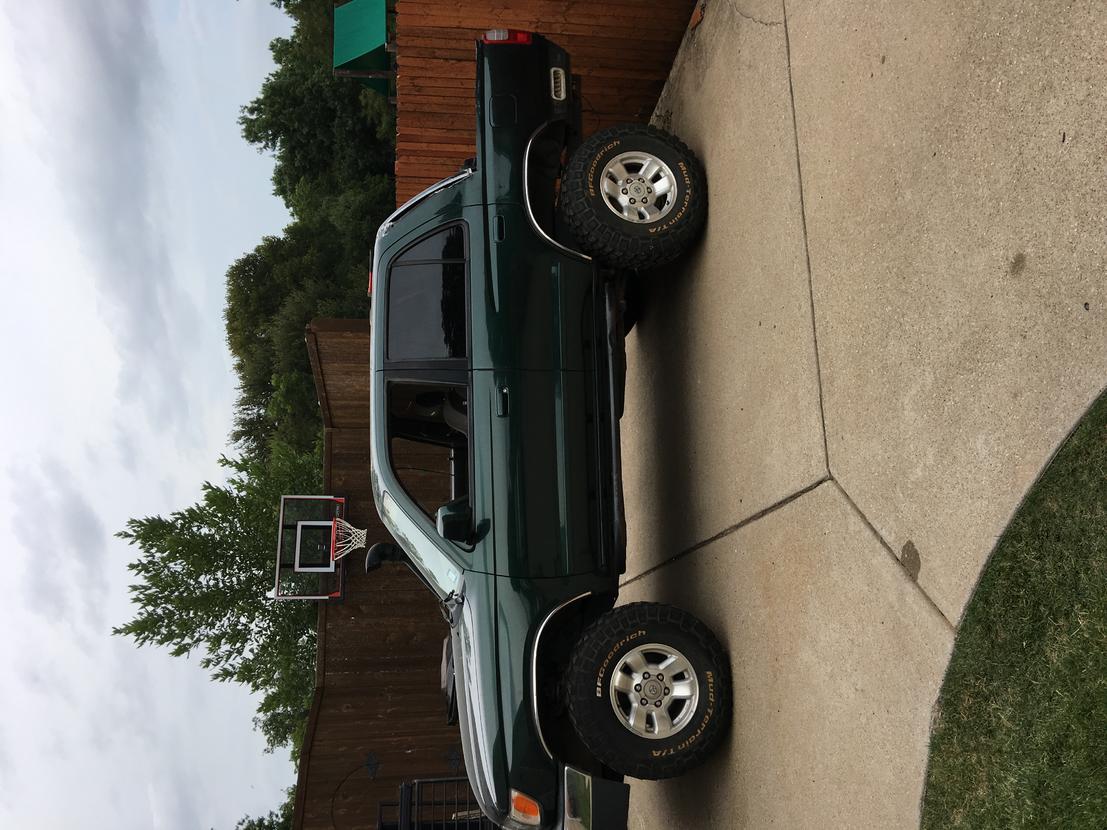

Finally did the chop.

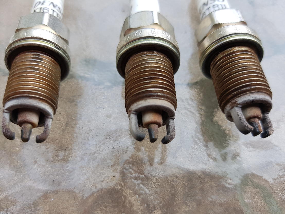

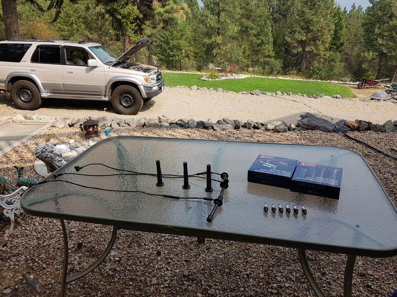

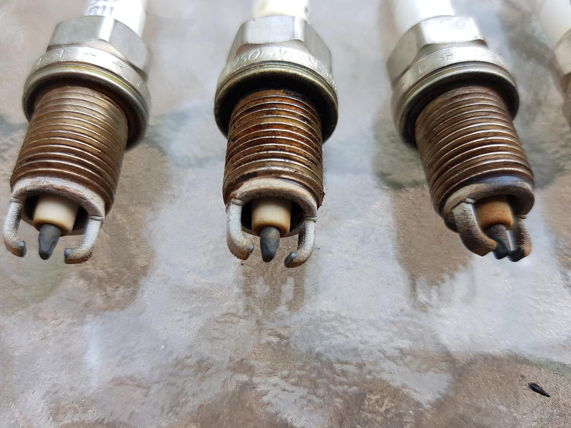

Maintenance day
New plugs , new wires and new coil boots .
Was long over due too , these Denso's went 159,000 Km's :becky:
If it doesn't rain today , new AC , Power steering and Alt belts and the running boards will come off today

You got yourself a 5Runner!
More pics please - there's someone around here who chopped his 2nd gen but I've never seen a 3rd gen done before.
It actually went together pretty well. I even got to use the roof section I cut off to make a sunroof delete patch.
