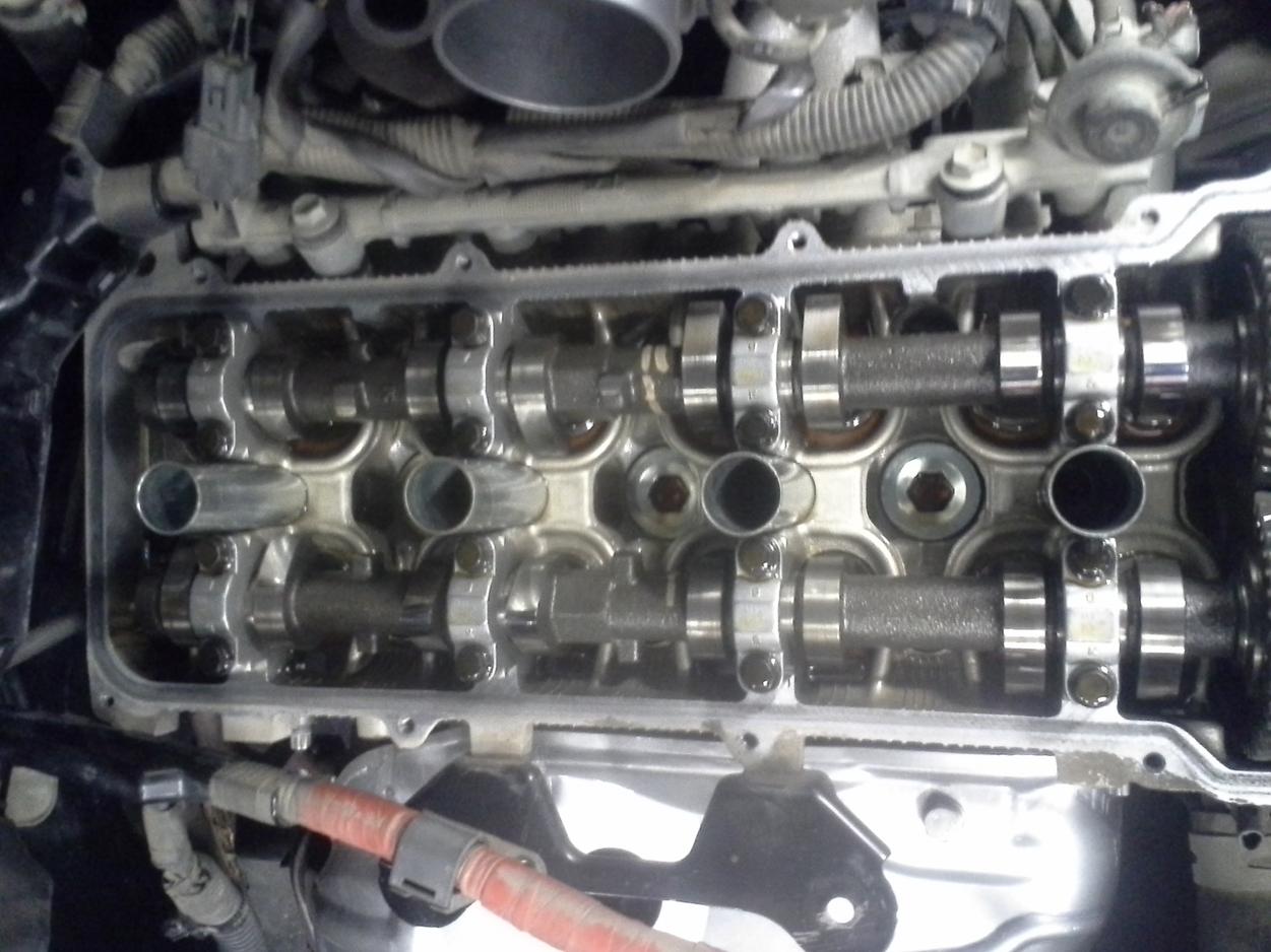

3RZ valve adjustment started. Opened her up, measured clearances then measured shims where needed. Then put it all back together. Now to order new shims next week.
I checked it 4 years ago at 130,000km and all were in spec. but one exhaust was getting close. Now at 180,000 km that same valve is 0.001 tighter and is now a .010 and so now needs addressing. I'm actually going to adjust all the exhausts to the looser end of the spec.
In 50,000 km all exhaust valves are now .001 tighter than before, FYI.
