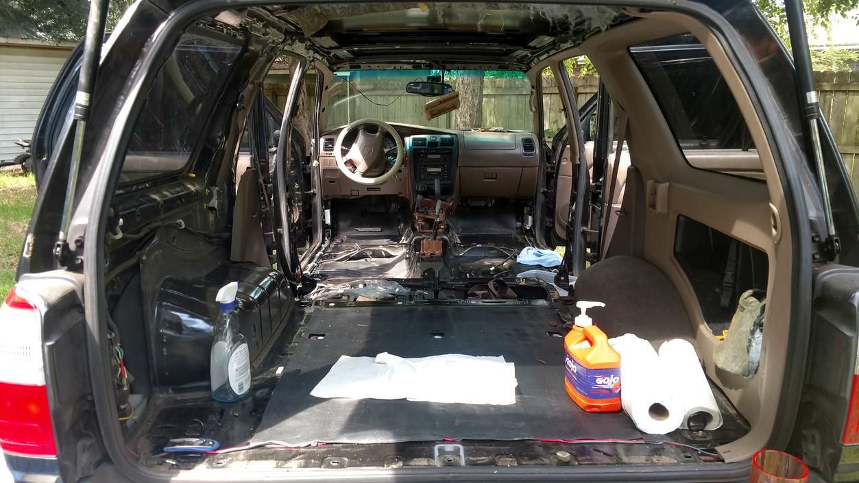

While working on sunroof, tarp evidently blew off during a thunderstorm. or course this is while we were at the lake. and with 95 degree days and 85% humidity mold set in quick. we were already deciding about pulling the carpet and cleaning anyway so this made the choice easy. now to decide if we are going to clean or replace. Brother works for a disaster cleaner. sprayed down the interior with a sanitizer. IMG_20170820_150637593_HDR.jpg
at least starting with a clean slate
and yes the sunroof is reinstalled and seems to be keeping water out.

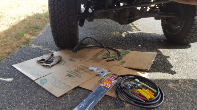

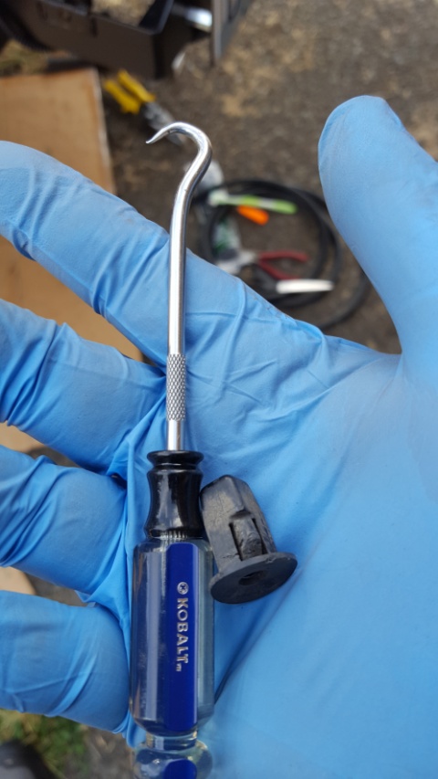

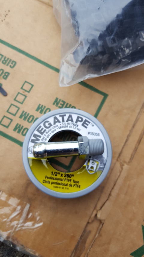

Finally did my rear diff breather mod today.
First I want to thank [MENTION=120071]mtbtim[/MENTION] and company for great write ups listing part numbers and helpful tips for making mods like this easy to tackle. I had to rush a little bit because I had to get to work so I didn't grab that many pictures of the progress as I was going but I did get it done. And somehow I managed to remove the gas filler guard without destroying those evil little Toyota plastic clips. The tool I had handy made it doable. Otherwise I would have just used zip ties and been happy with that.
I still have some plastic ties to snip and double check all my work before buttoning it up tonight after work. I will put a bit more in my build page when I finish.
Instead of getting the clips out you can also pop the gas filler cover off them, leave them in place and then use course thread screws like the front fender trim uses (they screw in to those same clips which hold the fender liner on) and place the cover back on top of the clip heads and screw them in to the clips.
Hahaha. I found this out on the upper two clips. I was able to manipulate the bottom ones with persistent contortions and blue language. The upper two, I was going to write off, as I have a few extra on hand if need be. The gas filler cover popped off and I removed the clips after the cover was out of the way without damaging the clips themselves. Thanks for the tip though.
