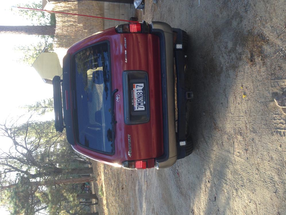

Installed my new 4xinnovations rear bumper. Now just need to find a matching rim and tire.
Looks great. What color did you do the rear bumper in?
Nice mixup from PC black

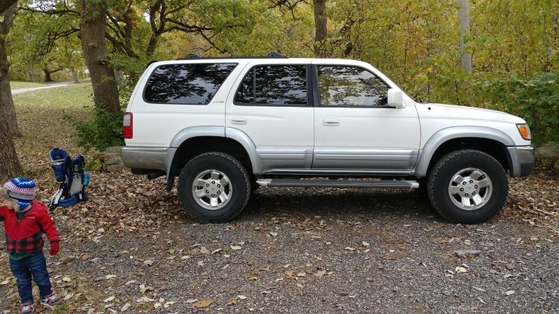

This summer I bought a 97 Limited, 4x4, basically stock and in dire need of maintenance.
I picked up some OME 891's from Wheelers and Skyjacker BlackMax 8500's from Summit for the rear. Also grabbed some Monroe quick struts from RockAuto for the fronts. The old shocks and struts were well worn, put on by previous owners many years ago.
I gained 2-3 inches in the rear, but I can't say exactly because I forget what my "before" measurement was. However, height is just a bonus since I'm mostly looking to increase payload capacity.
In light of this extra height, I decided to put the running boards back on, since my wife (5ft tall and pregnant) and 2.5yr old already struggled entering the truck. I felt like they looked too suburban before, so I slightly altered them by taking off the plastic fairings on the ends and it turned out more appealing to my eye. They'll do for now.

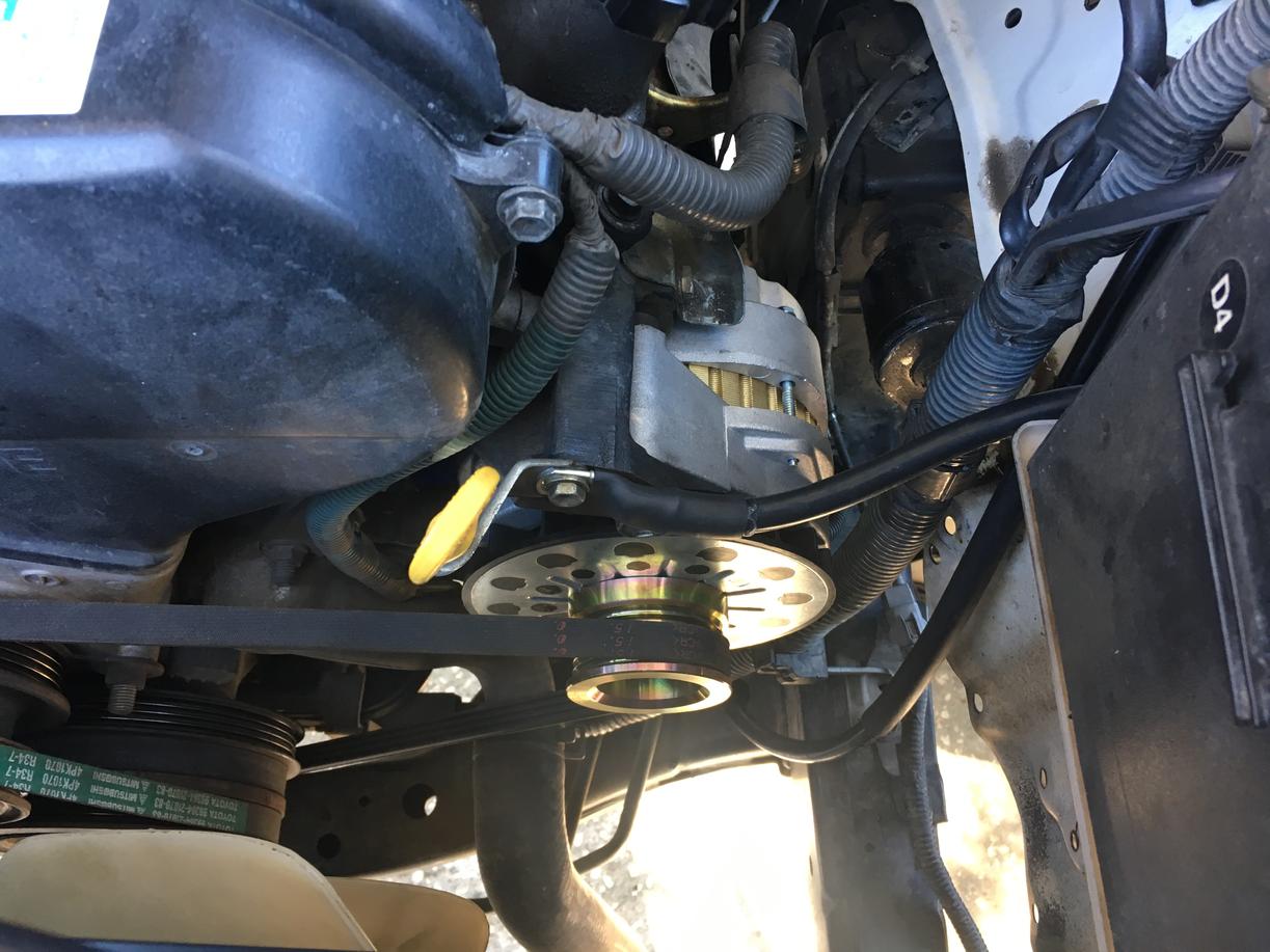

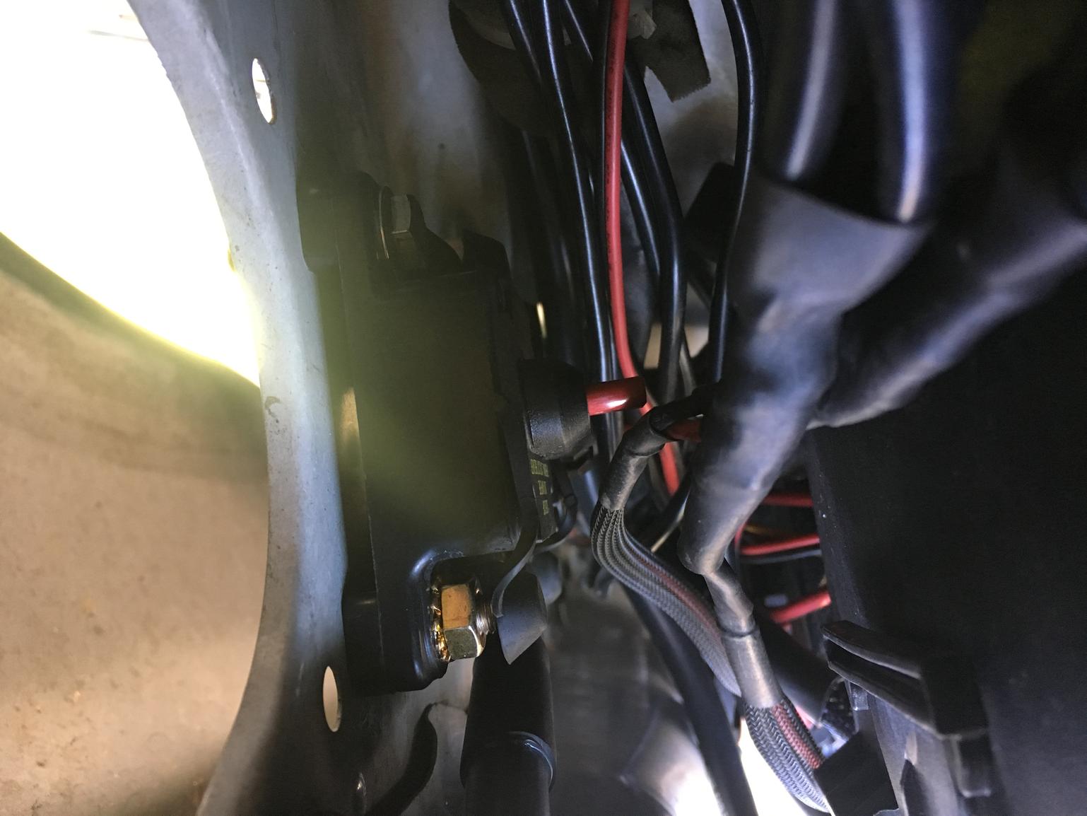

Finally upgraded to the cs-144 alternator and did the big 3 mod also. Was much easier to make battery cables than I thought.
I used the Chevy to Toyota adapter harness that can be found online and instead of stacking up a ton of washers to locate the alternator in the bracket I used a small piece of steel tubing I had laying around.
Cables were made of marine grade cables and tinned lugs from Ancor. Cant suggest this stuff enough. The copper wire is actually the correct gauge as opposed to the cheap wire having a fat layer of insulation and thin gauge copper inside.
Ran a 135 amp breaker between the battery and alternator to protect the truck should the alternator spike too high. (Need to get better pics of where I mounted the 2 breakers)
Next up is to mount my blue sea 12ct fuse block and 100 amp breaker to tidy up the mess of inline fuses I have installed over the years. (all of those wires are wrapped around the factory fuse box for now)

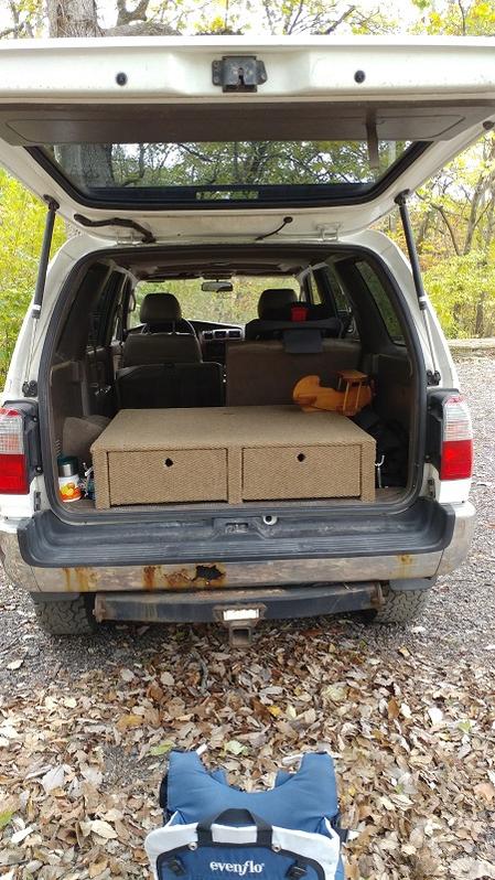

After all of this I got the Kicker CX600.1 amp installed for my Kicker 43TCWRT102. Got the amp to fit under the back seat where the jack and spare tire stuff is since I can no longer use them anyway.
And of course when I finally get the sub delivered and installed. I fire up the radio and it doesn't work... :doh:
Replacement woofer should be on the way soon and we will be back in business.
Added some more sound deadening to the floor around and in the cubby under the seat while I was at it. Now just have the doors and maybe the roof left to do.

Are those some modified running boards? They look good
Yep! I had pulled them off, but after I put on my OME891's, I gained
a couple of inches in the rear. The Boy and The Wife (who's 5ft tall and pregnant) already struggled climbing in, so I thought I should put them back on. I didn't like the look, but realized I could pull off the fairings on the ends and I like how they turned out. I'd really like them to come down another inch, but who knows if I'll ever get to making some lowering brackets.
