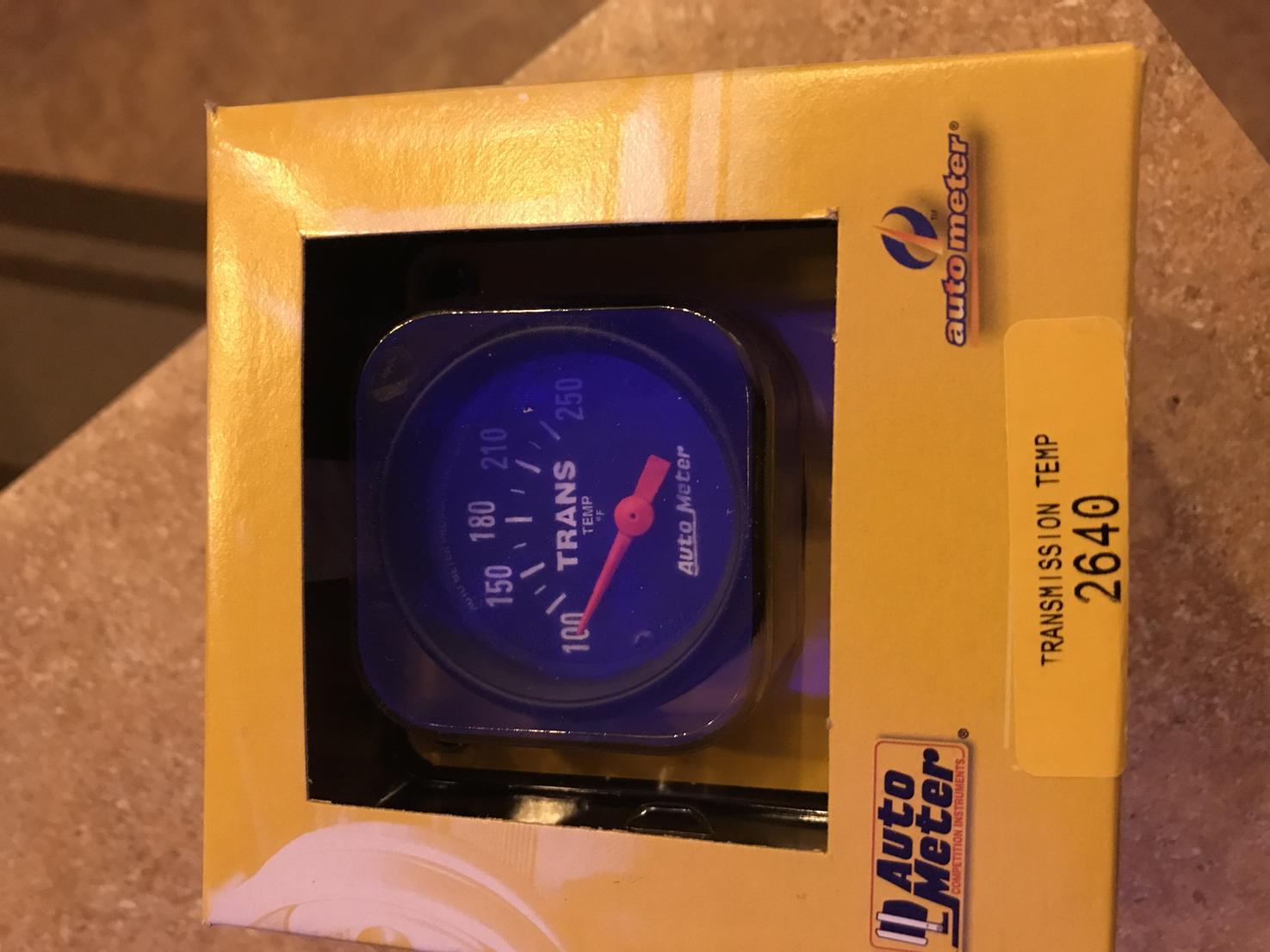

Are you mounting on the pillar or center console? Do yourself a favor and skip the red and green light caps. The whites not bright at all at night.
I'm gonna be putting it just above where the tcase shifter is so it's not completely in my face but easy to see if I want to.
And thanks for that, I peeked at the light earlier and was like holy shit that's a small light!
I debated where to put mine and ended up mounting it on the pillar with there pillar pod. It's not that in your face and it's easier for me to keep an eye on it there. Now if I could only teach my wife to look at it and understand it. lol
I also put in an after-market cooler at the same time I wired it and never see temps over 175 during summer. Today was in the 50's and it never got over 150 in my 40 mile trip to work.
That's a solid place to have it also. The pillar will have multiple uses if you ever decide to get a supercharger :eyebrows: I'm decided to put mine down by the shifter because I have my ScanGauge located just under my head unit in the dash so it's all pretty close to each other.
I also have a external cooler that bypasses the radiator completely, so I'm hoping for temps around that as well. Did you bypass yours?
I ran it in series with a new rad. Since the rad was new I wasn't worried about any milkshake scenario. I wheel enough to want to have the cooling capacity of both. I also added a 7" electric fan to the after-market cooler that I can kick on when going slow.

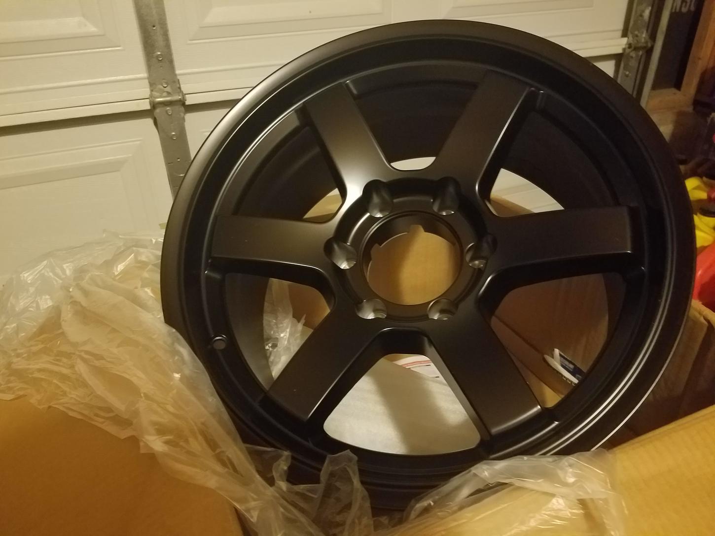

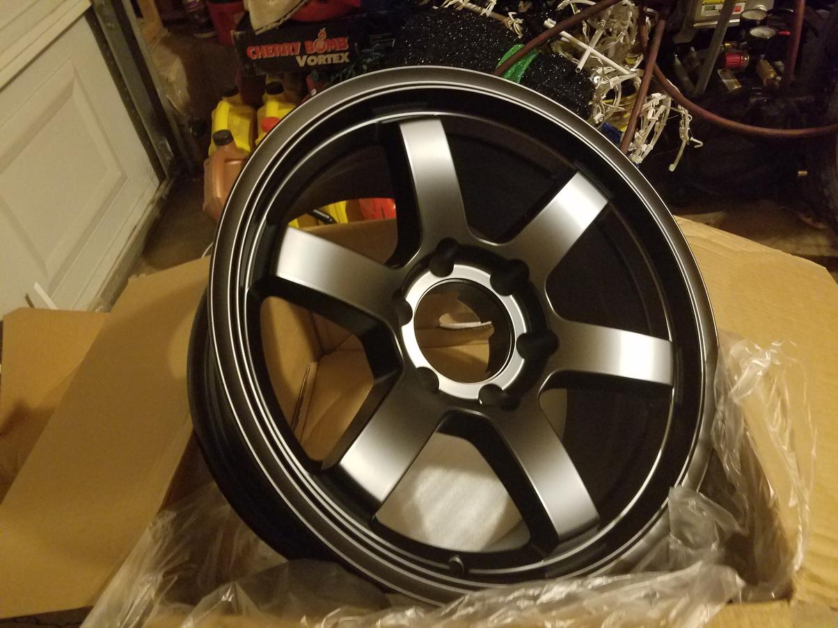

Ups just delivered these beauty's. 930pm and they still had a full truck.
Level 8 Mk 6 17" x 8", - 10 offset in matte black. $480 shipped after rebate.
Too bad they are going on wife's Tacoma. Sad face.
