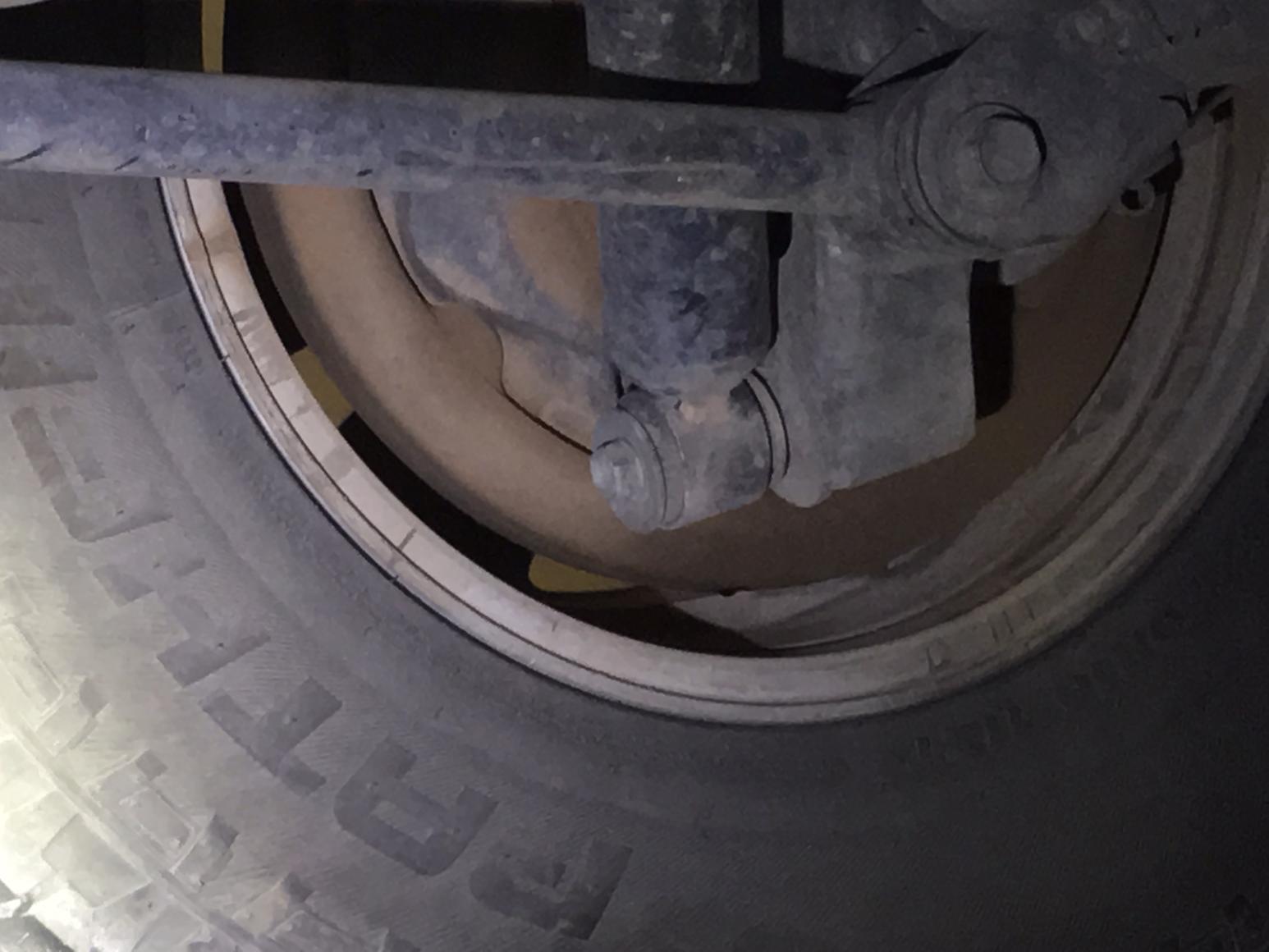

Since I'm having a suspension day/weekend, I looked at the rear drums and saw that one of the shields was rubbing against the drum. So I straightened it out a bit (sorry for the crappy focus).
And since I can't stand looking at rusty drums through the wheel slots, I hit them with POR15. Came out pretty good I think!

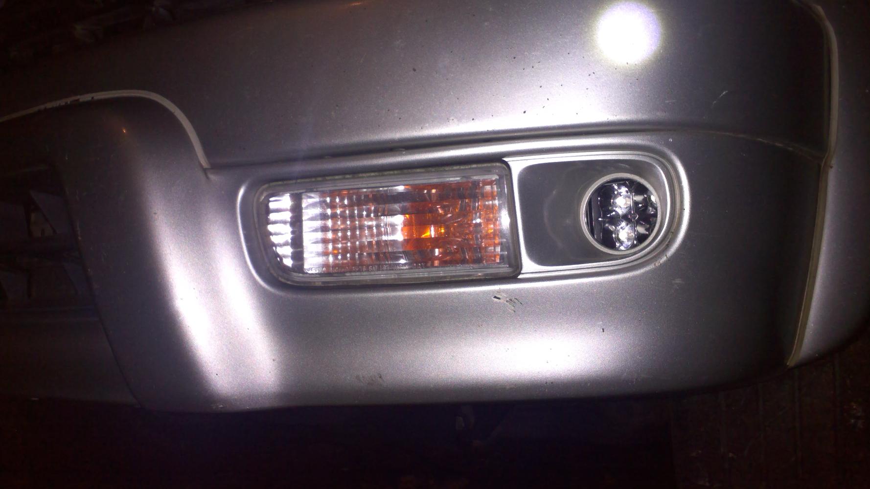

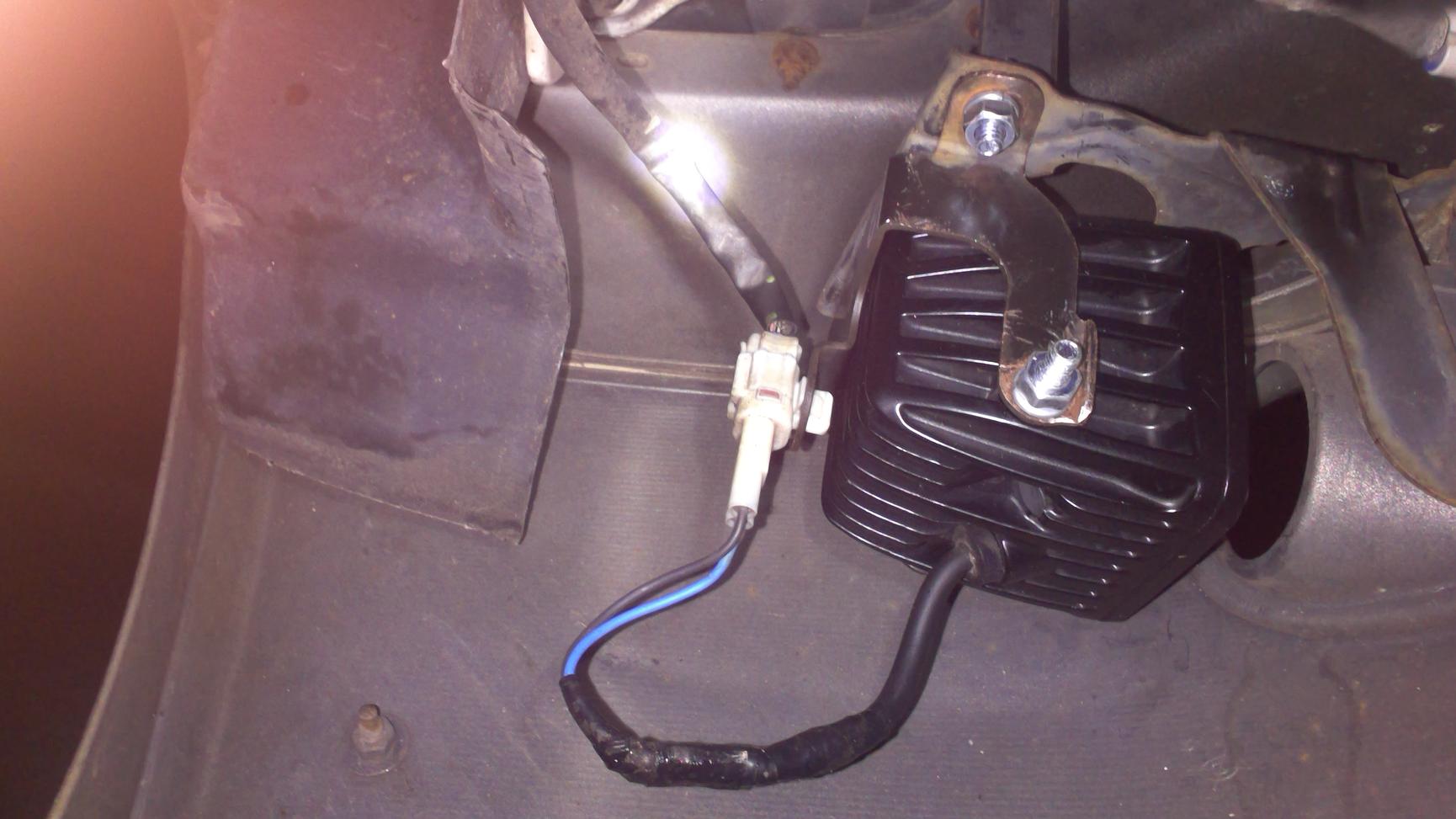

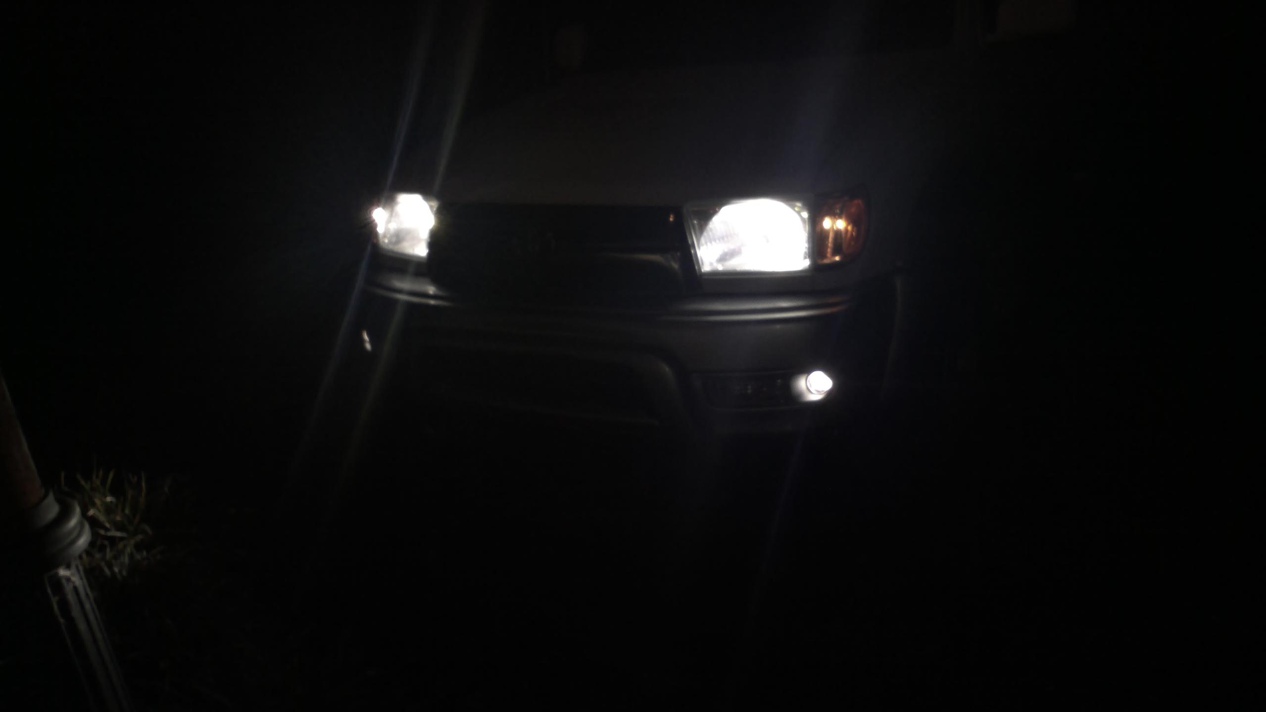

I replaced the OEM fog lights with light pods. I was given two Rigid Industries 2x2 light pods, and they fit perfectly in the OEM brackets. It is amazing how everything went together perfectly and I am surprised at how well everything looks. The lights are probably brighter than any purpose-built fog lights or OEM replacements. You can wire it up nicely, and the best thing is that you don't have to add switches on the inside of the car, the normal fog light switch still works. Highly recommended.
