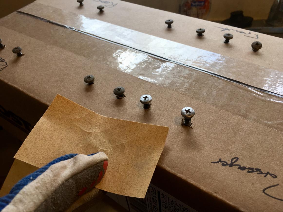

Decided to clean something weird in the 4Runner, so I pulled out all of the visible trim screws and sanded them with 220 grit sandpaper before (and I'm prepared to take shit for this) spray painting and clearing them to match the wheels. Here's a midpoint shot to show you how nasty/crusty the screws were vs. the two sanded ones. I'll upload more pictures of the finished product so that you can have a good laugh.

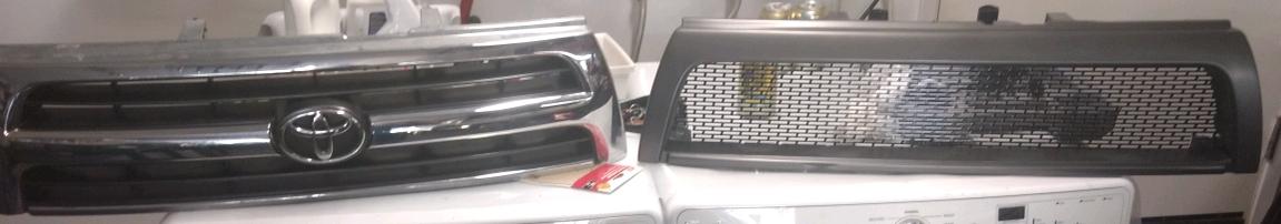

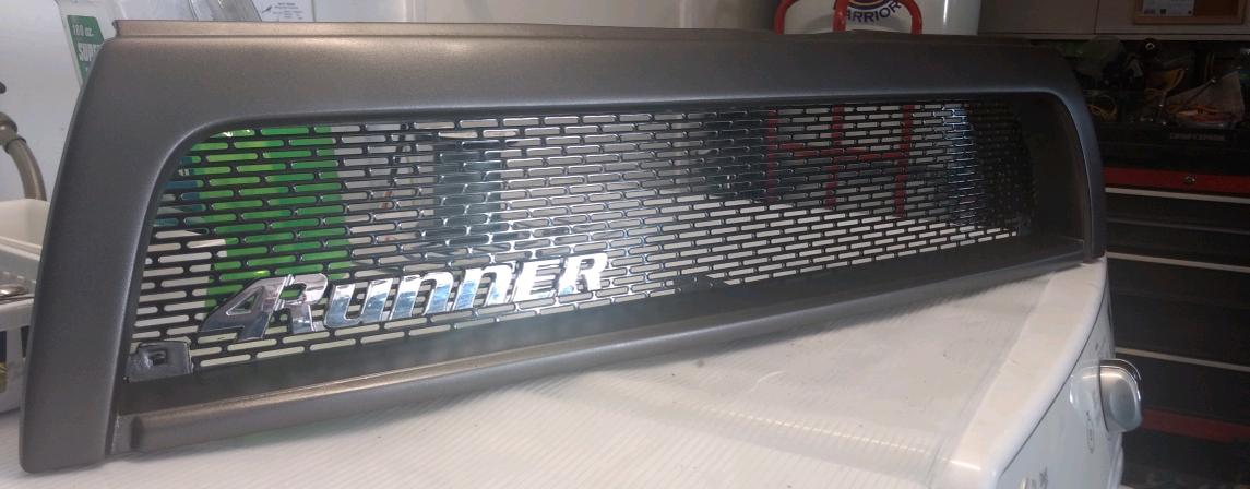

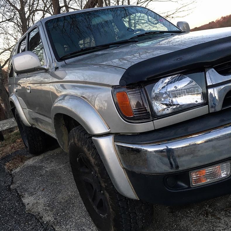

Finished my Satoshi. I think it came out good for my first Bondo and painting project.

That looks great! Any link to a DIY you followed? Also what exactly did you use for the grille/mesh part? I want to do this asap now that my headlight HID conversion is done. Thanks

Are these the sill plate screws? Mine are all corroded too, it's on my to do list to paint them. Thanks for blazing the trail.

Thanks! I used the customcargrills.com YouTube video and pre-cut mesh from their website. Its not as cheap as using mesh or gutter guard from HD, but I'm happy with the result.

That’s perfect. I’ll order that asap as I really like the look.

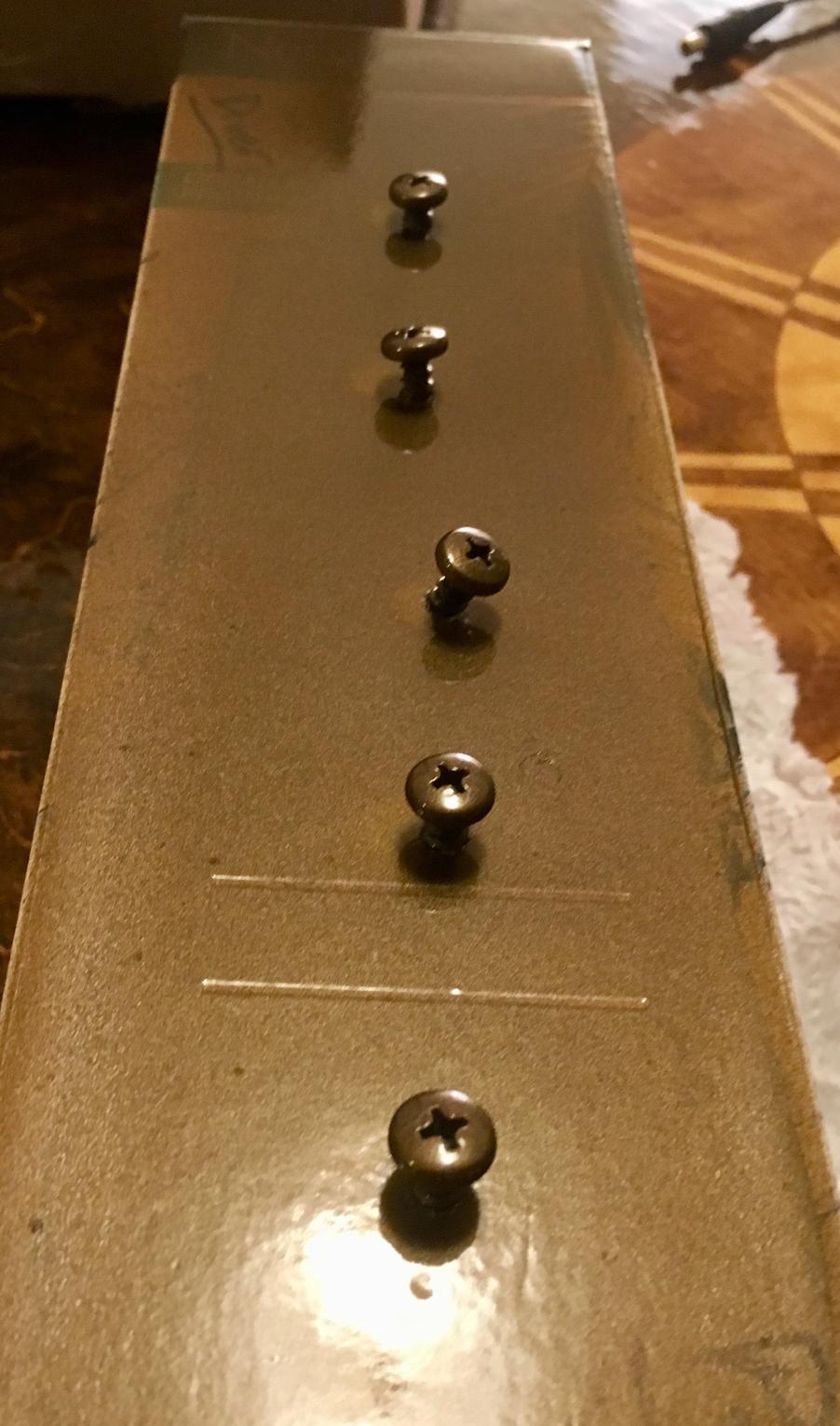

Bingo. Here's what I'm looking at this morning after a quick spray paint last night. Certainly a lot better than they were, but I should have warmed the bottle before laying down the first coat. I'll let them dry for a day or two before reinstalling them.

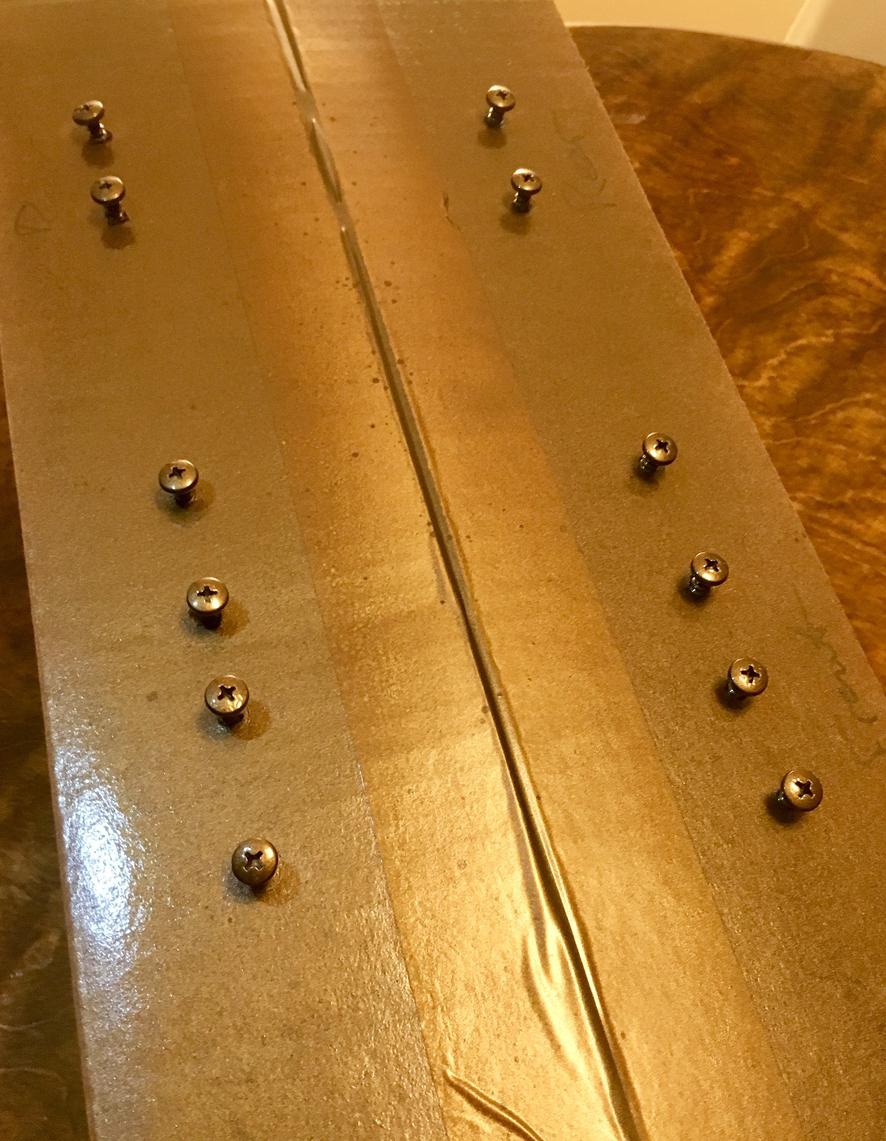

Also did the five rear door sill trim screws to match (same color, different lighting). This is three light coats of primer/paint followed by two coats of clear.

A couple of those have some orange peel. Time to wet sand and polish to perfection! :biggrin2:

I dont think you're crazy, I replaced all of mine with Stainless Steel from the hardware store.

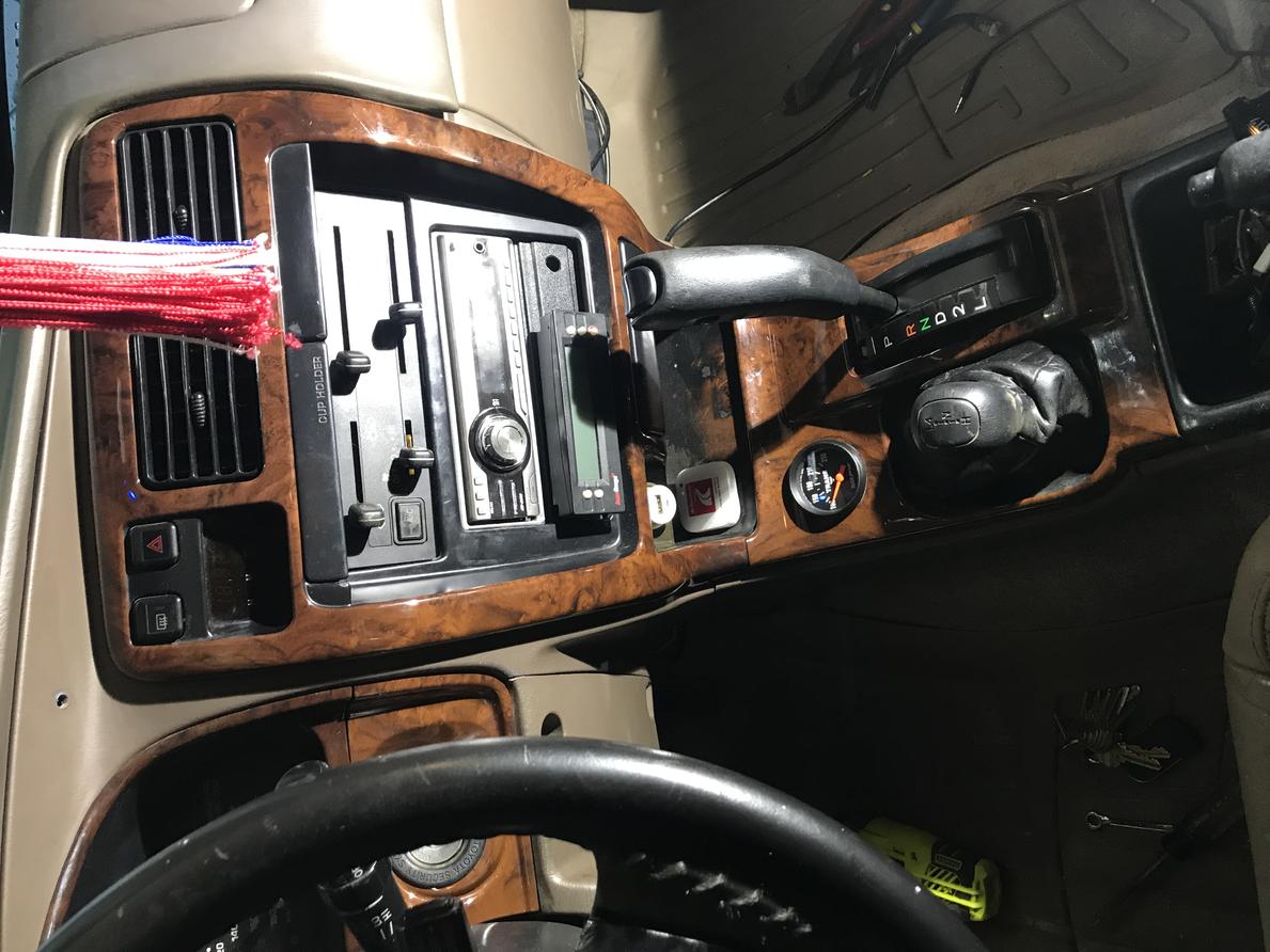

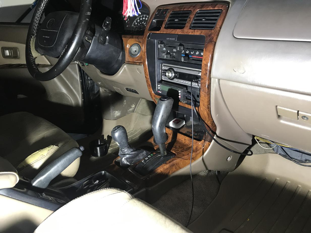

Put in my 99+ shifter bezel and igntion bezel as well as new rear lift struts. Everything trim wise matches, except for my instrument cluster. It's just a tad darker next to my igntion bezel. Now for the cup holder from a 99+!

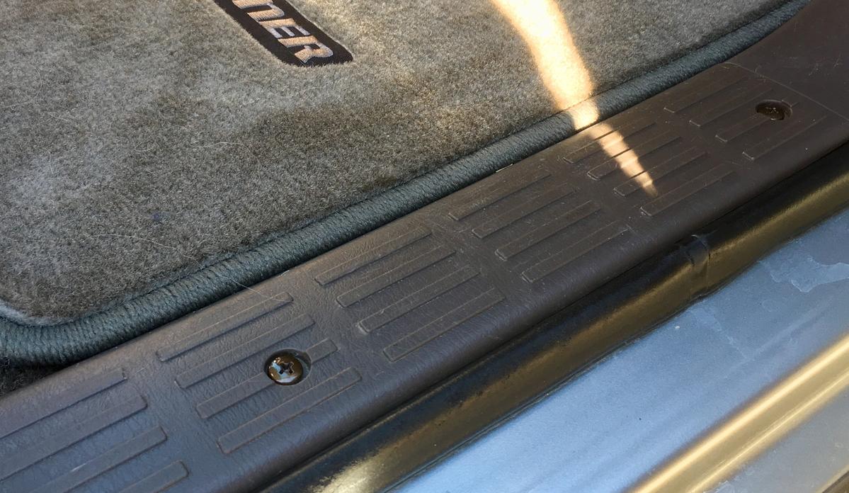

Reinstalled the trim screws (using a latex glove-over-screwdriver technique to minimize scratching that worked really well; would recommend). It's surprisingly hard to get a relevant photo of them but here's my attempt. Overall they do look way better than before.

You're nuts and I love it :). I'll probably do this at some point.

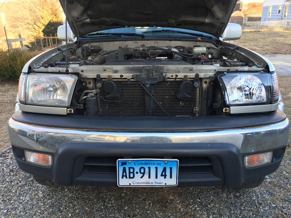

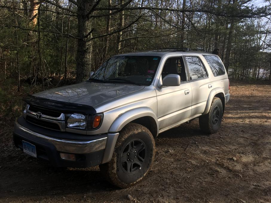

Refreshed the old stock headlights. Besides the old, tired and oxidized lens, one of them had a 1” diameter hole in it. Was a little worried to venture from the stock lens replacement but I’m pretty happy with the finished product.
