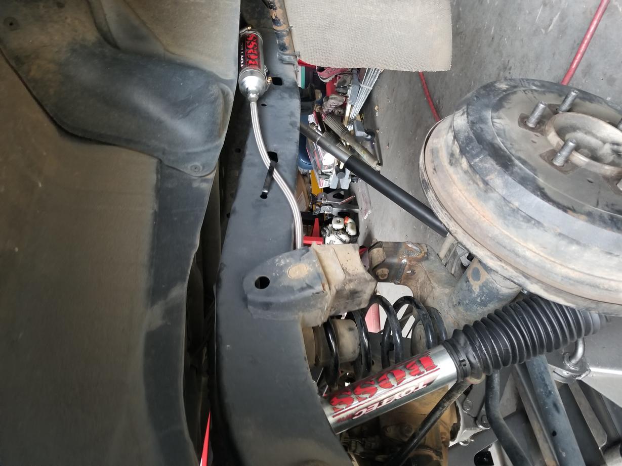

Been off of here for a long time with moving and the police academy and a newborn. Got back home 2 weeks ago and started my plans for the next half of my project. Added a 7-pin trailer connector (partially wired) for my future trailer project, got a new key cut today, and grabbed some bolts so I can put my skid plates back on finally. Its been over a year without them. Once taxes come back im ordering my snorkel and getting a few things to get ready for camping season and a trip to Uwharrie. Anyone in the area down for a trip in a few weeks?
Finally got around to cleaning the rust off my skid plates, and hitting them with POR15. I don't normally care for the high gloss look on suspension, but I sorta like these, at least for now.
