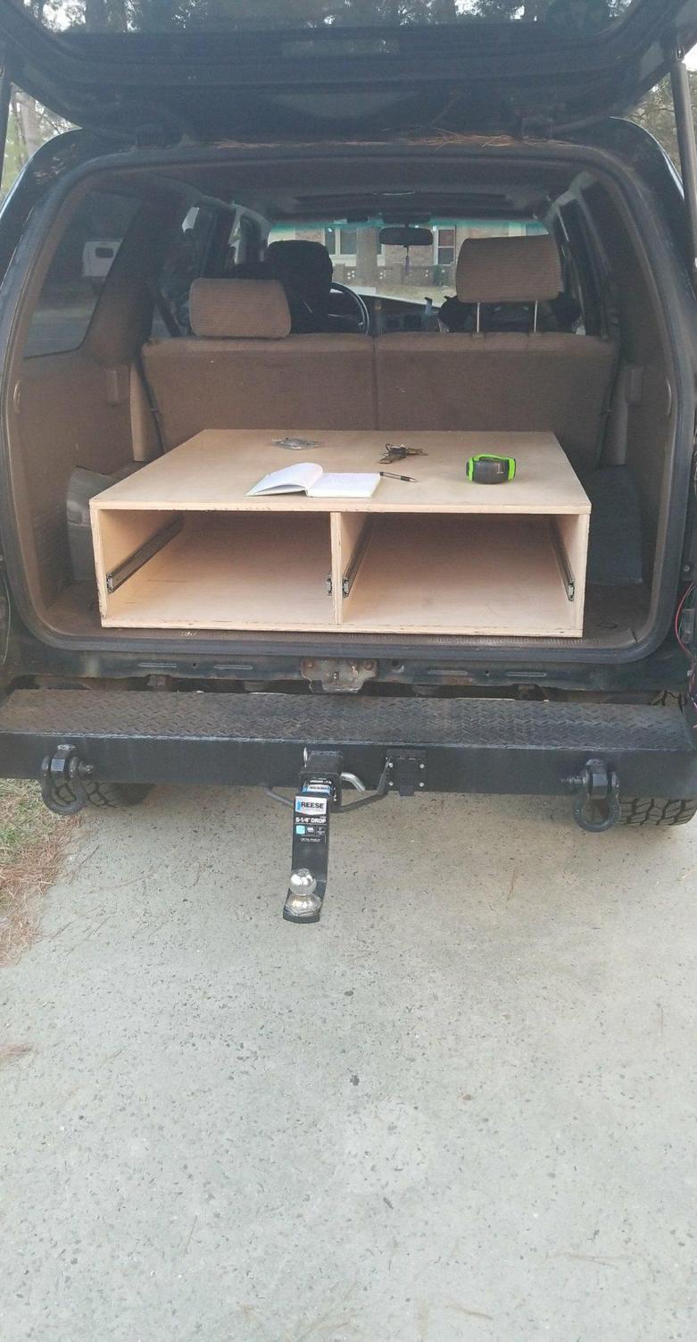

Placed the order for my snorkel and started a new storage box today. About 400 with a new saw and sander. Got the box done but not the drawers. The wife needed help with the kiddos so its on hold.

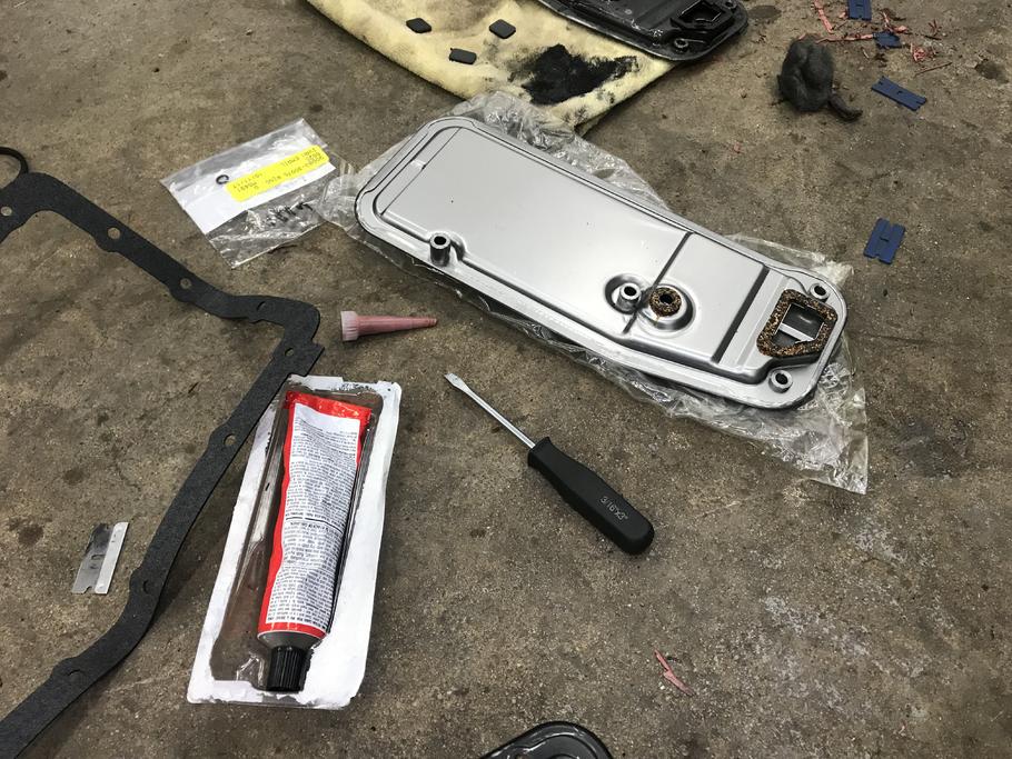

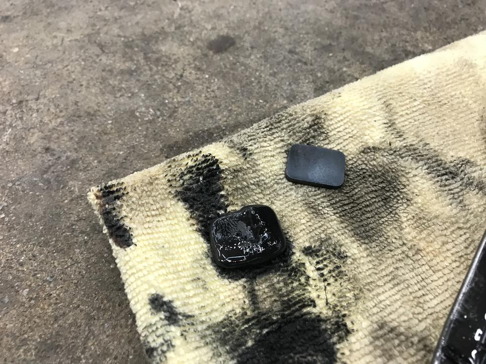

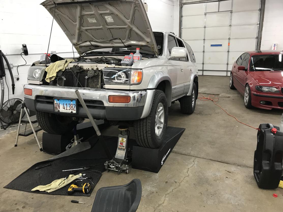

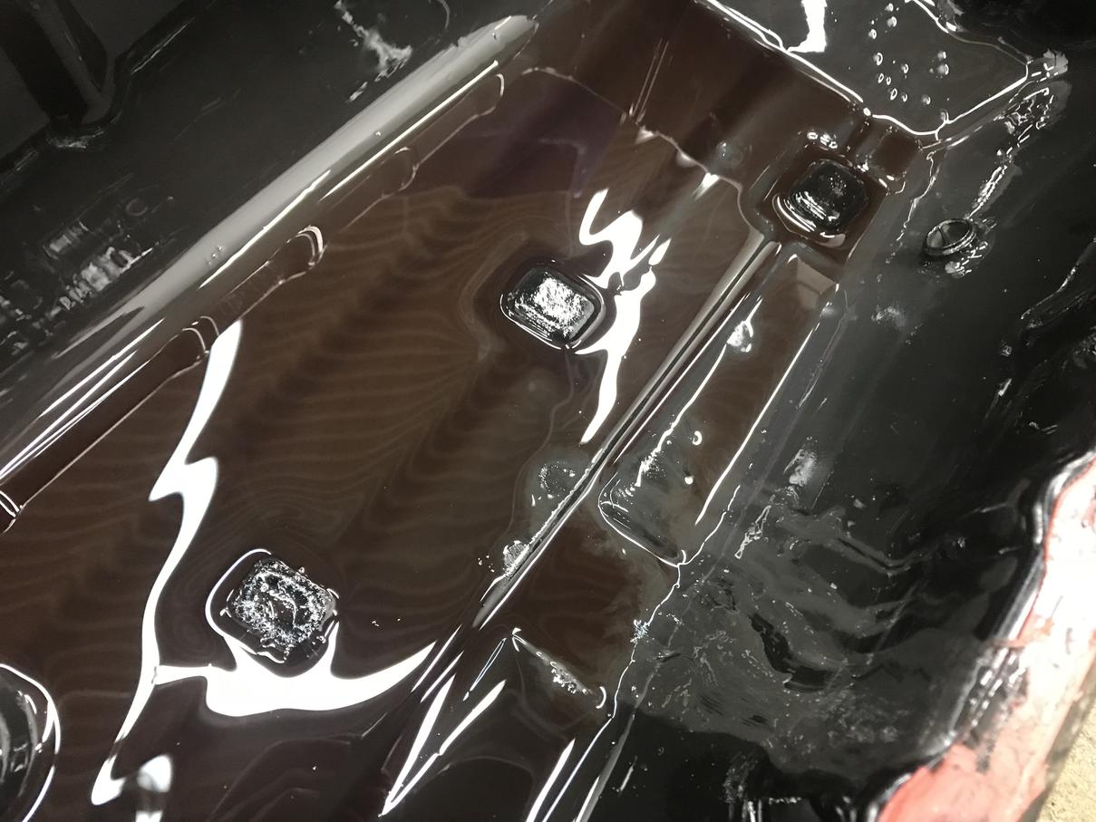

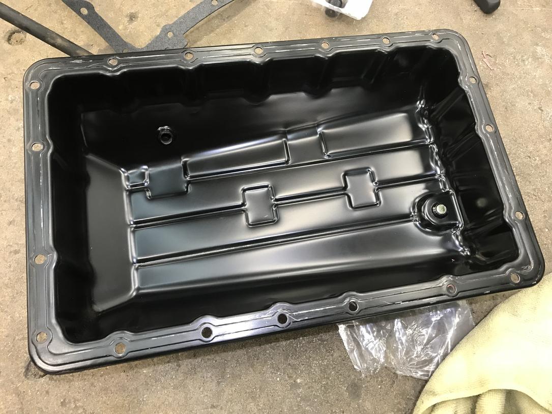

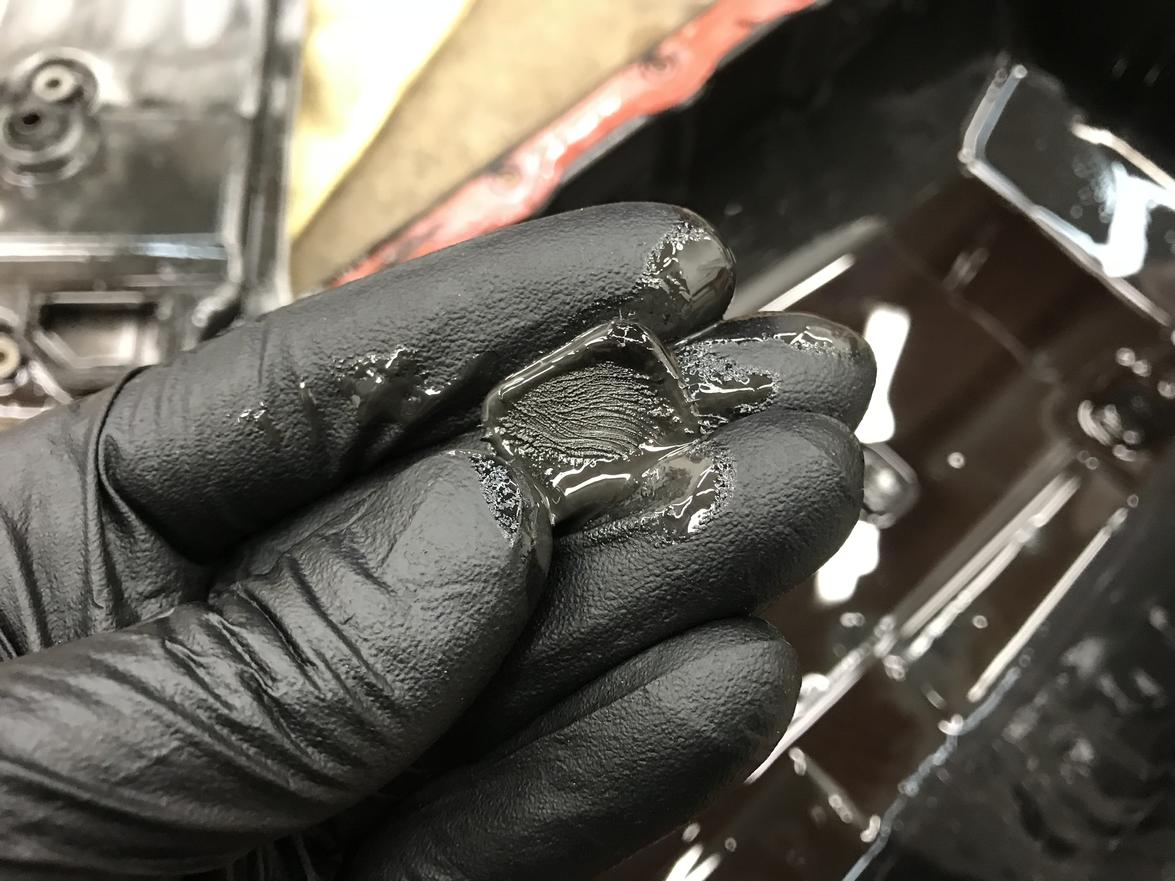

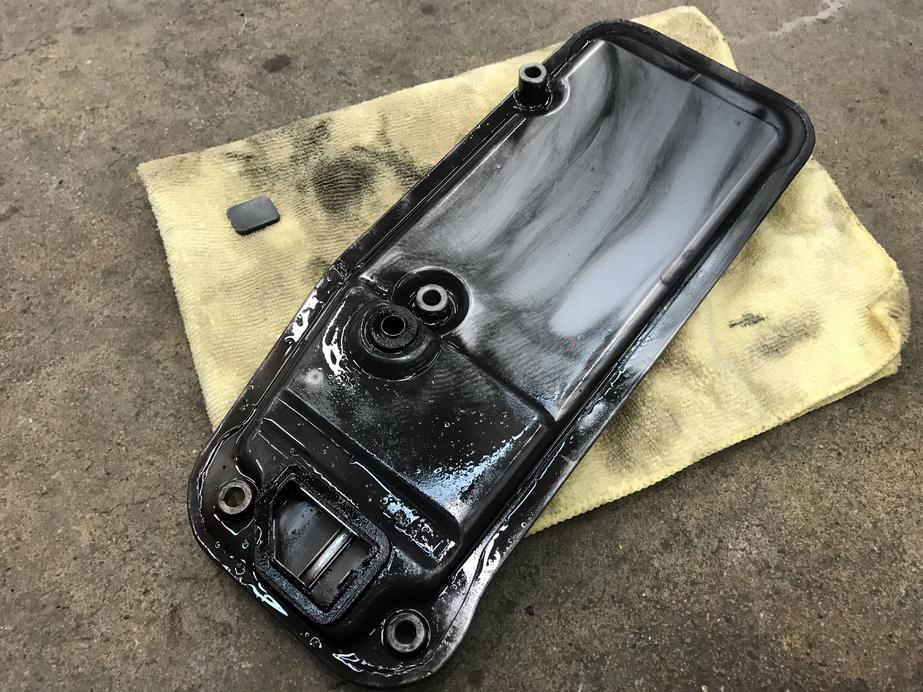

Replaced what looks like 260,000 mile old trans fluid and filter. Satoshi grill and finally connecting aux cooler, temp gauge and inline filter soon.
