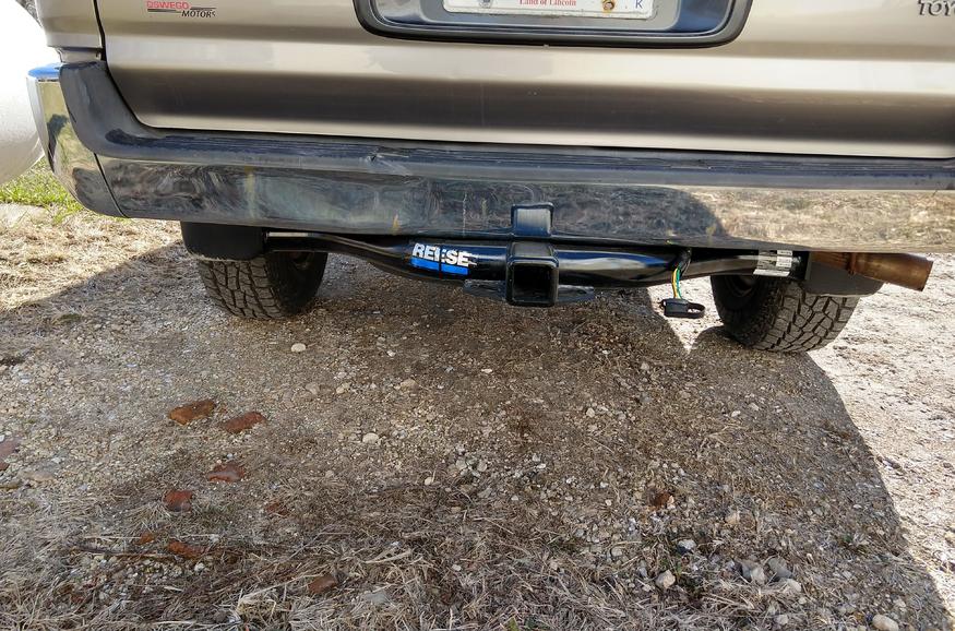

Also- I installed the Hopkins trailer wire harness today. Now I have to figure out a clever way to store the wires up and out of the way for the 99% of the time that they won't be used, lol

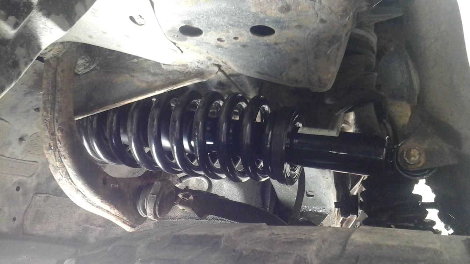

New chocks and coils from tundra Sr5 change the top plate for my old one and gave me 1 inchs ,

Sweet! Be sure to post a pic when installed. I have a set of LC 8.75 wraps in the garage and I am curious about the difference in the two re height.
yuppp would like to see pics too. And are you saying you might have a set of LC 8.75 wraps in the garage that may be for sale in the near future?? lol jk
