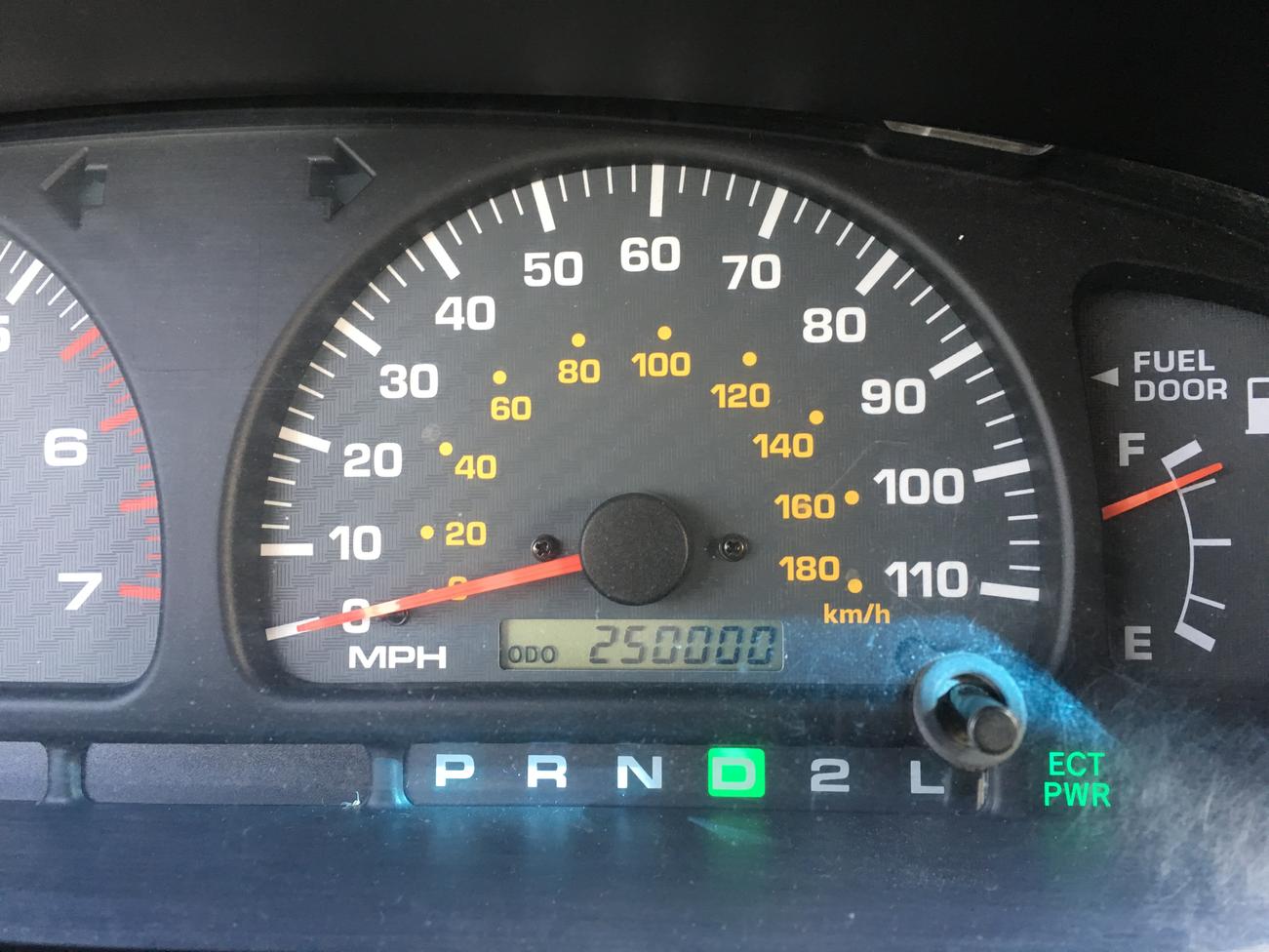

I had been having terrible tire wear issues and really sloppy/wandering steering and has had a pretty bad clunk. Last weekend I cleaned up, re-greased and re-torqued my steering rack guide bushing. This probably fixed 80% of my steering problems and It drives so much better. I think I need to finally replace my inner/outer TRE, as far as I know they all have 265k miles on them...
If you have high millage, i highly recommend doing this. Only took about 30 minutes taking my time, well worth it!

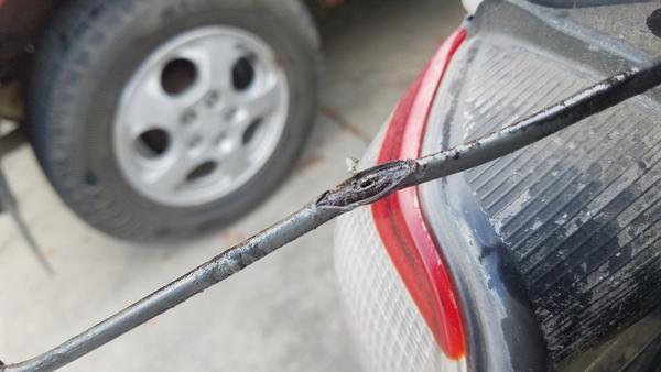

Finally changed out the brake master cylinder. On the first pressure test i heard a loud "POP", no pedal pressure after that. I blew a hole in the right rear brake hard line. Fashioned a temporary plug to get me to the auto shop and it passed my test drive. Oddly enough brakes feel better with the plug than when I purchased her 2 years ago.
I now have a permanent brake light on the dash. I assume I need to move over the sensor from the old master cylinder.

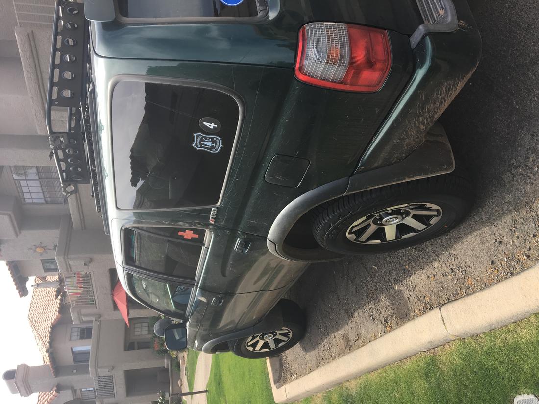

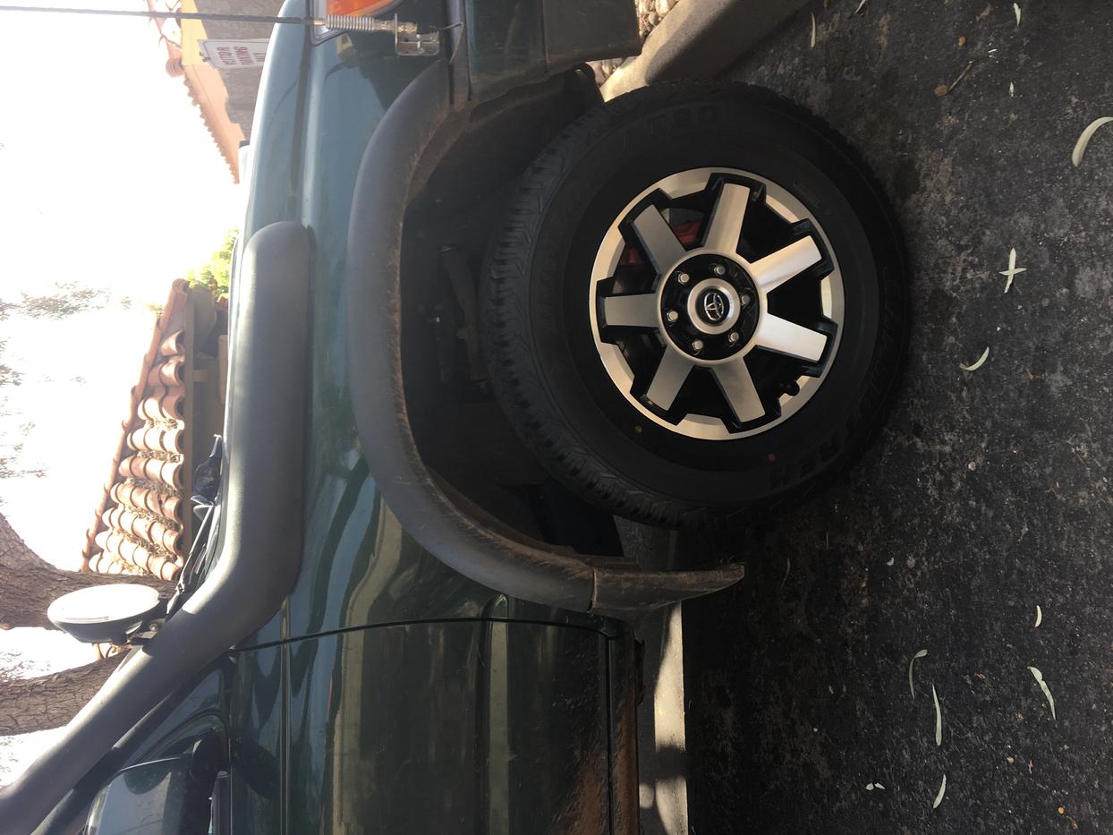

New shoes for the Mule! Brand new Trail Off Road wheels and tires. These will be my “daily” wheels and the old 5 Star rims will have 255/85/R16 KM2s for the trails.
These easily clear the Tundra Brake Upgrade.

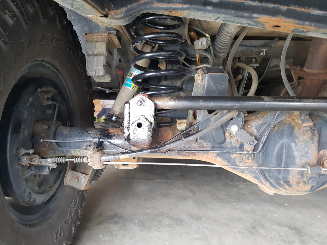

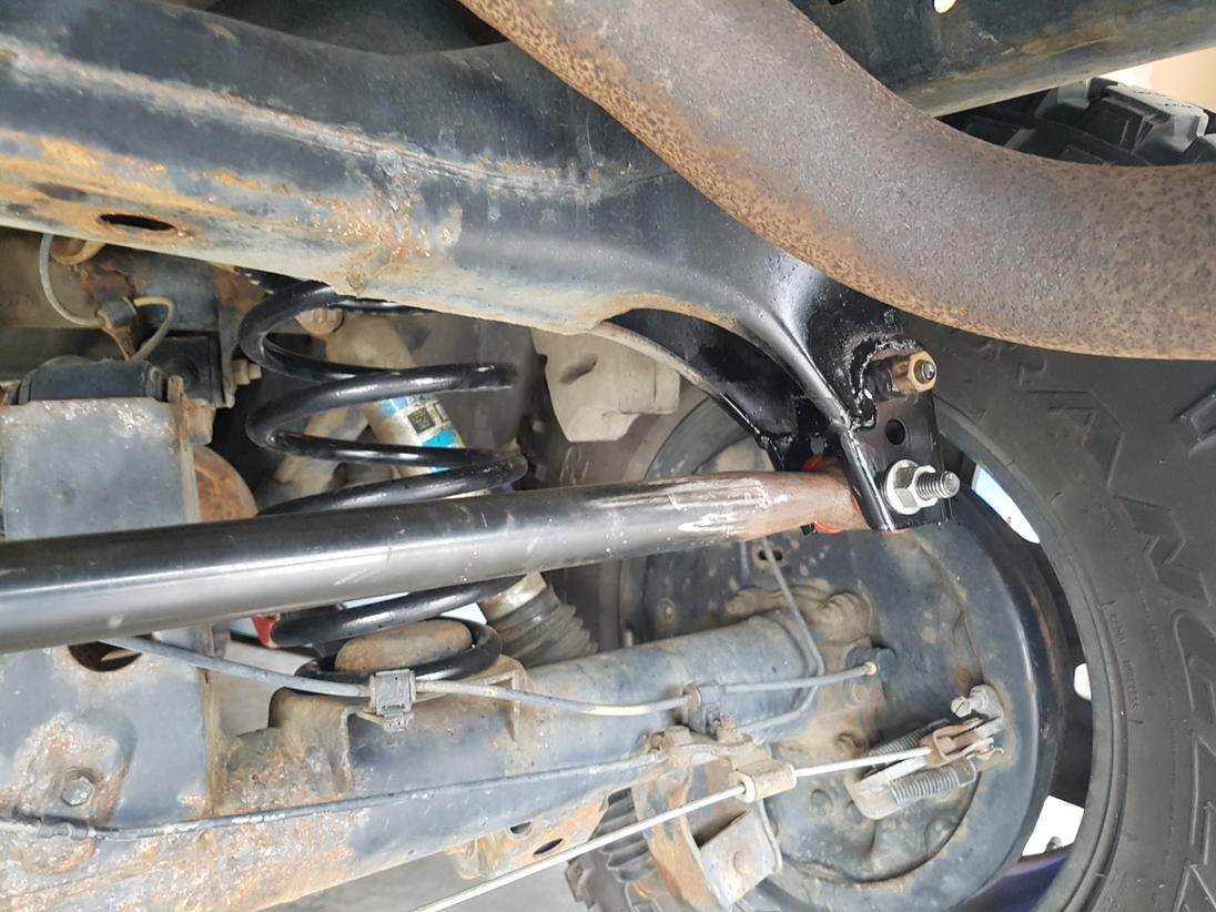

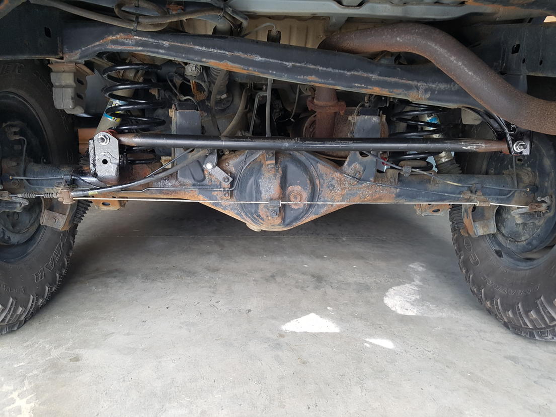

Finally got around to installing my panhard correction kit from Keith. And man i wish i did it sooner. The runner drives much better now that the rear axle is properly centered. Also pressed in some new superflex bushings in a straight second hand panhard. Now i just need to get around to cleaning up the "west coast patina" (surface rust) and paint it all up.

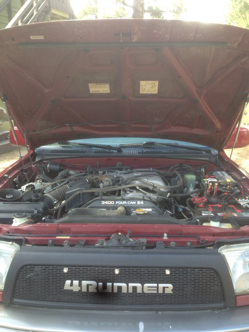

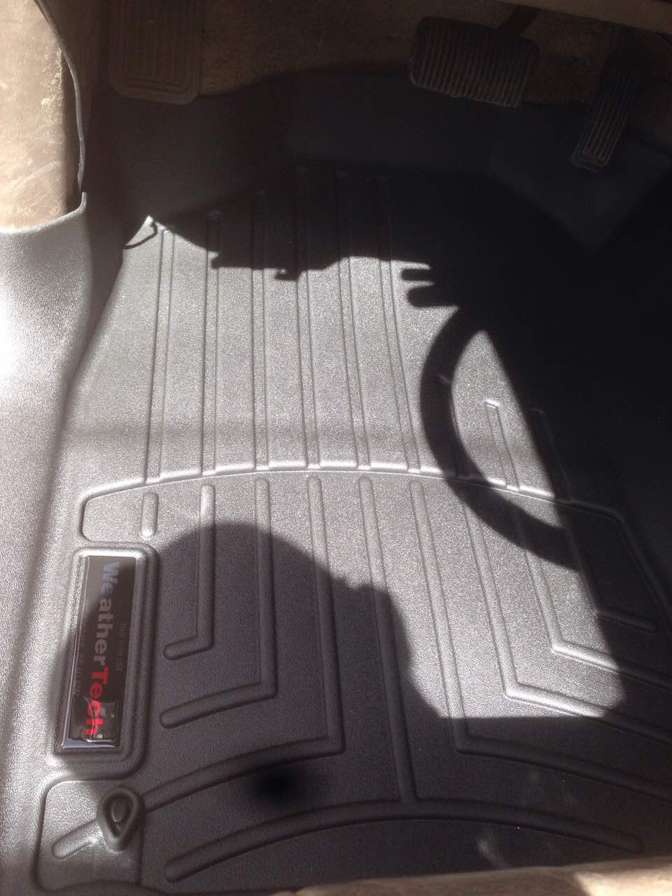

Got some weathertech floor mats and installed some redline hood struts
