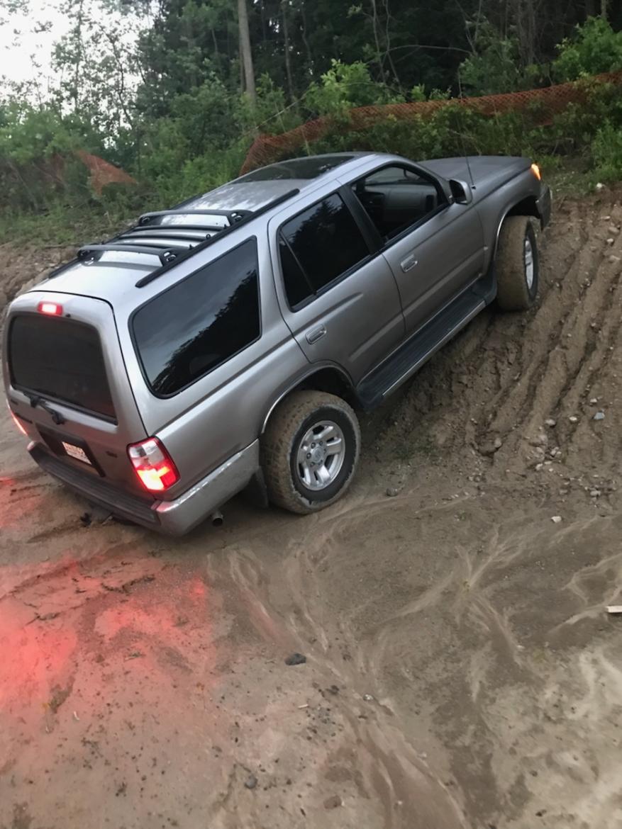

Saw a mud hill in a construction site, couldn't resist
There's a small construction site in my area where the developers cut down a ton of forest to build houses. So in the mean time I go there every once in a while to go for a quick rip.
There aren't any signs prohibiting the having of fun, so I figure I'll have as much fun as I can before the new houses get built.
