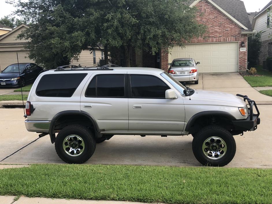

Had my front skidplate bent up
Toytec 3” lift
What toytec lift are you running? Tire size?
Does the bumper weigh the lift down at all?
I’m looking at getting my truck lifted soon but I’m not set on what lift yet... I’m running 265/75’s and I’m more then likely going to add a steel bumper in.

Here is the lift from Toytec.
3" lift ToyTec/Bilstein kit for 96-02 4Runner
I am running 265/75/16. Plan on going to a 285 pretty soon. I have the ARB bumper and it did not weigh down the front at all. I went with the 650 lbs springs. I will say the runner rides a lot better now. I am going to see exactly what it’s made of on the trails today.

Adding an ARB bumper dropped my front end about a 1/4" - true it's not as heavy as it looks, nor does it impact the vehicle by too much once the stock bumper is removed; but the changes add up.
The ARB bumper is about 50% heavier than a stock bumper on it's own, not super heavy, but if you add a winch, that's another 60# easily, plus aftermarket skids and it starts to add up. Notably, adding weight to the vehicle changes the rebound and dampening characteristics of a seasoned suspension more than a tape measure alone can tell.
I've found the best way to approach the lift dilemma (which shocks and springs) is from a weight and performance standpoint. Consider the final configuration and select suspension components to accommodate that end; too soft or too hard and you'll have handling and safety issues. Also don't forget about brakes when making the vehicle/front end heavier. Make sure you have enough meat on your pads, your rear shoes are properly adjusted and all calipers/cylinders are functioning properly to stop your rig.

That lift does just fine on the trails. From a price/performance standpoint it is the best lift for 3rd gens IMO. Did you get different front springs with it? The Eibachs that come standard with that lift are a 620# spring rate.
When I put on my Relentless and 12K Engo winch I dropped about 1/2". Ride quality actually got better with the added weight for me. Once I put the rear on and bumped the back to 861's I was able to go to the second perch on the Taco billies t and bring the front back up an inch. The increased pre-load actually made the truck ride even better. lol
