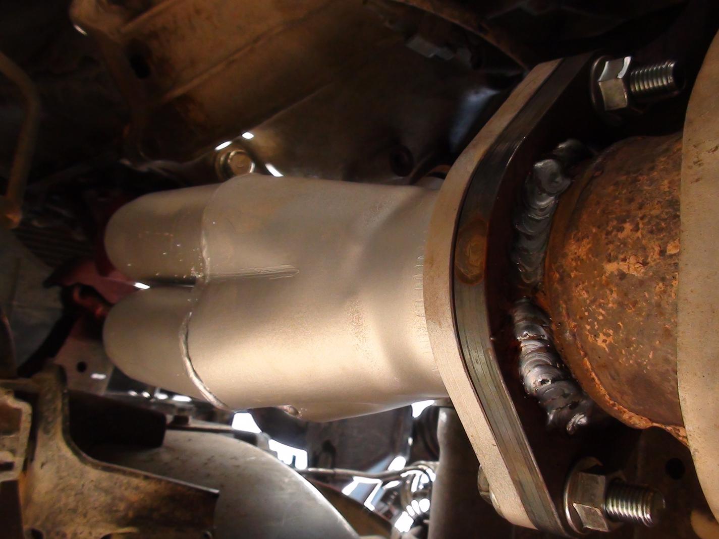

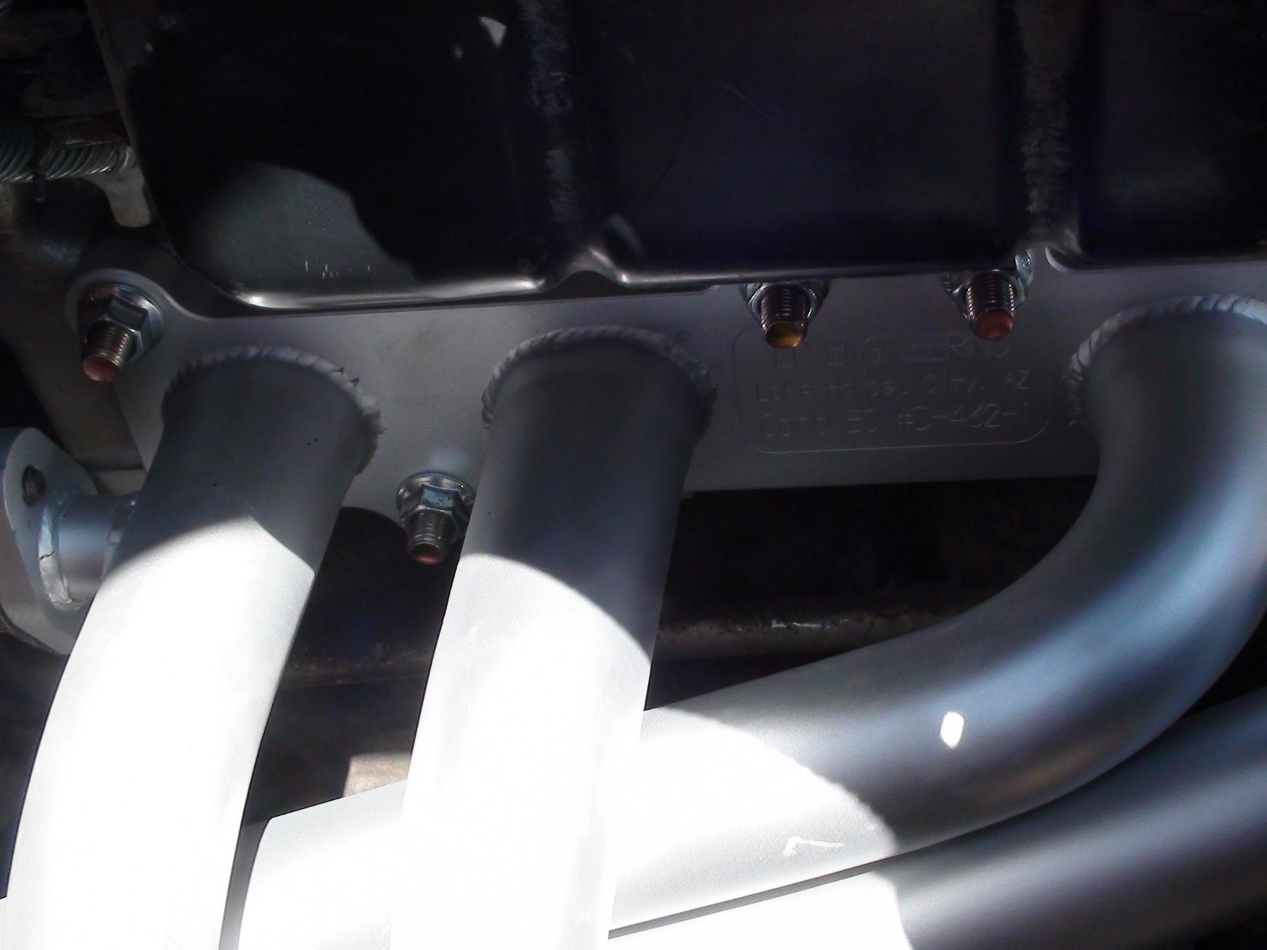

Headers on, new valve job, rear springs and stops
I was going to put these LCE headers on my 3rz a month back, then needed said valve job. Just got 'em on, real beauties. These, coupled with an engine in top shape at 150k, definitely feeling zippy on the high desert hills.
Also, while i was getting the valve job, they noticed a recall for rear coils and a few other parts back there. This made an unbelievable difference in my ride. Shocks are 4mo old OEM and with the new springs and stops it feels better than the new rental I was driving. Shame they won't stay in long;)
Coupla pics just cause I obviously don't know how to make these puppies little smaller.

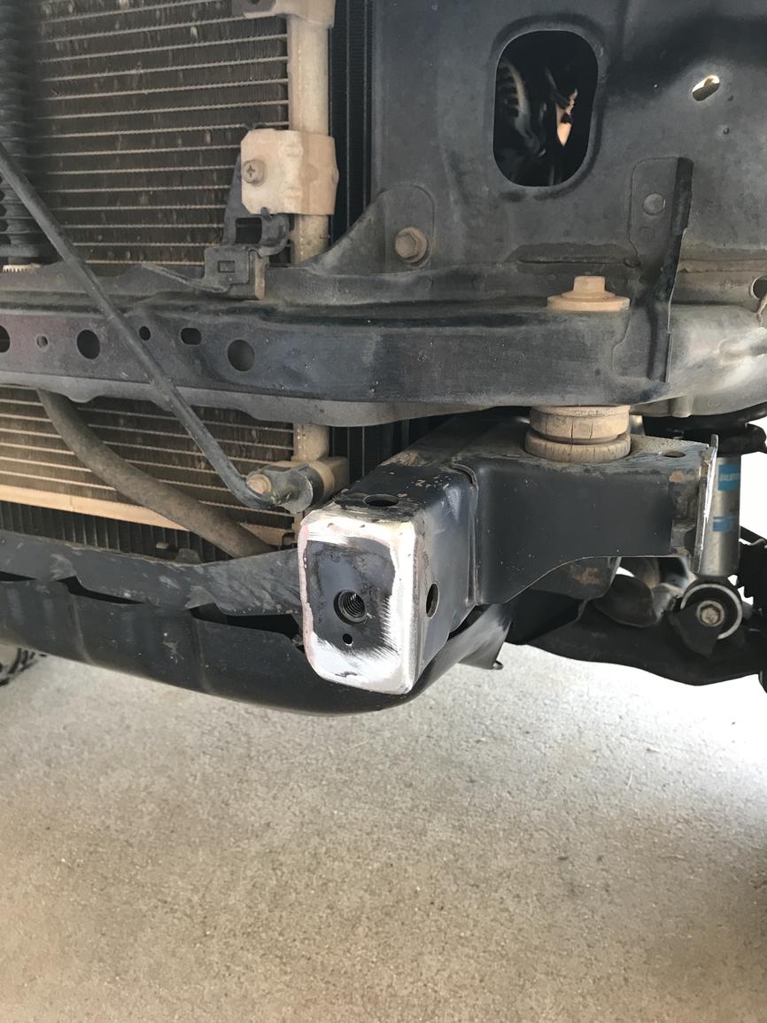

Boxed in the end of the front frame rails in preparation for a new bumper.

They come with the ARB 3423020 bumper kit. They are used for something when installing on a Tacoma, but are extras on the 4runner. So it works perfectly to box the end of the frame.
Nice, where did you get the end caps?
Are you leaving your tow hooks off? I took mine off because I won't need them anymore and need to know if I should re-thread bolts in those holes? I don't know if the bolts served any other purpose other than to hold the tow hooks. Thanks for any help you can offer.
The bolts only hold the tow hooks on. If there are no tow hooks, there is no reason for the bolts to be there.
On the ARB bumper I’m using, those bolts are re-used for the new mounting brackets as well.
