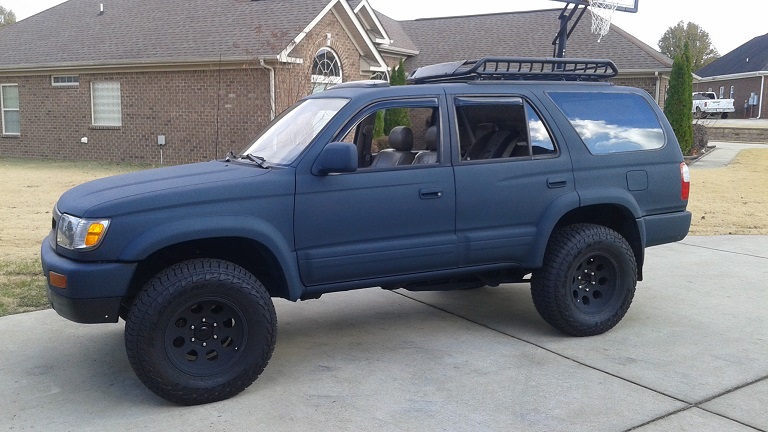

Installed Bilstein 5100s, got an alignment, and then removed the running boards.

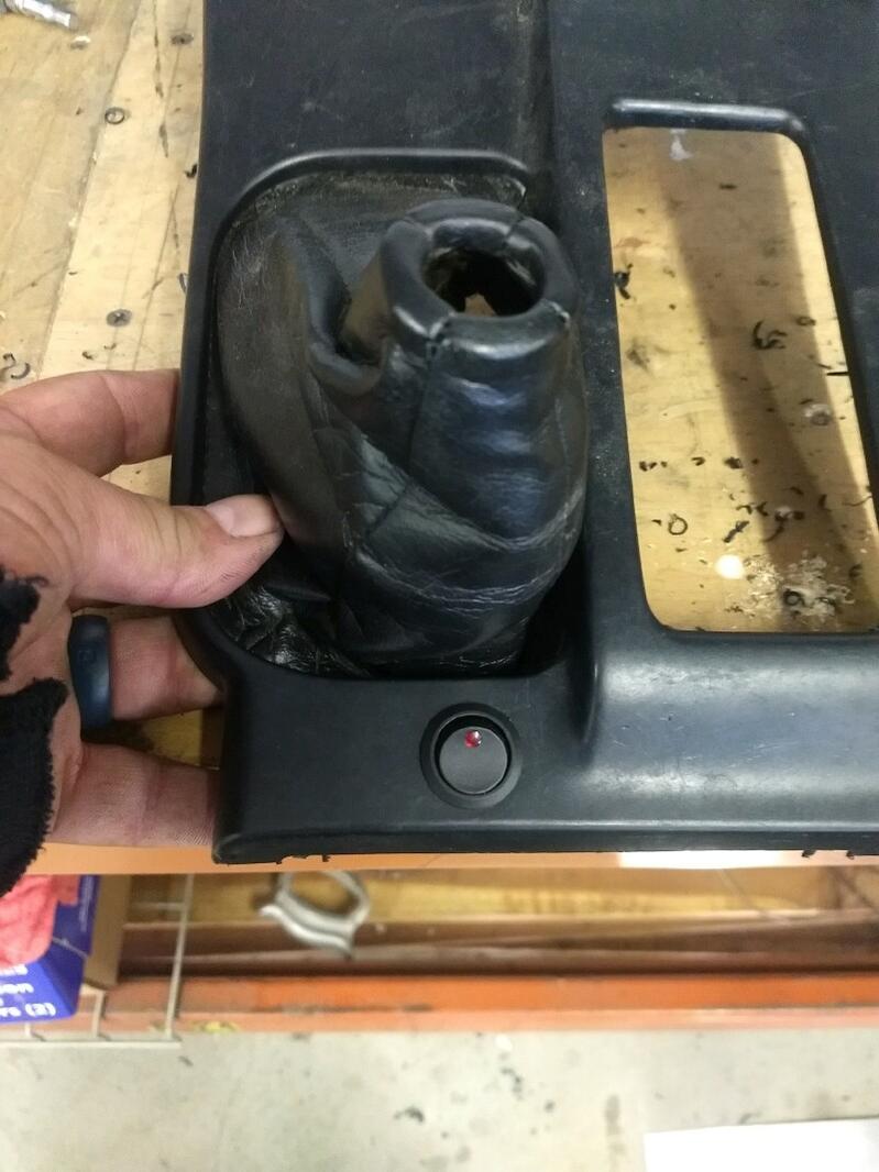

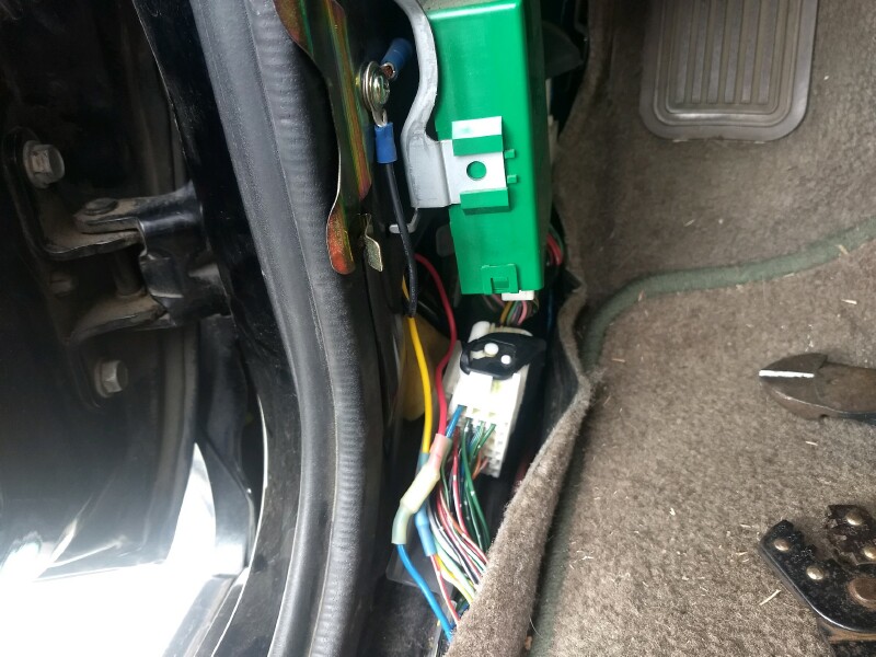

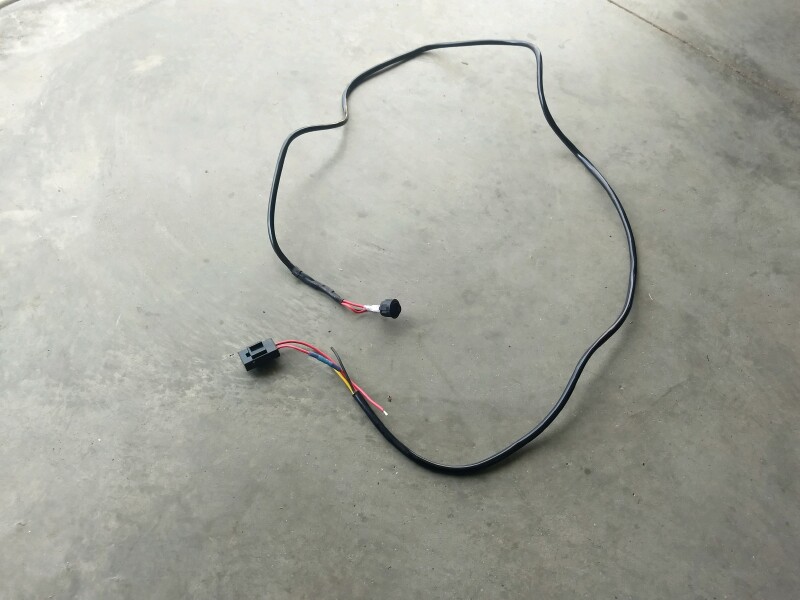

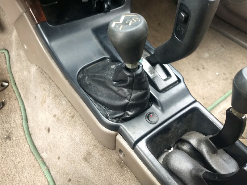

A home made harness, a switch, some research in the FSM, pull some of the interior up. And now I have an override switch for the backup lights!!!!

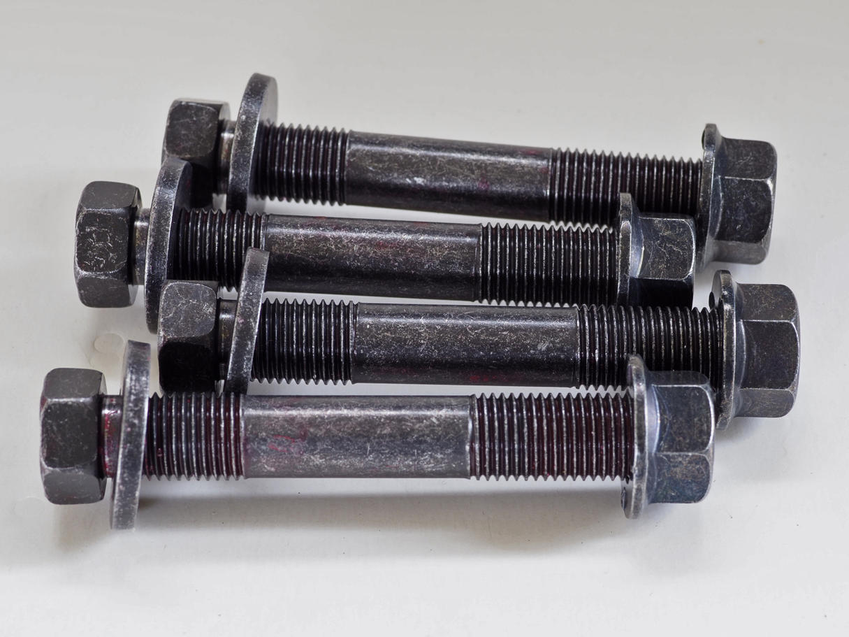

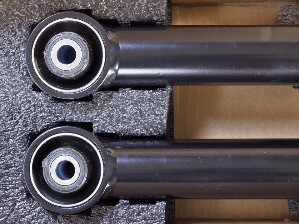

New Rokmen trail series rear lower control arms
Finally got rid of annoying rear end wobble, bushings were totally shot in the OEM's after 315,000 miles. One bushing sleeve on the passenger side just fell out when the arm came out.
Also bought new hardware (live in the rust belt) but was not necessary as the old bolts were in pretty good shape considering.
Really like the look of these arms, much beefier and very solid construction compared to OEM. Didn't want to go through the bushing replacement scenario, bushing sleeves would probably have taken a lot of work to get out.

Do those bolts have a threaded portion under the bolt head as well? I'm not sure if I'm seeing that right of if I've just had one too many! :jump:
Yes they do, I thought I had been given the wrong part when I first looked at these as there is nothing threaded inside the bushing sleeve and the mount is only 1/8 thick at most.
Not sure exactly why, but taking the old bolts out it seems the lower control arm mounts are slight sprung apart and the inside threads at the top of the bolt are a great help in backing the bolt out as they catch on the metal of the sprung mount. If the rear axle shifts a little bit when the nut comes off the bolt jams a bit and these threads help you get it backed out to the point where you can pull it the rest of the way out.
(Had to use a ratchet strap to pull the axle and get the mounting holes back in to alignment.)
