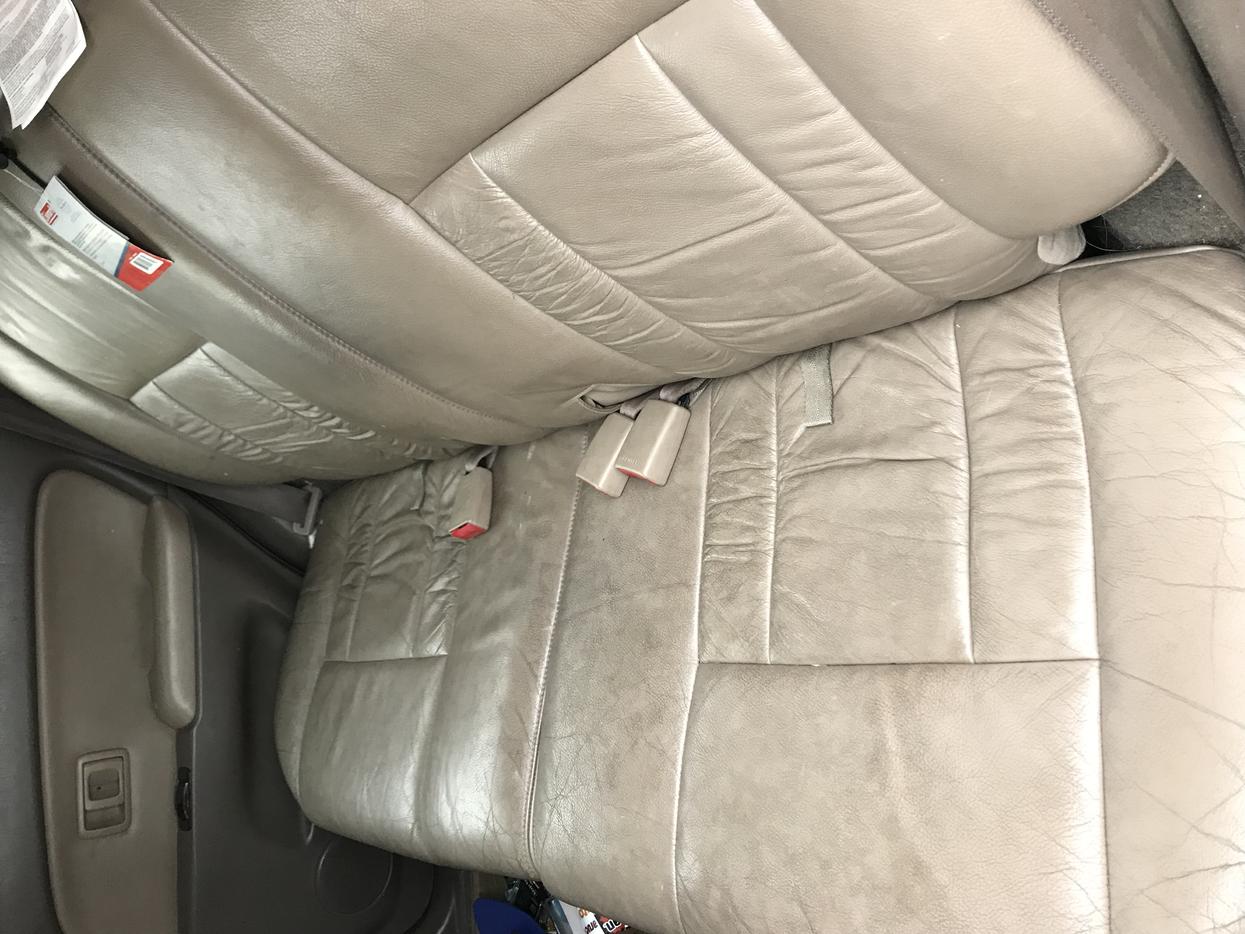

Finally got around to giving the seats a much needed cleaning. Only took pics of the back seats cause those were the worst by far.

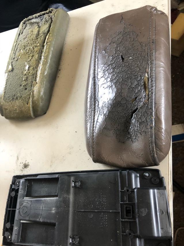

well I decided to try to recover my elbow eating alligator looking arm rest with some old tonneau cover material to at least look somewhat better. I mean it feels better, but the replacement is in my cart on eBay after seeing the beautiful results. Just thought I’d share, spend the 25$ for replacement instead of wasting an hour

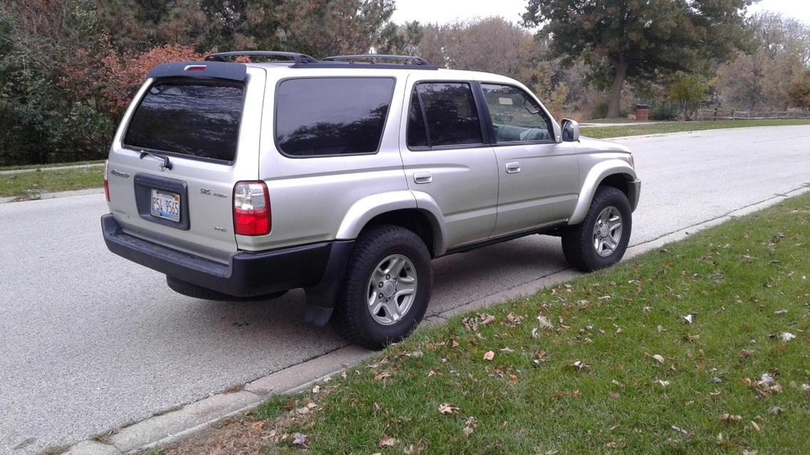

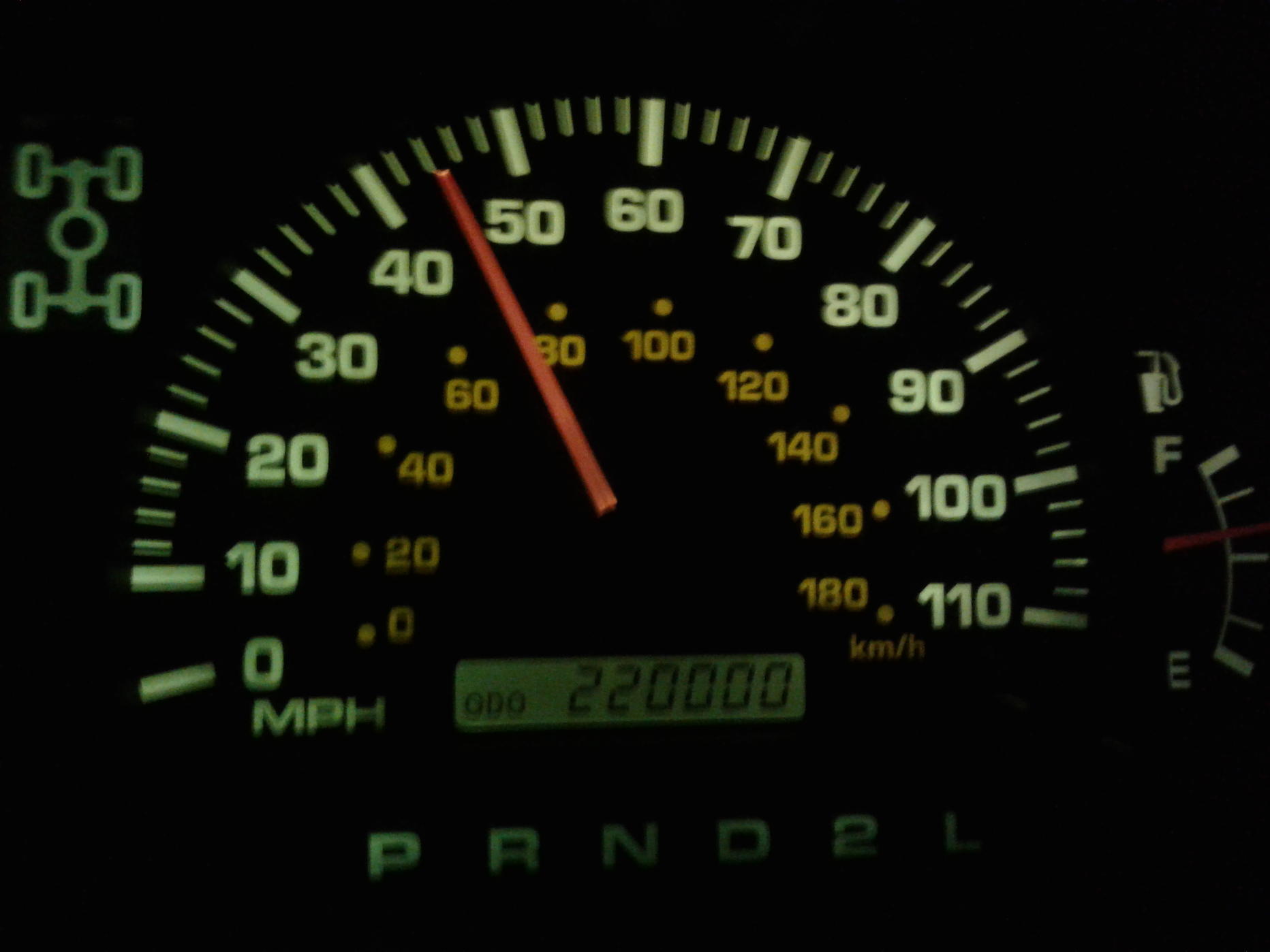

Over the past couple months - derusted, Por 15 (PITA) , and fluid filmed as much as I could reach under the truck. Repainted my chrome bumper that was starting to rust out with Rustoleum rattle can bedliner, removed running board, patched rust holes in rocker panels and painted with rattle can bedliner, then rerouted sunroof drainage so it no longer drains into the rockers, removed (PITA) and painted trailer hitch with POR15 and rattle can topcoat - haven't reinstalled yet. Changed power steering belt that fixed my cold weather notchy steering problem (tried PS flushes and reservoir cleaning first), changed radiator and thermostat AND hit the 220K mark.

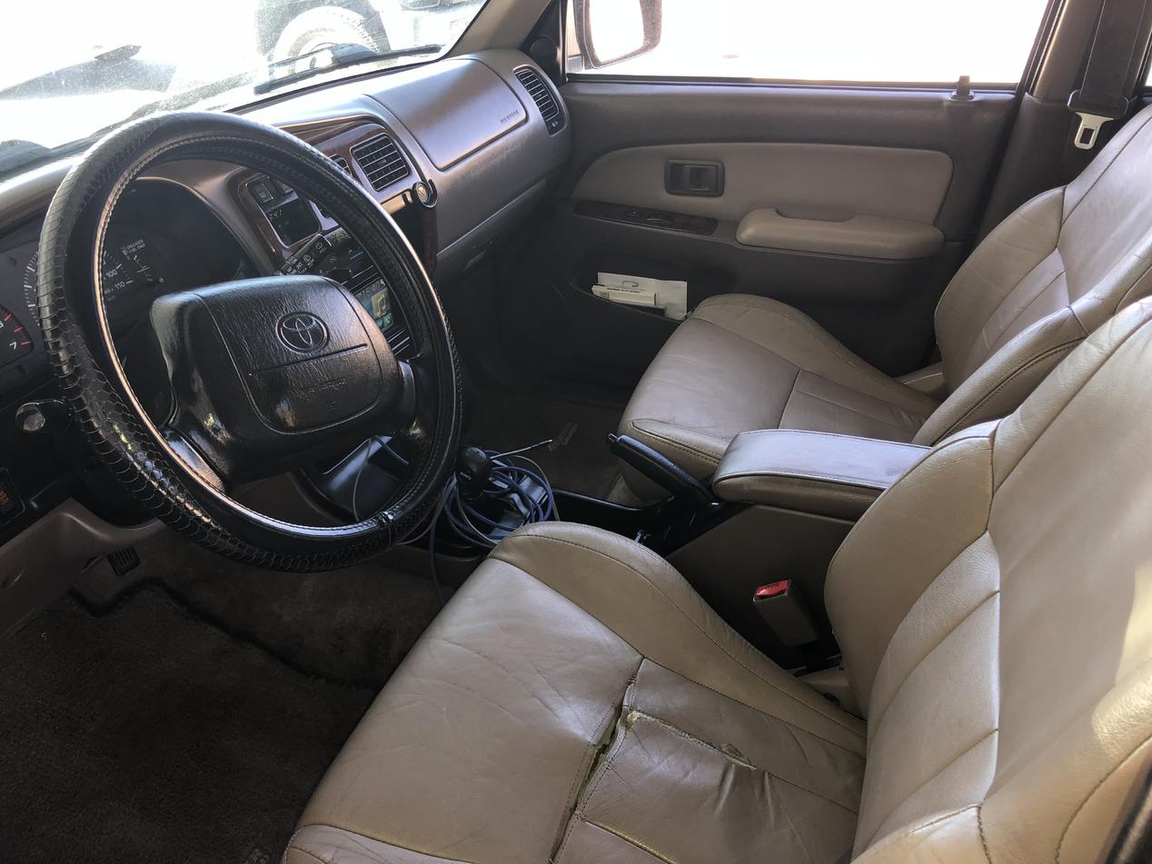

I want to do a budget refurb/restore to my 1997 runner. At 315k she is showing her age. I will eventually save up for a paint job, but what are some good ideas interior wise? Has anyone made any noteworthy interior modifications?
