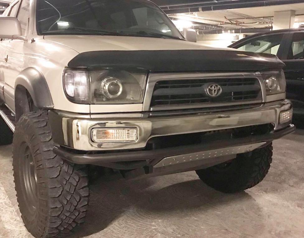

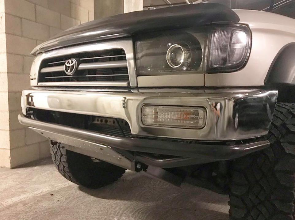

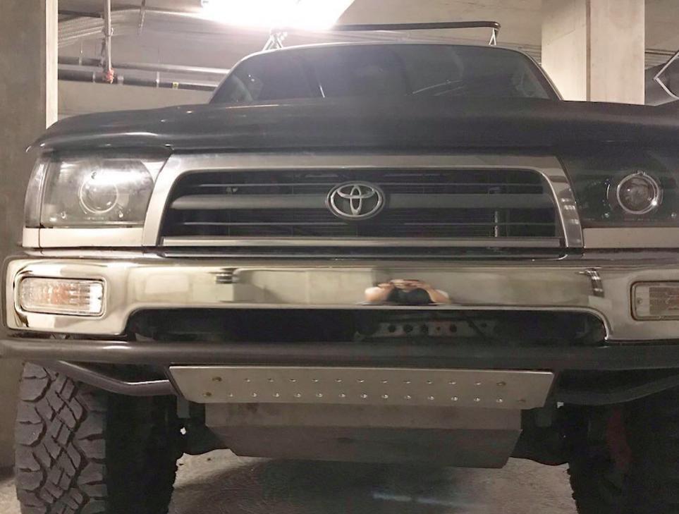

got into an accident so made repairs (new hood, grille, condenser, radiator, bumper) and upgrades

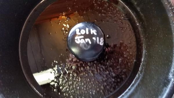

Annual oil change day !
1 yr and 14K on the cheapest crap oil that I could find last year when I got the 'runner. Today I treated it to another OEM filter and some Rotella T6.

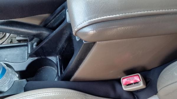

I also installed a xmas gift. My GF has these in her Rouge, I must have talked about them enough times that she thought I'd want some for my clunker. She was right ! I hope that I never lose keys between the seat and console ever again.
By "keys" you mean French fries right? Haha
Did you really go 14k and crappy oil and one filter.....yikes.
If so I would do several oil changes in the next few months to wash the gook out.
