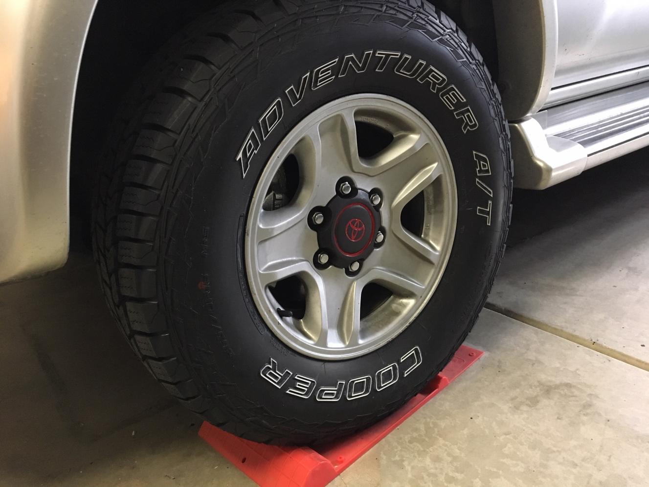

Got some new tires today. Pep Boys has Cooper Adventurers on sale, so I went for it. Alignment, balance and mount, and mounting one of the old tires (still plenty of tread left) to the spare.

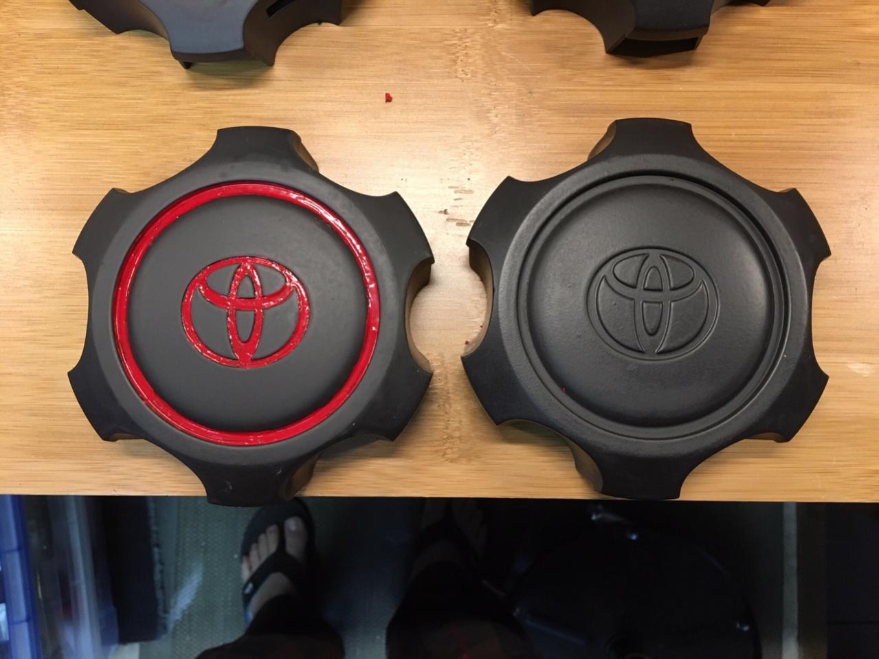

Painted the hubcaps last night. I made two versions. One is just black, and the other one has red outlines. I love the way there’d outlined look, but it was a pain in the ass to do it, and I don’t have the right tools/painting techniques to make it not look sloppy, so I painted them all black in the end.
