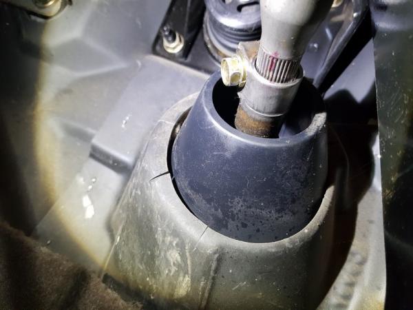

Today I adjusted my steering column over by one spline since last year when I did the tack mod on the loose slip joint I didn't put it in exactly the same and the wheel was always a little bit crooked while driving straight.
I noticed that the spline didn't go in all the way when putting it back together. It was like that after I put it back last time. Presumably it was all the way in originally before I removed it the first time. The lower piece coming from below seems to have some up and down play like it is coming from a yoke but I couldn't get it to go on any further than in the photo below.
mark_bc-albums-sandy-98-sr5-manual-transmission-5vz-fe-picture55363-20190519-194658-tn.jpg
This is what it's supposed to look like, photo taken from this thread:
Does anyone know how to get it to seat all the way?
Yes, put some channel locks on the lower portion of the spline to keep it from pushing into the engine bay. I did that with mine and was able to fully seat it after doing the mod. Good luck!
