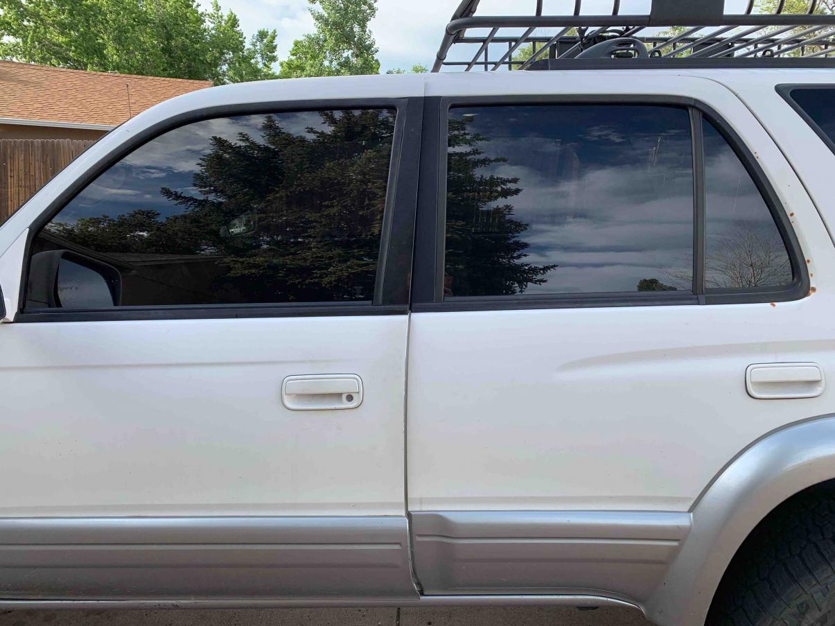

Tinted for the first time ever... it turned out ok. Just the front driver/passenger windows.

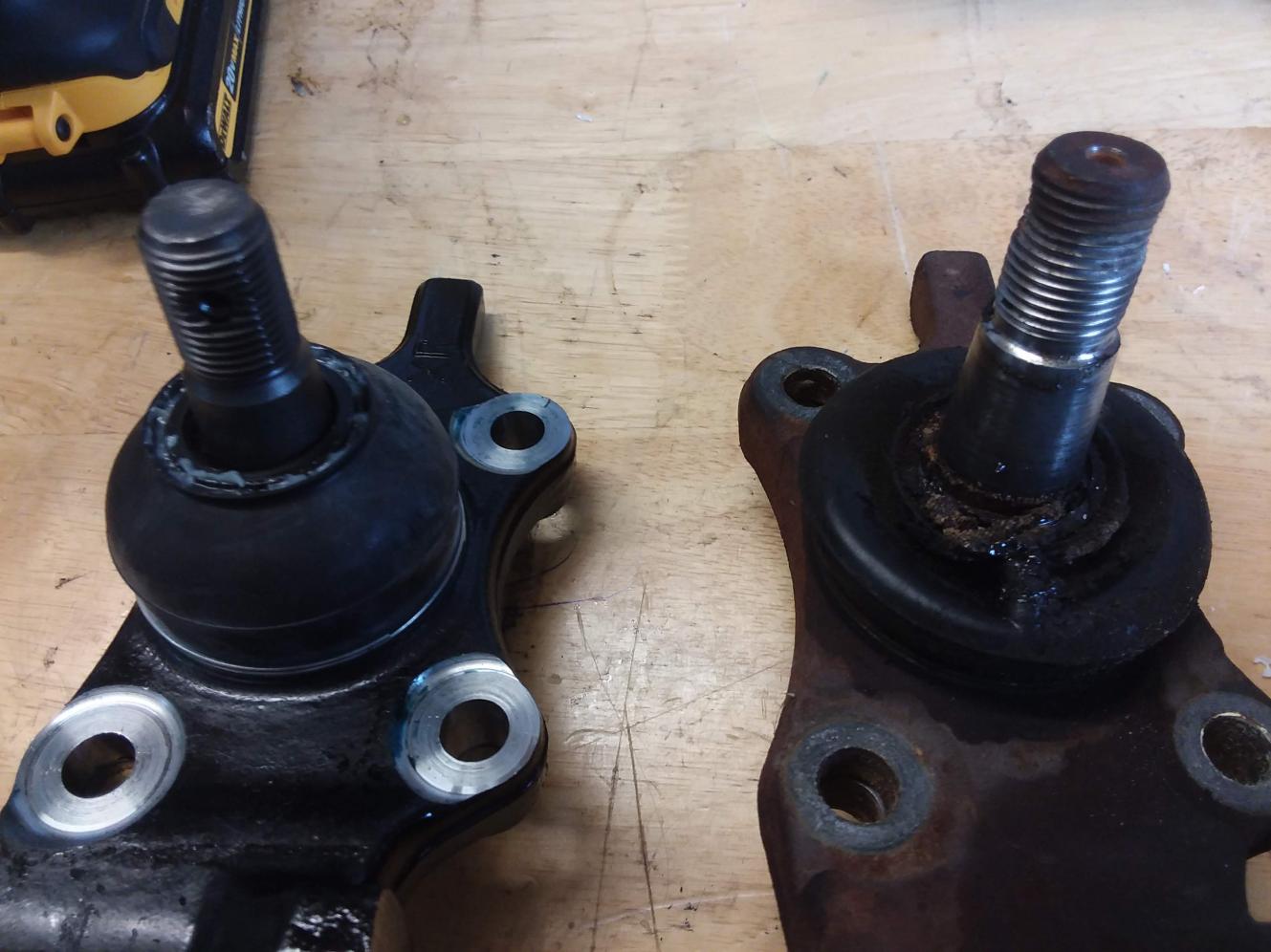

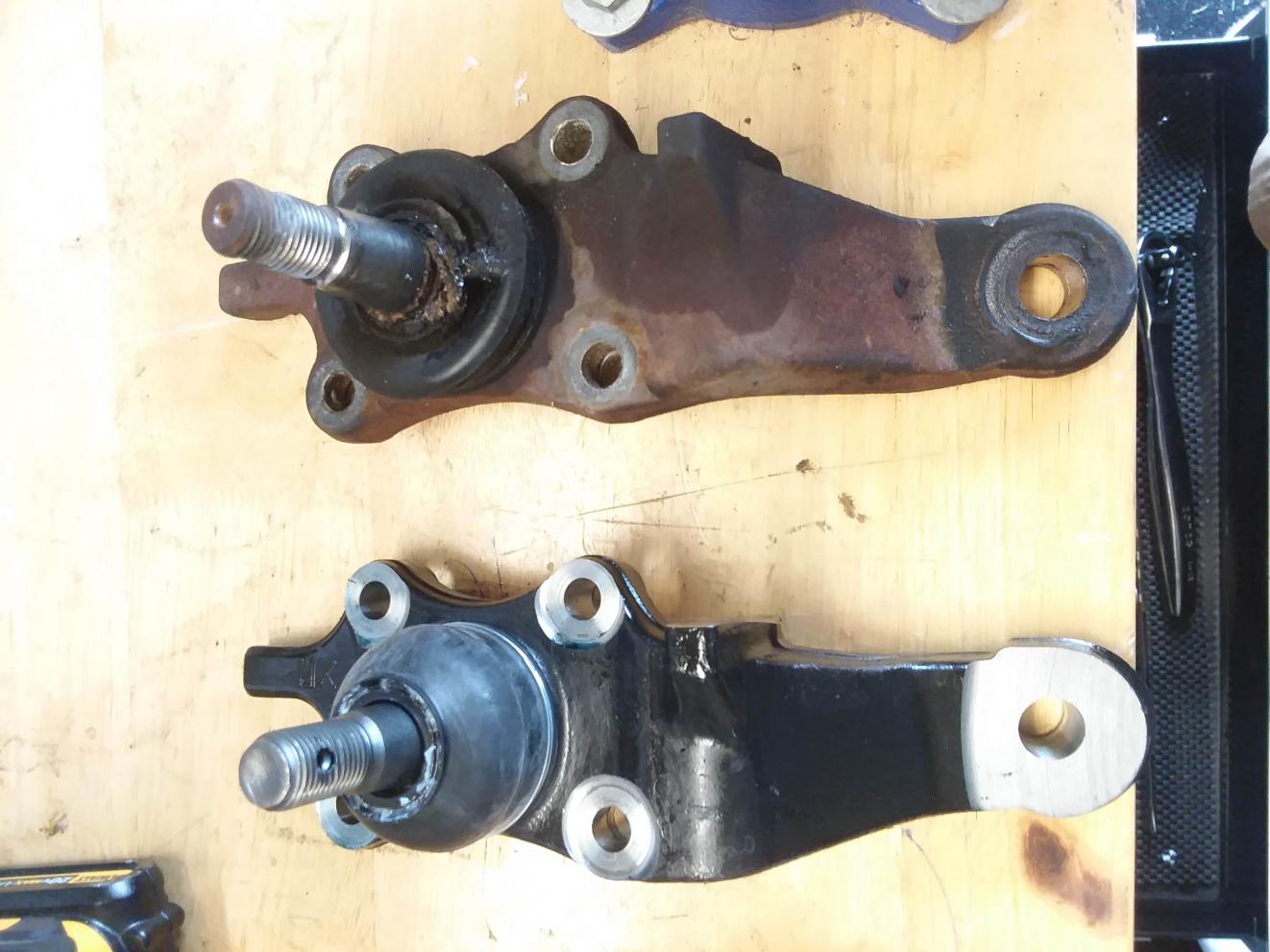

Finally completed my front end work, for now.
New OEM LBJ's - from www.toyotaofdallas.com/parts - 110 each - local pickup in DFW saves the shipping! - Take a closer look at these. The old ones were AC Delco Professional line and are stamped 555 on the other side. Notice some distinct differences with the OEM new ball joint. The main difference is the way the tie rod end is machined, and also take a look at where the 4 bolts go through! Anyone telling you that the 555 branded ball joints are just as good, are FULL of it! I put these 555's on in 2012 and 40k miles ago. They are so notchy that they will hardly move. The oem ball joint has some resistance, but moves like BUTTER. This truck has hardly been abused either, so I'm glad I changed them out when I did.

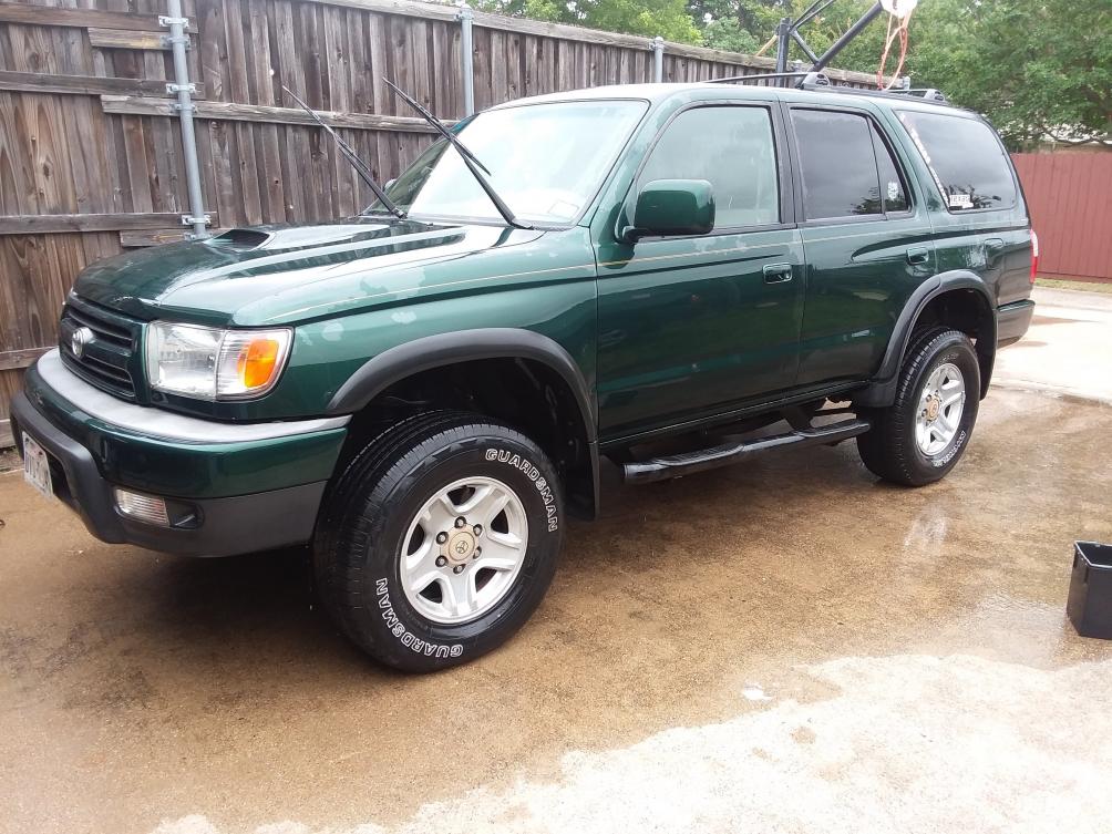

And Finally, gave the whole thing a wash and vacuumed. It's been sitting for weeks at a time, and hasn't been washed or vacuumed since at least September of last year!

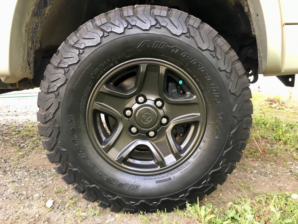

Finally got around to repainting my wheels. The old "rustic myst" bronze look got updated to "oil rubbed brass" that's a nice high-metallic fleck dark-gray. Used 80-grit sandpaper to knock down the damaged areas followed by 320-grit to smooth it out. Made sure to go way overboard with the masking off of tires and trim (3M painters tape and heavy paper), and used plastic trash bags to cover the rotors and calipers. 4-5 light coats of paint, followed by 3-4 coats of clear enamel to get this:

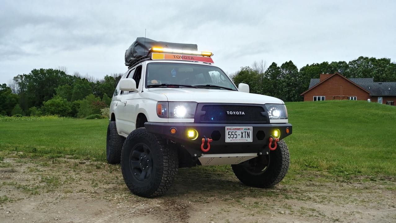

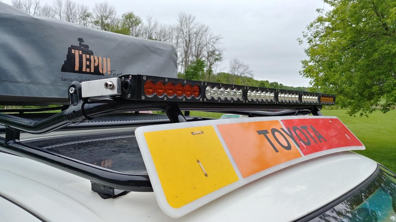

Finally was able to wire in and fab up some brackets for mounting my new used Extreme X6S 38!
