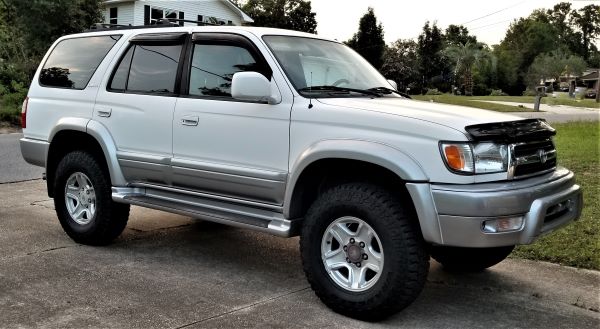

Got around to doing the clay/wax/sealant routine. Still cleans up pretty well for 20 years old!
Looking good!!!
I have one similar in my driveway, going to do the same to it.

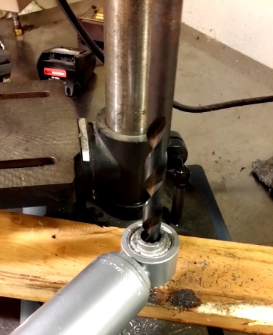

new front kyb gas-adjusts tonight. small glitch- had to drill the lower
bushings out to clear the unthreaded part of the 14 mm bolt. 9/16" bit works.

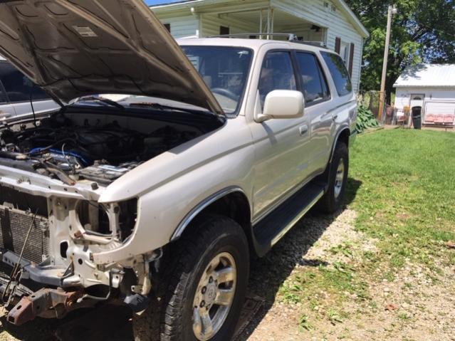

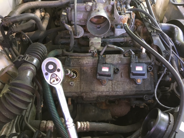

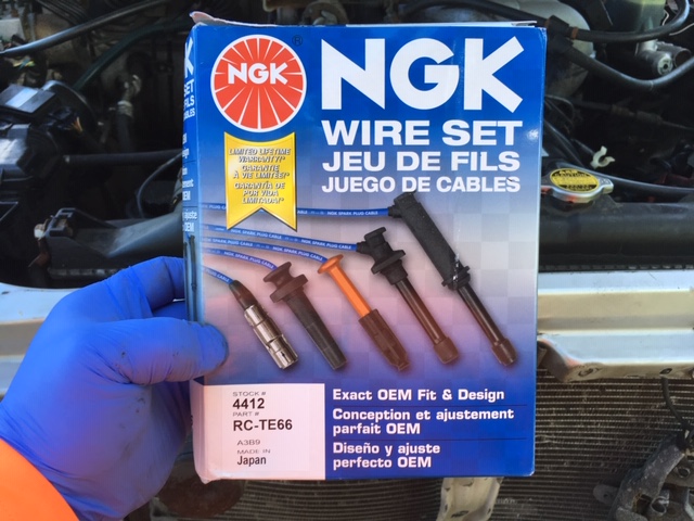

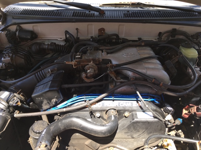

I bought my 98 Runner a month or so ago. It was wrecked in the front and sat for 2yrs. After replacing the fuel pump,NGK TE66 wires, and NGK-BKREKB-11
plugs,and fresh gas, it fired rt up! The engine sounds great! I'm stoked on getting it road ready. Thanks to T4R.Org for all the great info!!
