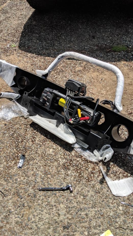

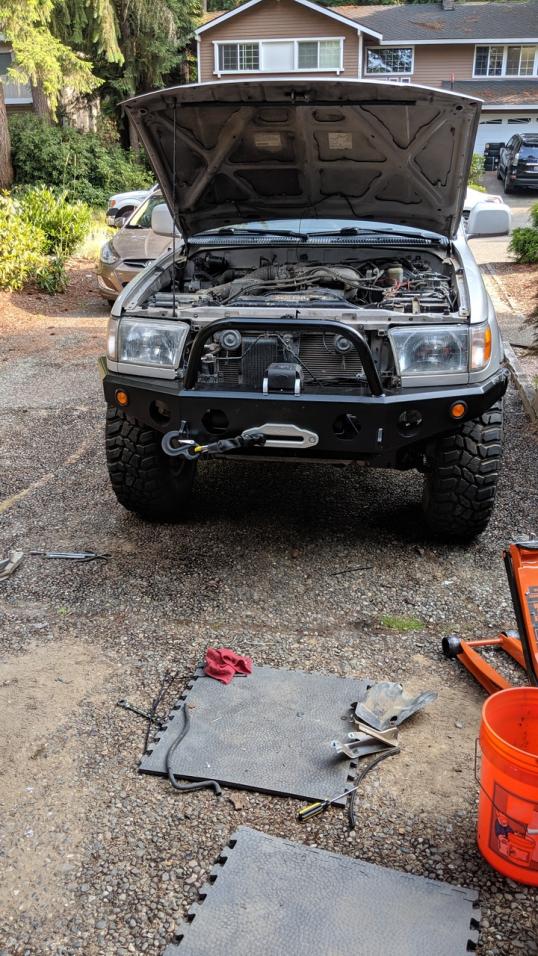

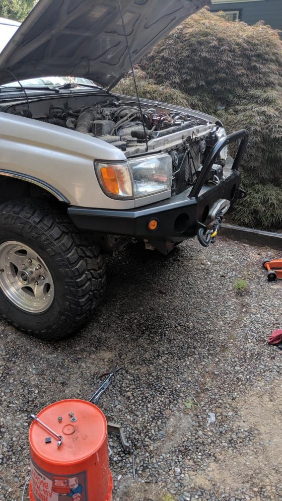

After doing the rear last weekend, got the front today (along with a winch)

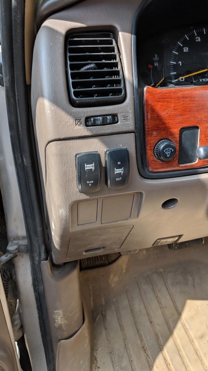

Finished up some housekeeping from the installing the bumpers, license plate lights, backup camera, license plate back up and brake light, etc.
Also added indoor plumbing for the winch :)

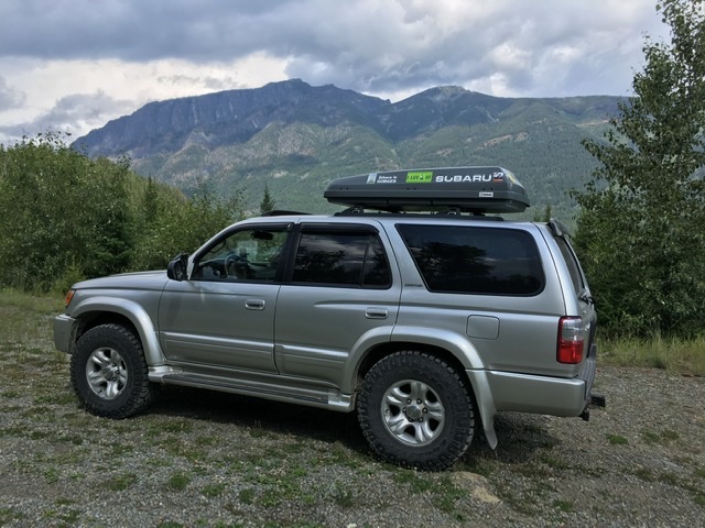

Currently driving across Canada towing my RV with my 4Runner. We decided to leave the RV at camp and do a little day trip to St. Mary’s Lake outside of Cranbrook BC. Tons of gorgeous dirt roads and some more rugged logging roads to explore.

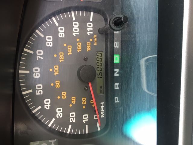

My 4Runner is officially broken-in!
Replaced the radiator, thermostat, and v-belts. Also changed the oil for good measure.

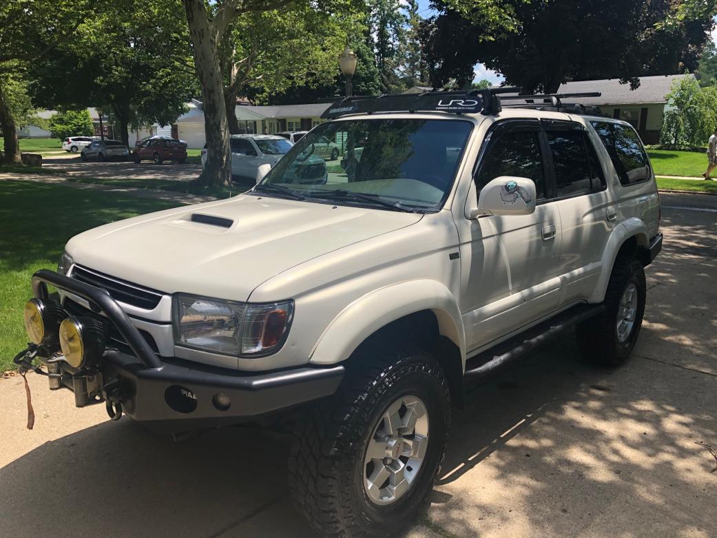

Got around to doing the clay/wax/sealant routine. Still cleans up pretty well for 20 years old!
Helped a buddy and fellow member clean up his golden pearl with the same treatment. Looked amazing for all that it gets put through!
