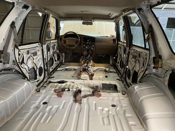

Ripped out the interior. Deep cleaned the carpet. Cleaned the interior panels to sound deaden. Installed 01-02 exterior mirror (by accident, didn't realize they were different from a 99). Both original mirrors were damaged when I bought the truck.

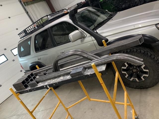

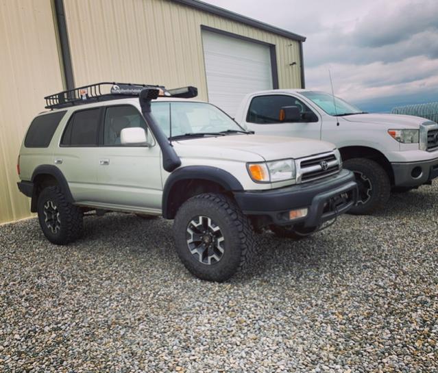

Got it back on all 4 after finishing up the manual hub swap, new wheels bearings, CVs, UBJs, all control arm bushings and new clutch master and slave.
Also got started in my sliders.

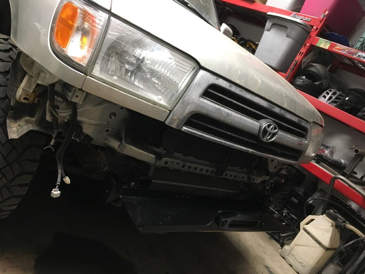

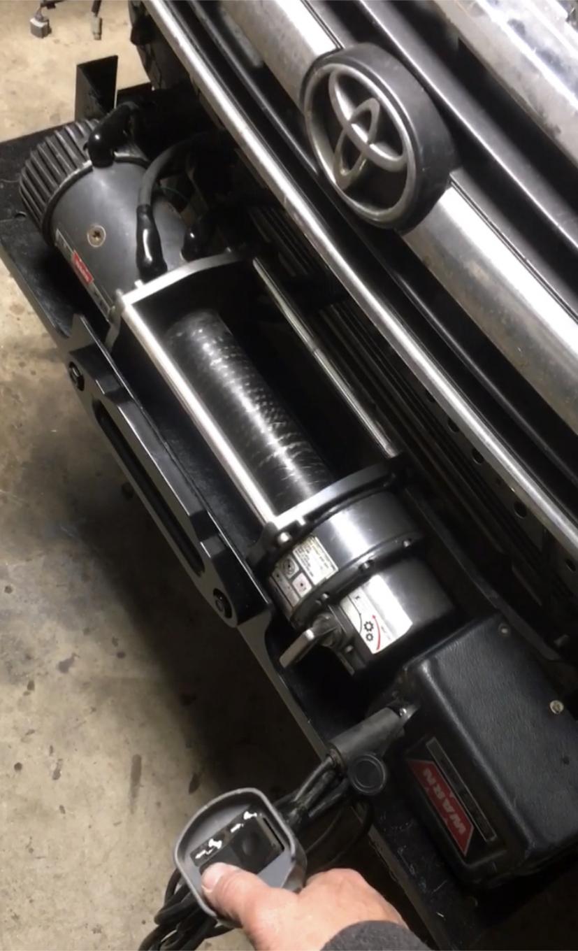

Nice, and looks like you have a hidden winch behind your fat lip bumper...something im trying to do....well just started brainstorming for it. If true tell me more on the hidden winch....how...what ...pics ?
and how much lift are you running....looks good
I’ll have to dig up the invoice for the lift, 5100’s with OME coils ( 881 and 890 perhaps) tires are a 265/75
Hidden winch is just a winch plate with brackets fabbed to mount between the frame rails.
thanks, will prob do something similar, have looked at other peoples ideas too for the 4runner. Good to see more pictures for ideas
the most common mounting plates are 1/5 inch....seems thin

I cut off the stock mounting plate and capped it, then just fabbed brackets to bolt to the frame in several spots. Once you get in there it’s pretty straight forward. I mounted the control box to the side.

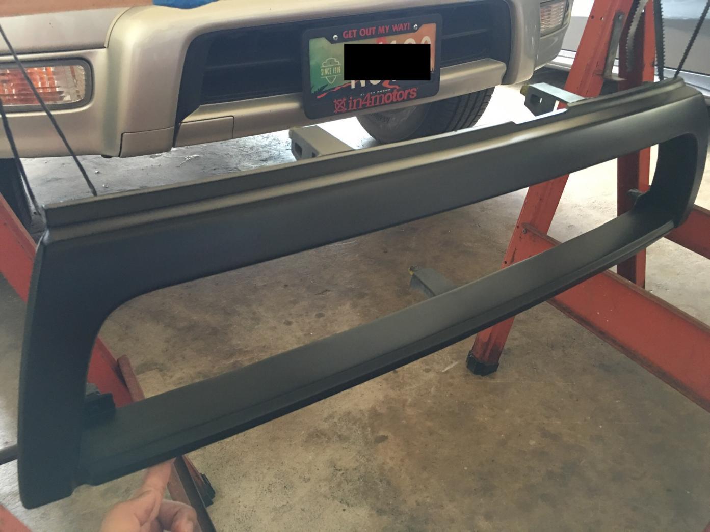

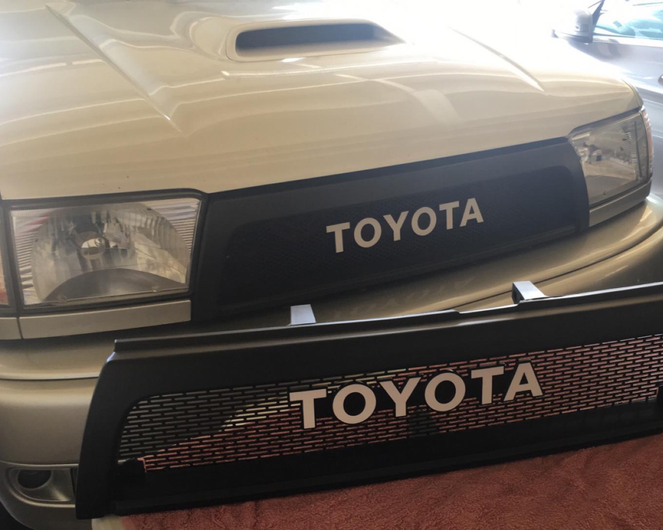

I decided to start the process of making a spare satoshi grille. Gonna be similar to the one I got now but with a slotted mesh and I'm gonna add some raptor lights.
Update: Finally finished, here's the final product! A little time consuming since I wanted it to be perfect, and it was my first time making my own. Worth it, in my opinion, saved a lot of $$$.

Not a big fan of Satoshi grills but, that came out great looking!

Thanks man, yeah wanted to go a different route and make a custom "tacoma trd pro grille" for the 4runner but that looked like a pain, so went with the less time consuming one.
