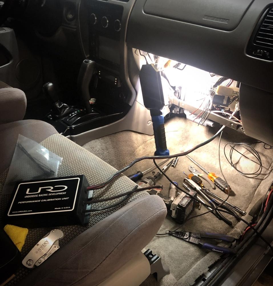

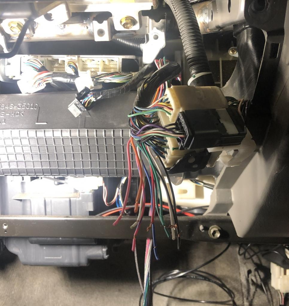

Pics of the URD AIC install... Great instructions. Just sucks to solder in ECU connections.

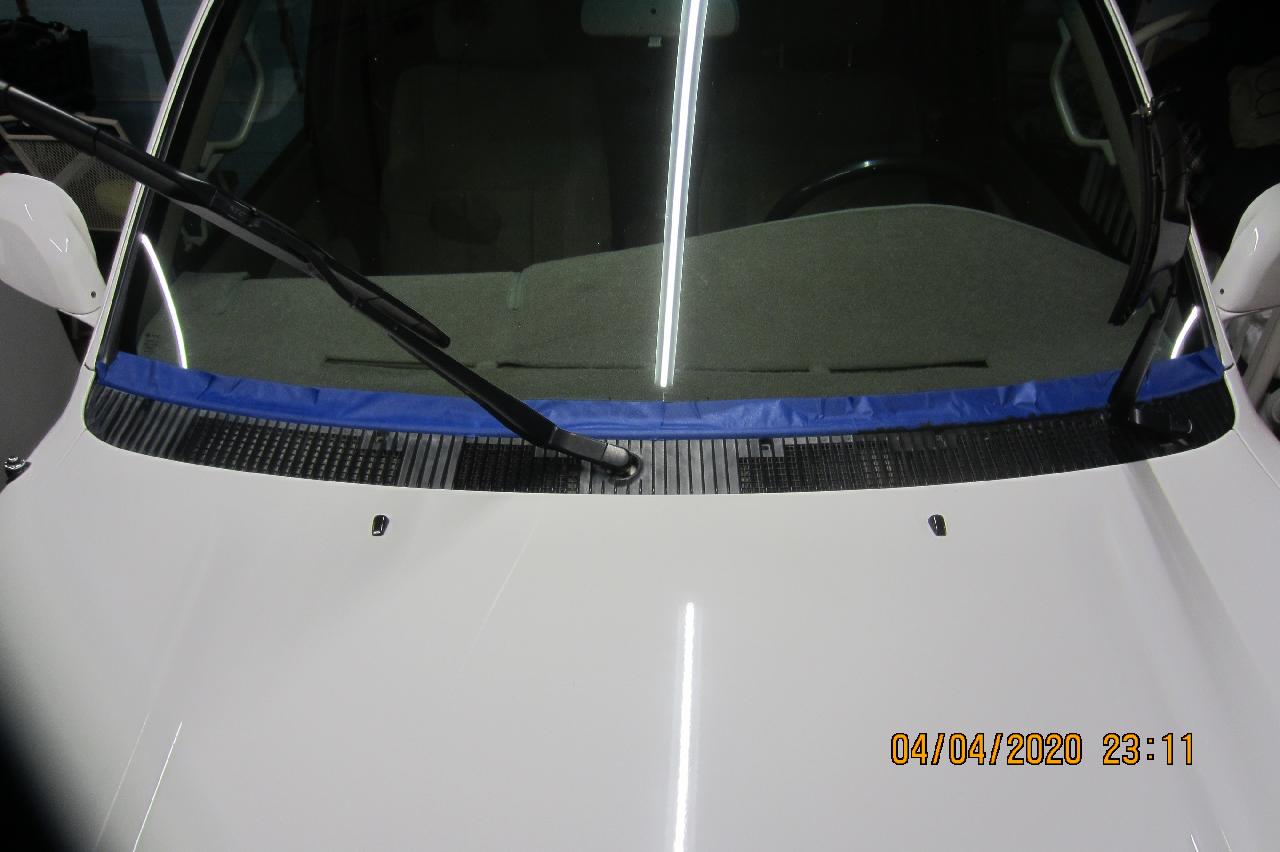

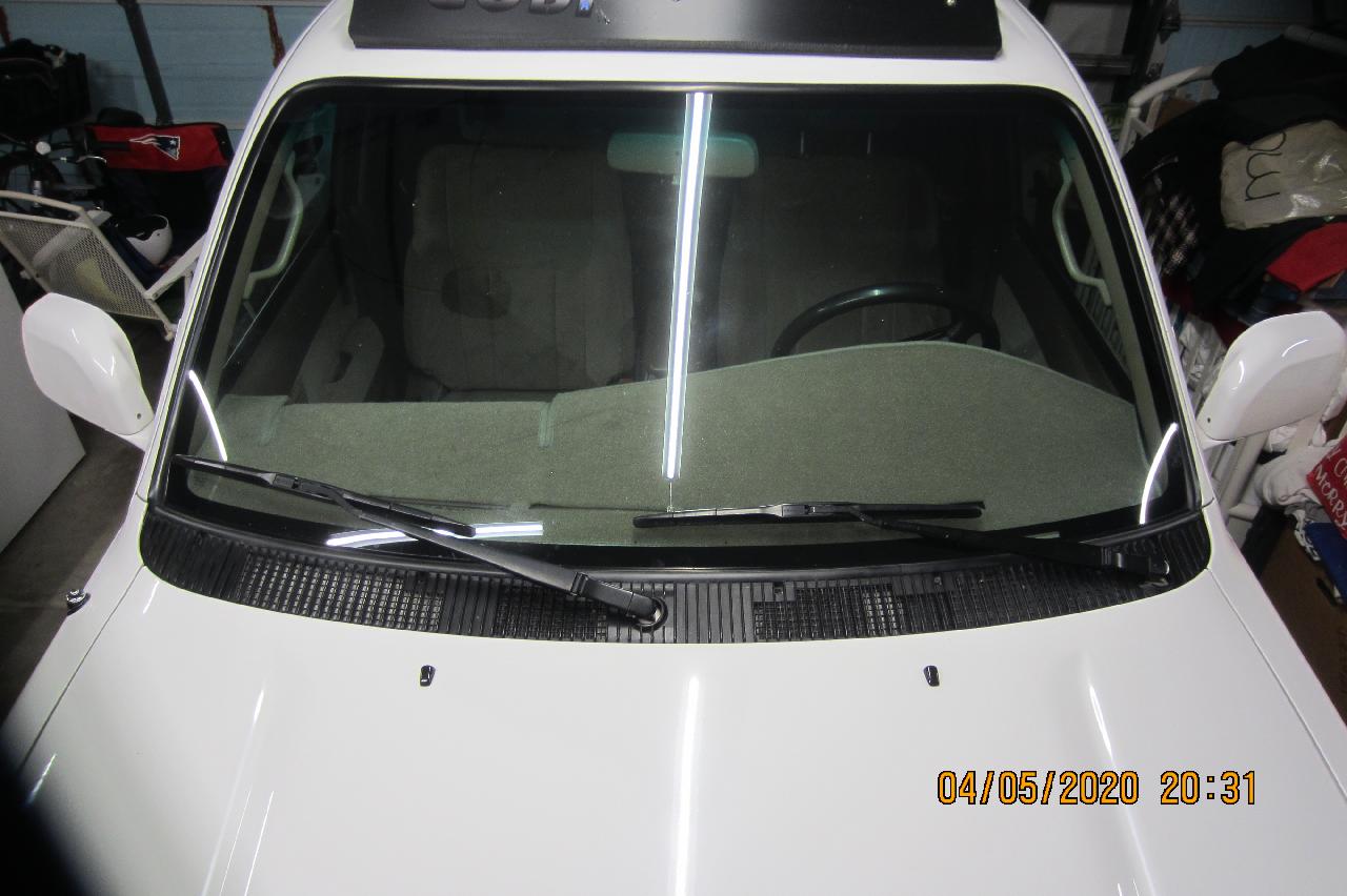

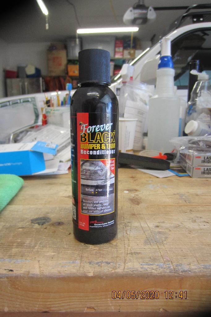

Decided to try the most excellent bumper trim dye on the very tired looking windshield cowling.
Couple tips:
1) If you decide to tape off areas, leave it on until you have applied all coats of dye to get the consistent look.
2) Some areas need > 1 coat.
Came out pretty good and a big improvement over how it looked before applying the dye.
This dye works really well on bumper trim and almost as well on the cowling. The plastics are of a different type to my untrained eye and that may have something to do with it.
The white-like reflection in the last pic is the overhead lights and the cowling color is fairly consistent across all of it.
Eddie

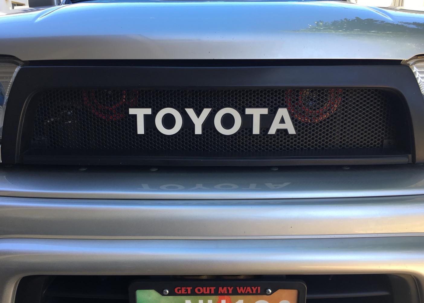

I decided to start the process of making a spare satoshi grille. Gonna be similar to the one I got now but with a slotted mesh and I'm gonna add some raptor lights.
