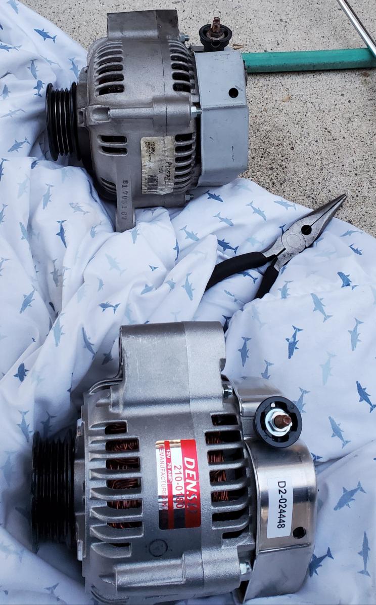

Odd thing happened 2 weeks ago on a road trip, ABS light came on after I shifted out of 4WD then a few minutes later the cruise control turned off when I used the turn signal. No other issues until about 150 miles later with the AC on the tach dropped to zero. Drove it 4 days later for an hour around town and everything was fine. 5 days later(sunday) I drove it 3 places 15 minutes apart and it started fine each time but on the way back it lost power and the speedometer and tach dropped to zero while going 40 mph, would idle but nothing when I stepped on the gas so I pulled over and looked under the hood and it wouldn't restart, dead battery. Strange as I have a ~1.5 year old Interstate. Good thing I had the Genius Boost GB70 still in the car from the camping trip, it fired right up. Then it died after about 4 miles and I jumped it again repeating this 4 times to get home, recharging the battery a bit each time. So the stories about cheap remanufactured alternators are true, the OP had installed a Pro Start 1.5 years and ~3,000 miles ago so it is a POS. I charged the battery sunday night and it read 12.6 Volts Tuesday, when started with lights and AC on the was 10.2 and dropping slowly. I ordered a reman Denso($110 + $34 core) from Rock Sunday night and had it Tuesday afternoon(added $7 to the shipping for 2 day= $14 total) and installed last night. I knew it was going to be hard to get it in the bracket as the old one had to be tapped on with a wooden block and the new one was .003" wider. There is a metal sleeve in the holding bracket that can be pressed outwards to give some space(see socket and bolt pic). Other than that it went in fine, pretty straight forward. There was never any slow cranking, charging light(if it has one) or any other signs of a low battery until it died. I have to say I was skeptical of the battery boosters and did a ton of research before I bought one but this thing started it 6 times from a dead battery, click only, wouldn't come close to turning over, and it was still at 100% charge. Hope I have better luck with this Denso

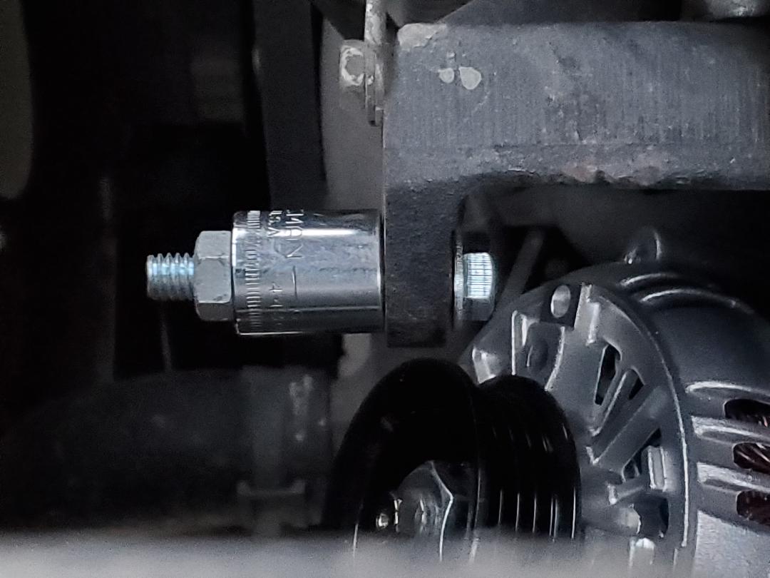

Pushing that sleeve outwards before putting the alternator back in saved me so much time. I remember watching the video from [MENTION=120071]mtbtim[/MENTION] where they struggled to get the alternator back in and thought “there’s got to be a trick that full time mechanics use for that.” Sure enough, this video shows it around the 2:30 mark.

I looked for a video from Timmy but only found one for replacing the brushes. This was my solution(pic), pretty sure I learned from pressing control arm bushings.

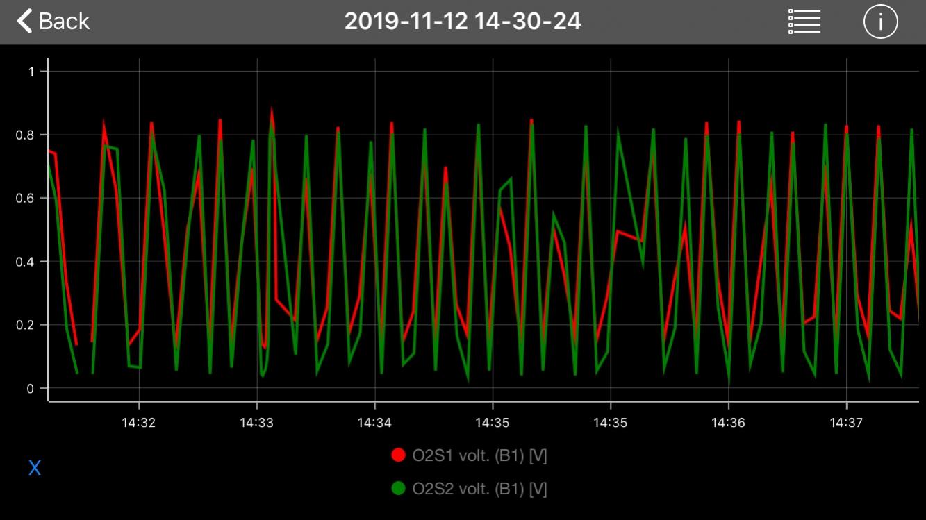

California 1998 T4R auto 4wd. Love the car but I've had it sitting in my driveway for a few years because of health issues. A while back I went to smog it and knowing my luck it failed due to high Nox. Lately I've looked over some diagnostics of the O2 Sensors I've replaced. I've had no CEL's, like ever, but my catalyst efficiency monitor hasn't checked out over 3+ drive cycles. The front and back of the cat is the same temp at any state. O2 Sensor reading before and after new sensors has been the same before and after replacing them. Due to the year of the car I also only have 1 cat. It's going on over 350k Miles, been looking for replacement cat(s). Anyways, I slapped some Faulken Wilkpeak AT3's on, and so far love them on road, looking forward to 4wheelin' in a few months.

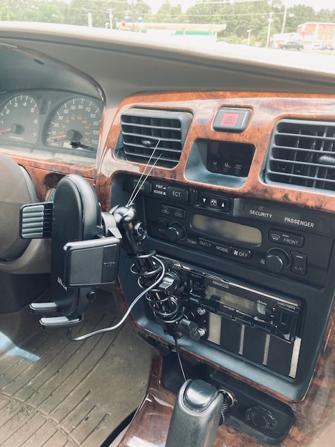

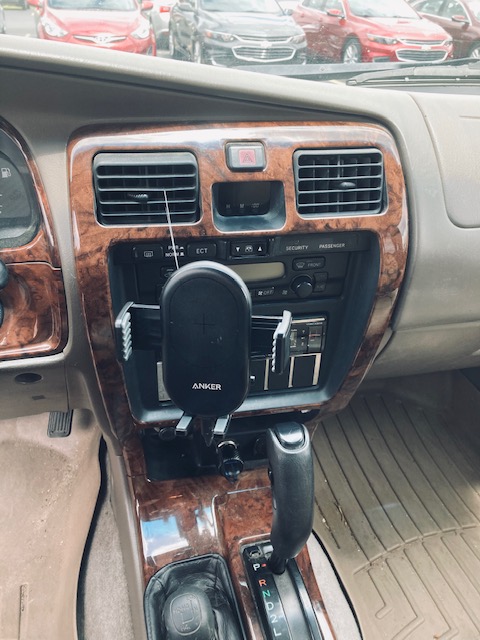

I got a new phone (iPhone SE 2020 128gb) and as usual that led to other new things. I "needed" a new head unit with bluetooth due to no aux port now. Old aftermarket radio didn't have bluetooth. Went with a Kenwood Excelon KMM-X503. Since I had a phone that could now do wireless charging I thought I would try to get a wireless charging phone mount. Bought this din switch plate 1st Gen Tacoma Din Switch plate (6 switch holes)
– Paranoid Fabrications
but got it custom made with only the 3 rocker switch holes on the right. Mounted this ball mount to the blank spot AMPS Pattern to 20mm Aluminum Ball | Tackform then used this arm Enduro Arm 20mm Socket to 20 Socket - 100mm Modular | Tackform and finally used this adapter ball Aluminum Double Ball Shaft - 17mm to 20mm - Tackform to go from 20mm to 17mm ball. That allowed me to mount this wireless charger from Anker Amazon.com: Anker Wireless Charger, PowerWave 7.5 Car Charger with Air Vent Phone Holder, 7.5W for iPhone 11, 11 Pro, 11 Pro Max, 10W for Galaxy S10 S9 S8, Note 10 Note 9 (Quick Charge Car Charger Included): Home Audio & Theater. There is a little bit of shake when you hit bumps but I think I'll be able to live with it.

I’d like to see some photos of your setup. I essentially did the same thing with the Paranoid Fab bracket. I had mine made sans the 2 outer cutouts which were left solid aluminum. I drilled holes for the Ram ball studs as close to the mounting brackets as possible while still allowing room for the Ram mounts to swivel, but still get a little bit of shake.

It's a bit more shake than I would like and most of it seems to be coming from the Paranoid Fabs bracket. The aluminum allows it to flex quite a bit. I could try a shorter arm, but that would put my phone lower than I would like. I'm using a bit of 8lb fishing line to tension the arm towards the vents and that seems to help some. I think a small bungee cord would work better, but I think the best solution would be to find a miniature ratchet strap to allow for best tension adjustment and add a bracket that comes out above the ac controls to attach the strap to.

The leverage of the longer arms make any deflection magnified. I have some 2” angle aluminum (3/16”?) I was going to use to reinforce the back side of the bracket, that way it makes the front corners of the panel rigid and won’t allow it to flex. Had that project on my to do list for a couple years now lol!
Magnified for sure. I've noticed quite a bit of movement in the face of the paranoid fabrications bracket on a vertical plane but also horizontally. Still trying to troubleshoot this some more before giving up.
