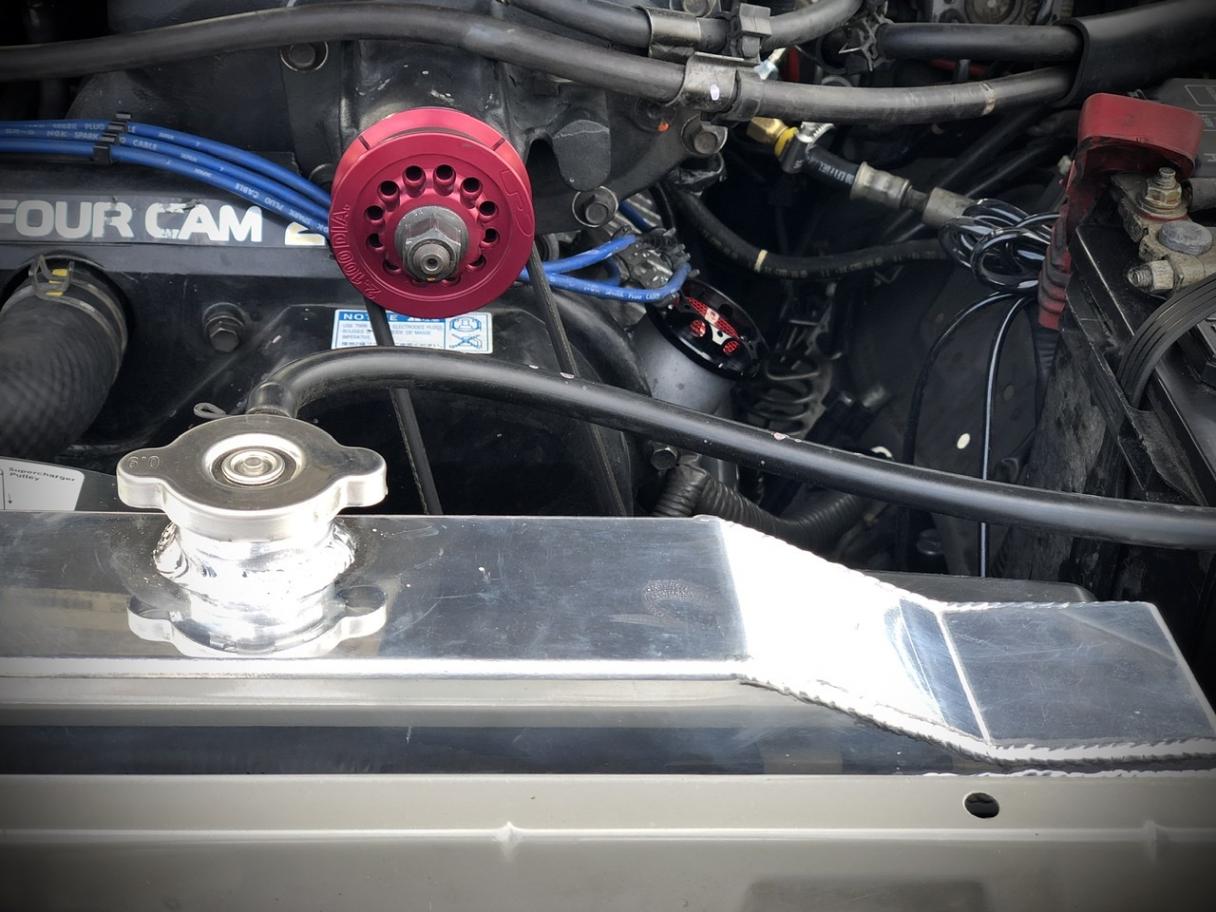

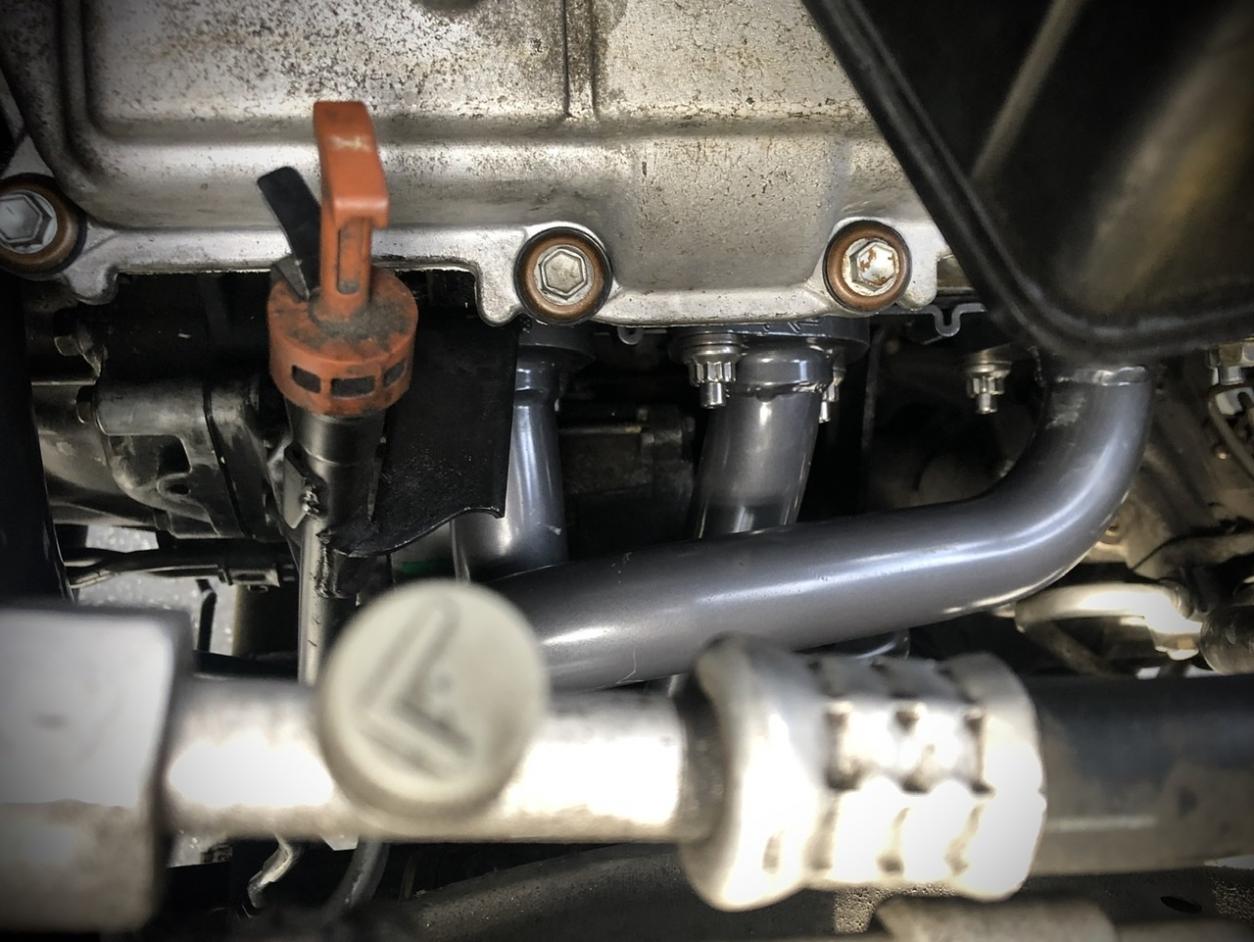

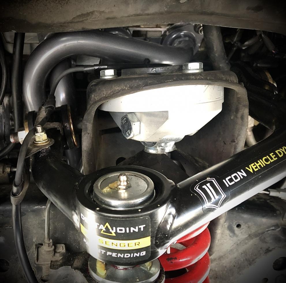

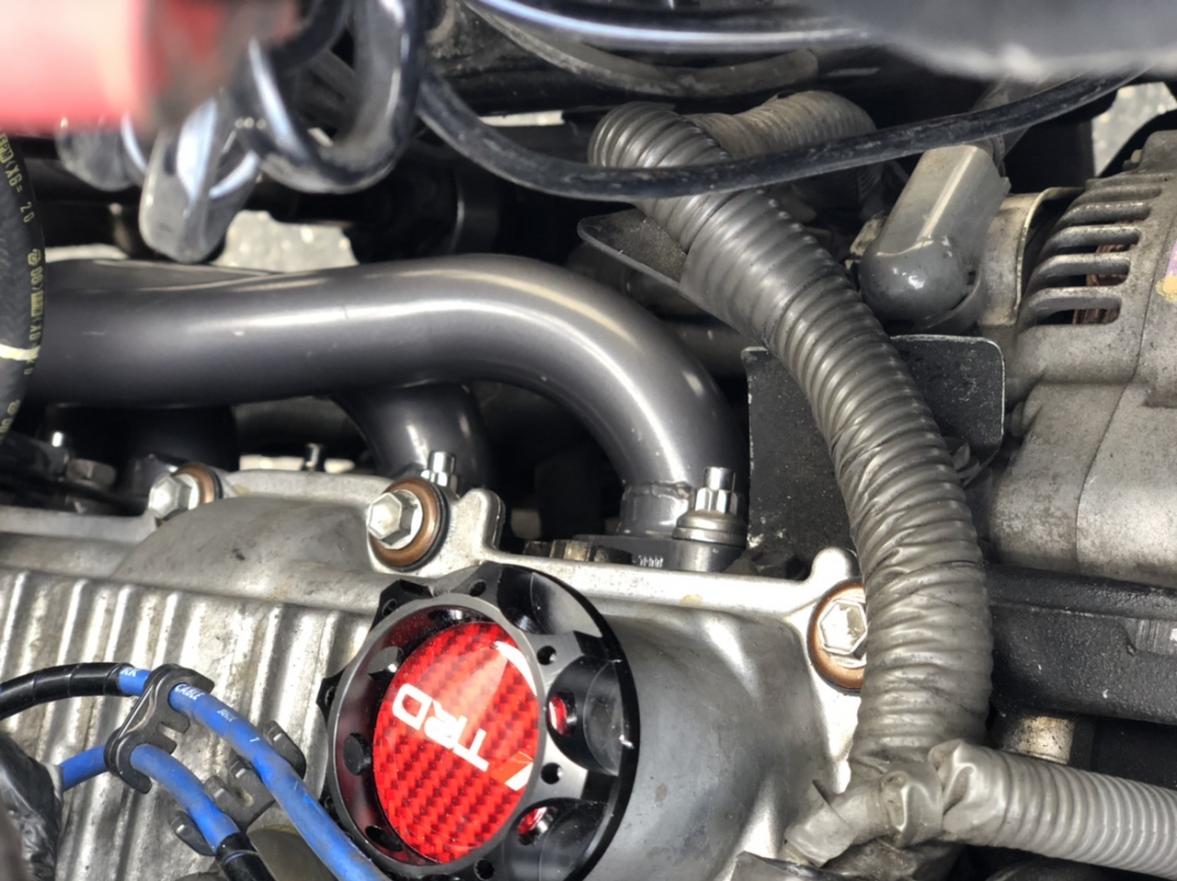

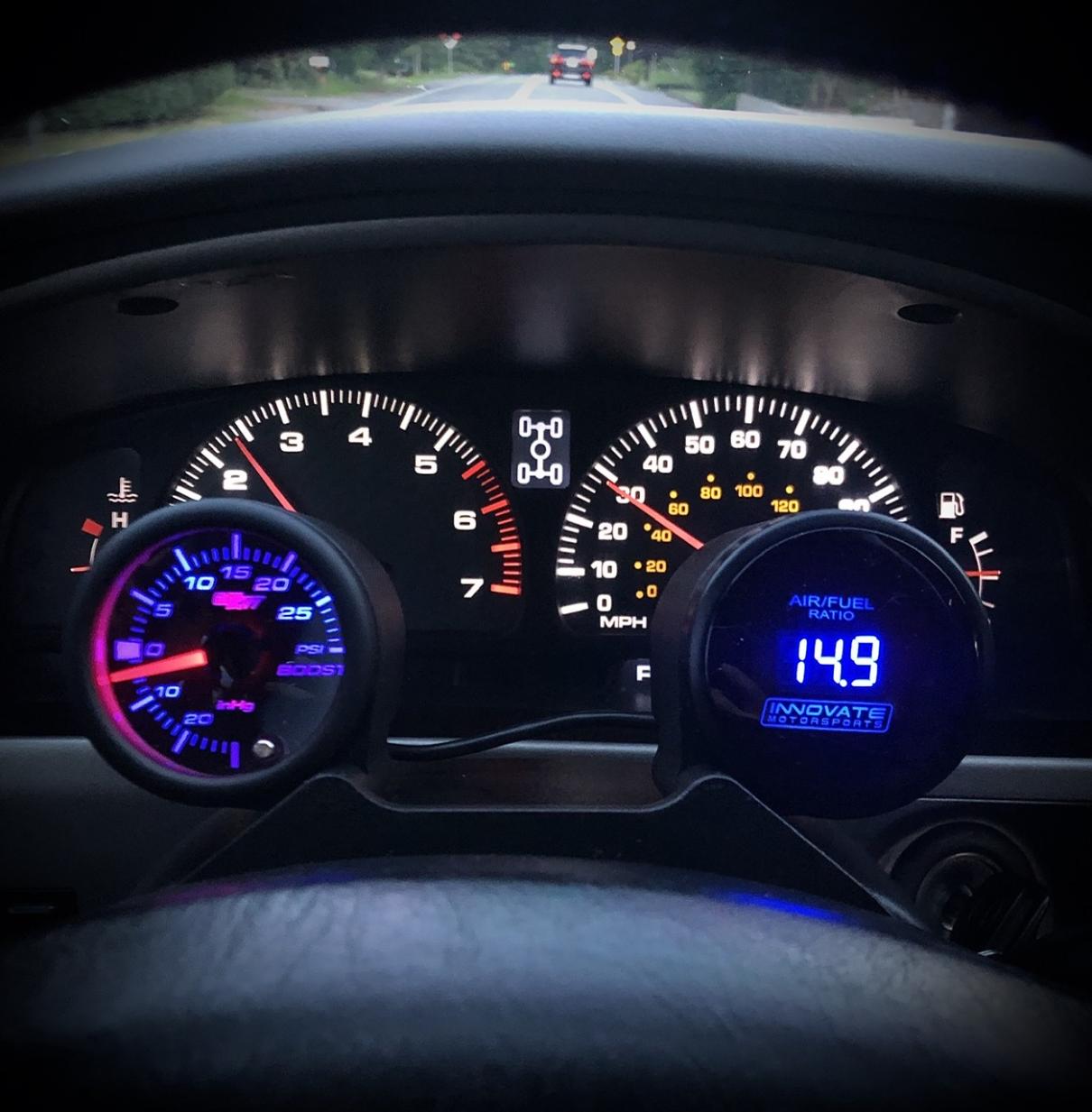

Picked up from Torfab today. Professional. Clean work. Reasonable labor. Had the following installed:
-TRD headers
-Remflex header gaskets
-ARP Exhaust manifold studs
-URD crank pulley
-Champion radiator
-Reseal valve cover
-Icon delta joint UCA
-Innovate wideband
-Boost gauge
