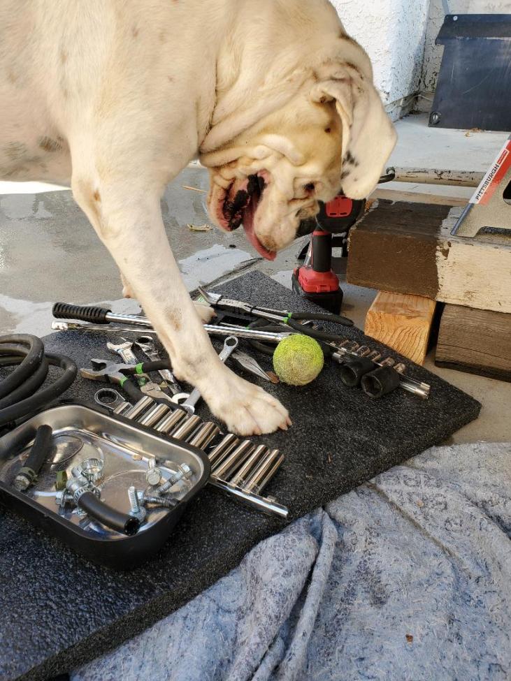

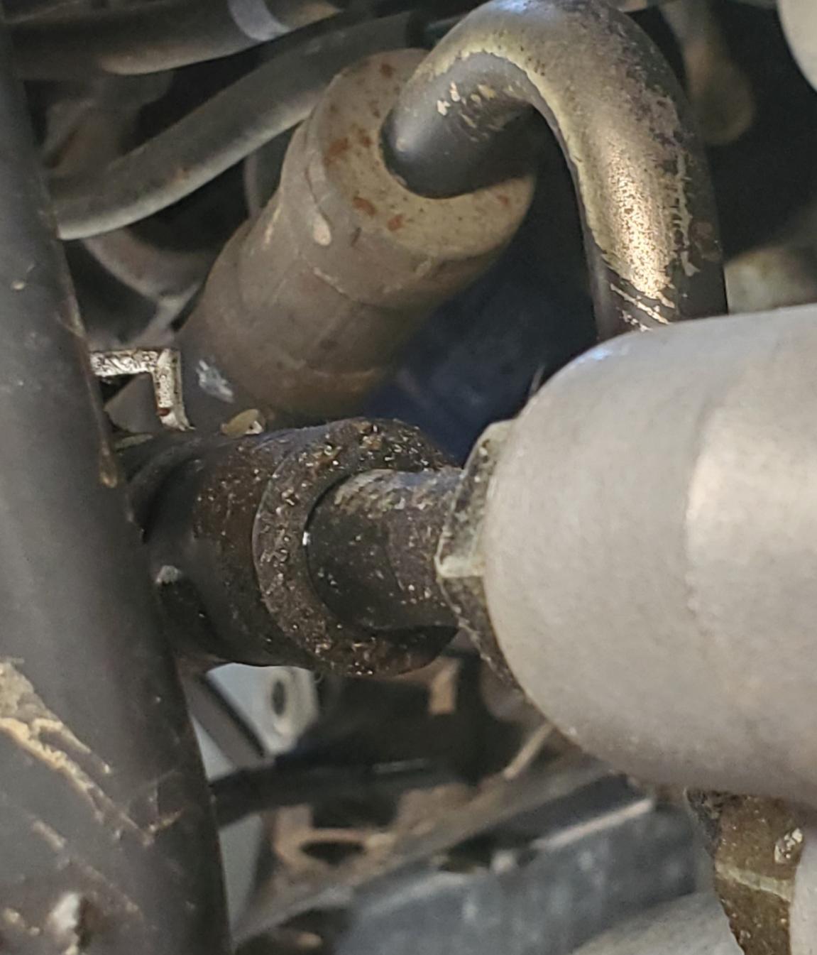

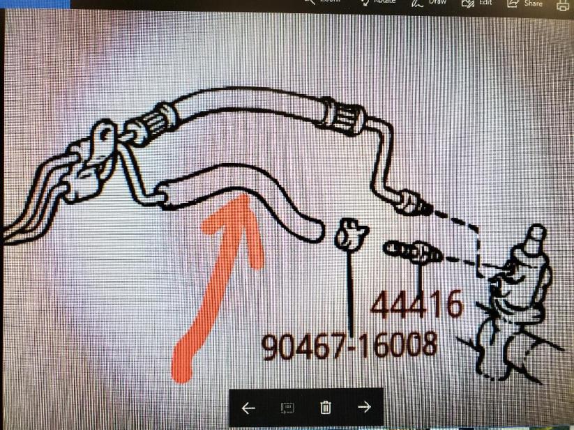

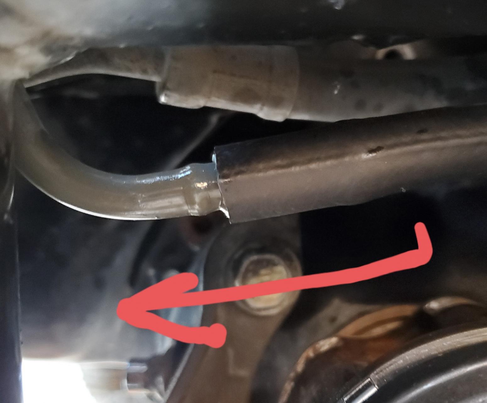

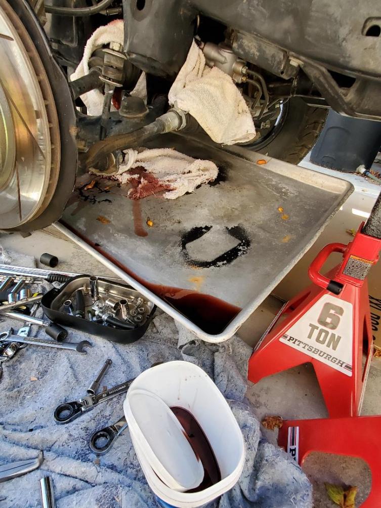

I decided to tackle the leaky power steering return line that has been oiling down my shiny, new OEM steering rack and it turns out it is really hard to get to that line. I pulled the skids, sway bar, splash guard, tire and shock and it is still really hard to get in there. Got a set of the long pliers from Hong Kong Freight, I think it's the 1st time I ever used them. Turns out the hose is 10mm and not 3/8", which is more like 9.5mm. Doesn't sound like a lot but when you can't get access to the part to hold it and push it becomes a lot. Especially when you need to get it done because you are leaving to go camping & 4 wheeling tomorrow. I cut the new hose about 2" longer and slid it over both metal lines enough to get 2 clamps on each side. Undoing the clamps that hold the metal lines to the frame helps. Nobody around had any 10mm line so I had to use 3/8". Had I known I would have ordered the whole metal line with hose line from Rock auto for $20 The dog wasn't much help either. I finished getting the clamps on last night the degreased everything and will reassemble after work tonight.

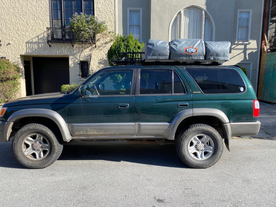

1. Put in rear OME 906 coils to fix sag/tent/drawer weight and leveled out pretty good. Stock up front so im curious what I should do next.
2. Used defender mounts and refit rooftop tent for lower profile and was able to put small basket on front too.

what bracket is that ? Defender..what model I did not know they made them to fit our racks system
also with it dropping down..does that make basket too low for sunroof to tilt ?
Sorry, wrote this fast. It is the smittybilt defender rack mounts. They fit perfectly into the factory track system in our roof.
My basket is actually connected to the rooftop tent base and is extending out. So i cant put too much weight in it but it is slightly high enough to open the sunroof.

Added pictures
