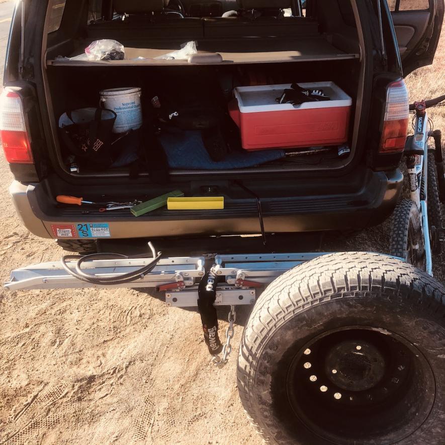

Nothing exiting, but after a bike ride this afternoon I did the rear breather extension mod in the side of the road where the other MTB riders park their brodozers. To make more room I dropped the spare. This entailed confirming that my rig came with all the original jack and gear under the seat and it turned out to have an old, worn, Made in the USA Dunlop spare. Embarrassed to say that I've now owned this 4Runner for almost a year and never dropped the spare. I used the same union and breather that Timmy did in his video but I left the breather end of the 5/16" fuel hose tucked under the protective cover over the filler in the wheel well rather than poking it through the rubber collar at the cap. With my luck I would have found a way to foul it with gasoline. I am doing at least 1 upgrade, update, refresh, or at least cleaning of some area of mine every weekend.

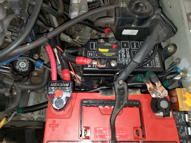

Did the "Big 3" yesterday and, of course, it wasn't easy.
The wiring itself wasn't the problem, it was all of the local parts stores that seem to have been cleaned out of 4 AWG wire and lugs (and most 2 AWG stuff). I had to go to 2 AWG and it was too big to work around the narrow battery area. I wanted to keep the lines as short as possible, which when combined with the Kicker terminals turned out to be a nightmare scenario. FYI: not sure if I got a dud, but the negative clamp (which is the same as the positive but with a shim) would not hold onto the post. Half of my time at the shop was spent fighting it and then required me to make a run to get a normal terminal (and more lugs) to get me back home!
Needless to say, I'll be putting in a order for 4 AWG stuff on Amazon today, including new terminals, because I want this to be cleaner than what I ended up with last night.
Not sure if this is any gauge, but my OBDII bluetooth scanner picked up a consistent 13.1-13.2v (measured at the connection) the whole trip home. It usually is bouncing between 12.3-13.0v, so I'm pretty sure I did something right, lol.
